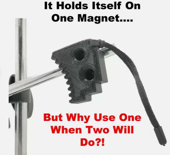

      Can someone explain the function of the magnets which are supplied as an option extra with the 3D printed back gear locks available for the 60T Myford S7 lathe as seen on ebay. The attachment is designed to be supported by the headstock casing but I cannot see the role played by the pair magnets.
      #747143
        Presumably this one?https://www.ebay.co.uk/itm/315011671504
        The blurb on the left includes this:
        s7magnets
        So, just a feature allowing the lock to be stuck to any nearby steel for storage.   The following page describes the strap hole top-right, making it clear you have to provide your own strap!

              I wondered if it might be possible to modify one to function as a detent for indexing applications.
              #747181
              Hopper
                @hopper
                Why would you stick it to your dial indicator stand as shown in the pic???
                Greensands: I would think a conventional single point detent plunger would be more reliable and easier to use than a multi-tooth jobbie like this one?.
                #747192
                  On Hopper Said:
                  … I would think a conventional single point detent plunger would be more reliable and easier to use than a multi-tooth jobbie like this one?.
                  My guess is it’s designed to reduce the chance of breaking a tooth off the bull wheel whilst attempting to remove a stuck chuck.

                    On Kiwi Bloke Said:
                    …or are they to ‘stick’ the plastic block to the bull gear?
                    Why would you want to do that?
                    The teeth in the plastic part engage with the teeth on the bull gear. When the item is used in that manner, there is only air where the magnets are (nothing to stick them to).

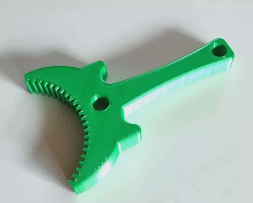

                          #747278
                            This version of the tool eliminates magnet angst by not having any!
                            mylock
                            Nothing complicated going on.  The magnets allow the tool to be stuck to a splashback or other metal surface when not in use.
                            #747279
                            Bazyle
                              @bazyle
                              The one on Thingiverse has a picture showing one in magnet assisted storage……
                              https://www.thingiverse.com/thing:5194375
                              #747975
                              old mart
                                @oldmart
