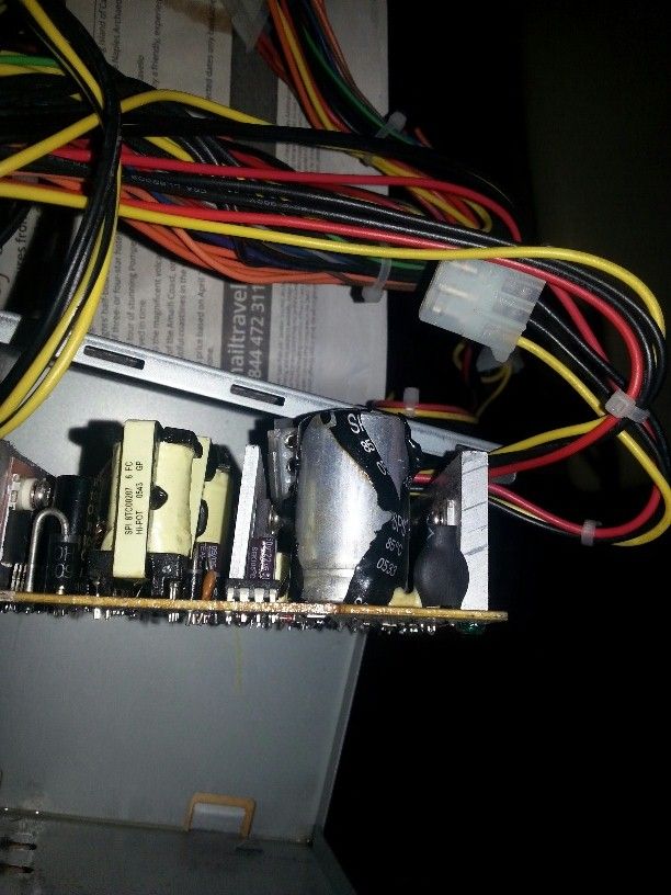

        Hi
        The magic smoke has escaped from my CNC PC. It looks like it's the 400 volt input capacitor that holds the circa 300 volts DC before it gets chopped up into the 5 and 12 volts.
        What are the chances it is just the cap has gone? The PC will be around the 10 year old mark. The HDD is on a parallel bus and not SATA. I would like to keep it because it runs Mach3 and don't want issues trying to run it on later OS's.

            #170369
            Michael Horner
              @michaelhorner54327
              This is the cap that's gone. I have some old psu's but they seem to use 2 caps in series at 200v each. I have found one on ebay so will order one up. I will check the bridge rectifier to make sure that it hasn't gone short because that would have put AC across the cap which I don't think it would like. Thanks for your input guys.
              Cheers Michael,

                    #170383
                    Michael Horner
                      @michaelhorner54327
                      I have removed the cap and when I put a meter across the holes it was low ohms and a diode looks like it's the same. To buy a cap it's about £5 so I have just bought a second hand psu for £7!
                      Neil.I know what you mean about electrolitics. I put a low voltage one in a higher voltage circuit. It nearly took my finger off. Lots of confetti though.crook
                      Cheers Michael
                      #170384
                      john swift 1
                        @johnswift1
                        Hi Michael
                        If you replace the capacitor ( approx. 470 uF 200V )
                        change the identical one next to it
                        the two capacitors are wired in series to make a 235 uF 400 V capacitor

                          #170489
                          Muzzer
                            @muzzer
                            One reason for using 2 x 200V caps in series was to be able to use the input rectifier in voltage doubling mode for 120V input, giving a 340Vdc bus. Those PSUs would typically have a 120/240 voltage selector switch on the side.
                            Modern PSUs tend to have a power factor corrector (PFC) which boosts the input voltage up to around 380-400Vdc regardless of the mains voltage. That's not a problem for electrolytics in itself.
                            Generally, when a bus cap goes, there will be several other key components taken out with it, like the inrush current limiter and the diode bridge – and the internal fuse. Your second hand PSU is definitely the way to go. Even a new one would cost very little and they seem to be very backwards compatible.
                            With time, the electrolytics dry out and this is often the cause for the PSU failing. As they dry out, their resistance goes up so they get hotter still and the ripple voltage increases. The cans are designed to vent in the case of an internal short.
                            If you replace the failed caps, you may find it fails again fairly soon due to the other caps having dried out. They were probably all designed(?) with a similar lifetime. Yes, I've been designing switched mode PSUs for some years now….
