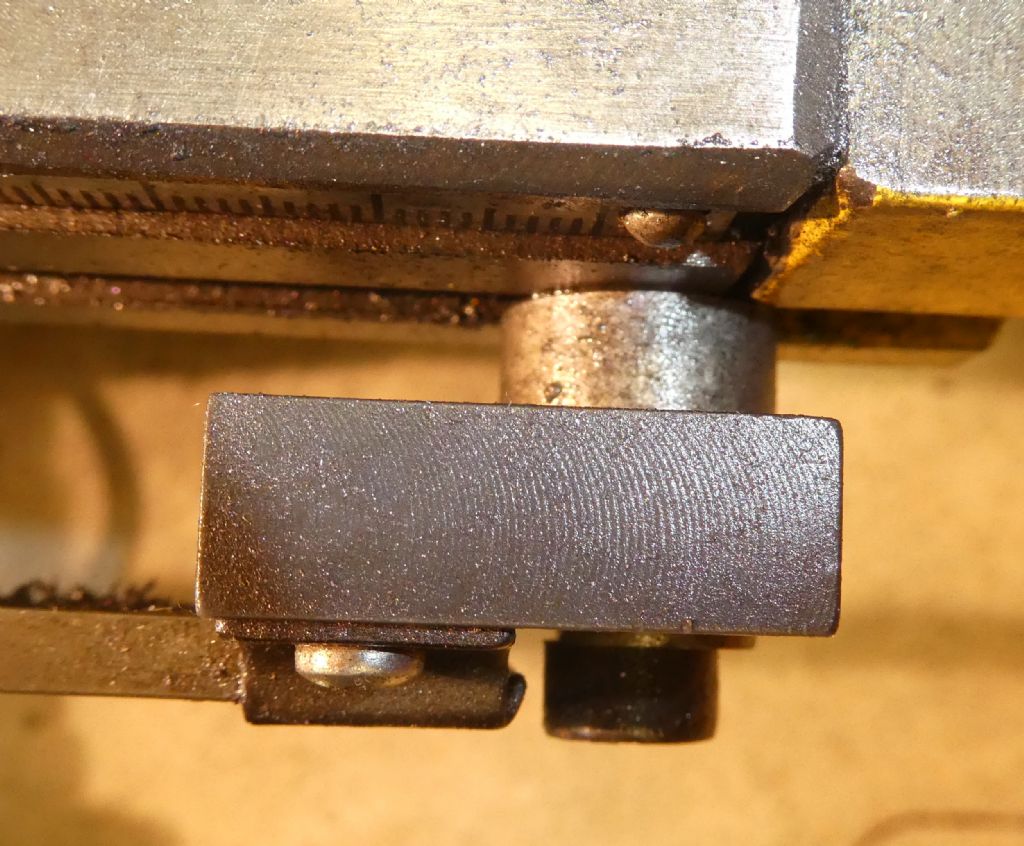

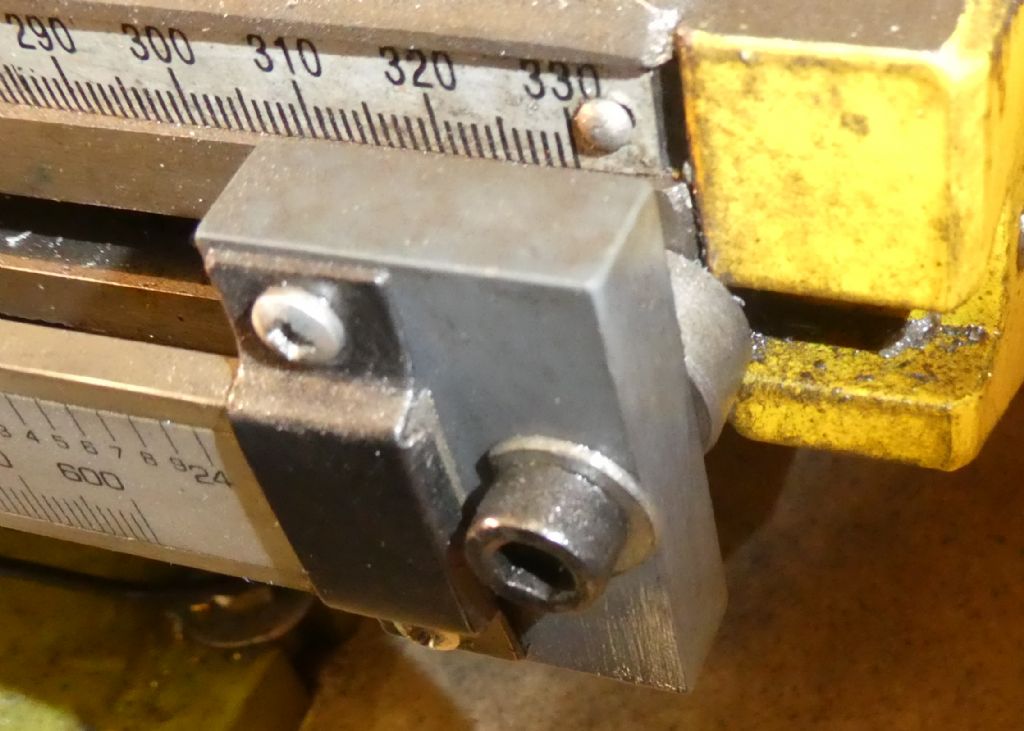

      In the (slow) process of installing mag dro scales on a D-W mill. I'm using aluminium angle for mounting and have modified some m6 screws to hold the scales to the angle pieces. The screws are in counterbored 'pockets' in the scale strip holders and, thus, the mag tape passes directly across the screw heads. Is this likely to affect the scale readability and should I source some brass or other non-magnetic screws?

                  Jim Nic – of course, you're right but it's the proximity of the screw heads to the tape ( thous " ) which I saw as a possible problem.

                    I used 2ba steel countersunk screws to attach the extruded aluminium mDRO scale holders to my D-W. These screws are directly beneath the self adhesive scale strips. I went through a careful calibration process, and I saw no problems due to the screws. There were small linear errors on both axes, but these could be adjusted out in the system software. As you have found, the large clunky brackets supplied with the kit are useless for use with the D-W, which was why I made my own. As well as using slotted holes in the brackets I used jacking grub screws so that I could finely adjust the read head positions in 3 dimensions. The read heads and the scales are electrically in direct contact with the mill, which is well earthed, and I have had no problems with erratic readings.
