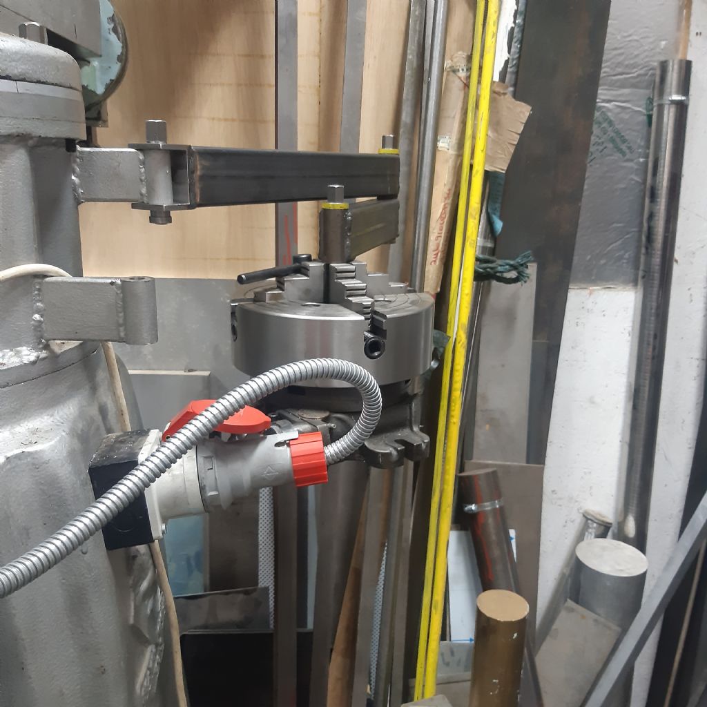

      Some years ago I made a 7.5" raising block for the milling machine so I could get the 20" of headroom to rough machine the ram ways on my shaper.
      The raising block has become a permanent feature of the mill, since the original spec allowed a the quill to be flush with the table when both were at their highest position (stupid!).
      At the time, I added some lugs so that I could mount backets onto the side of it, just in case that would be useful.

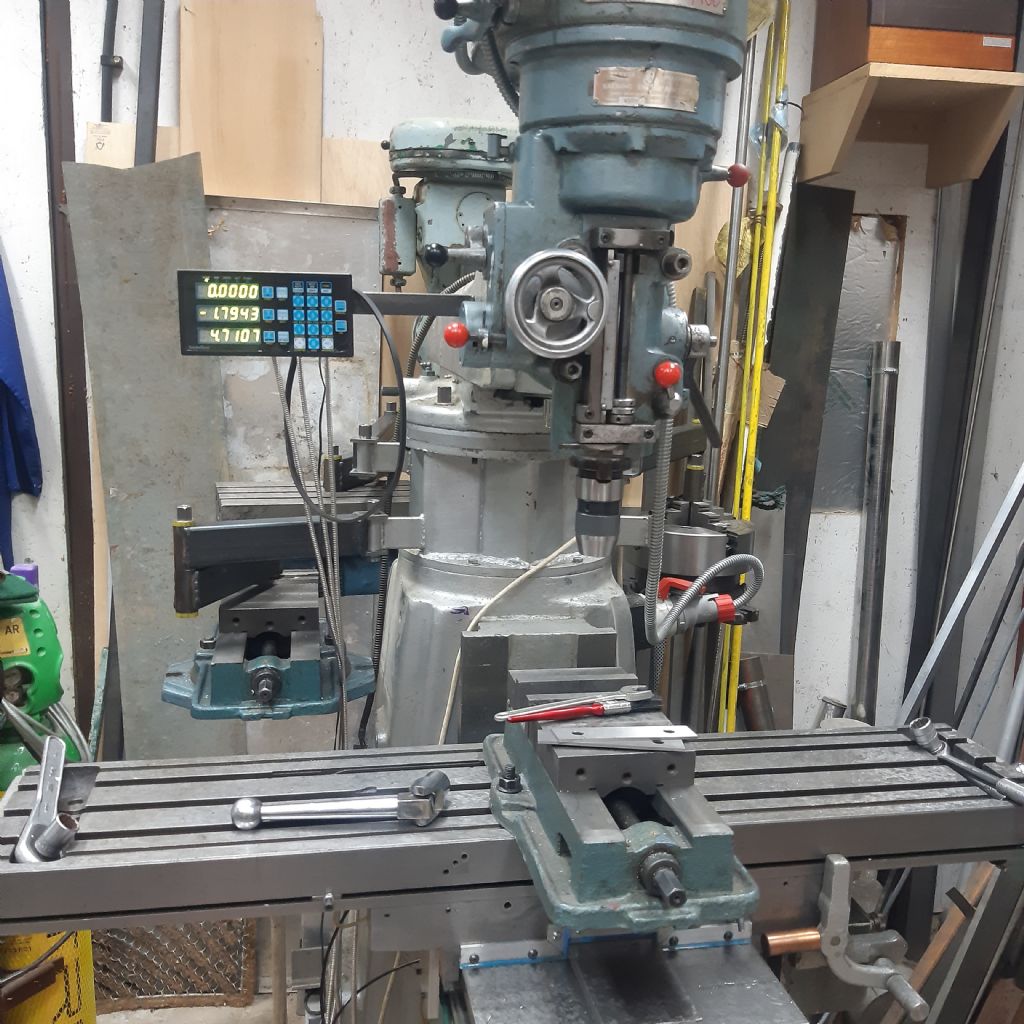

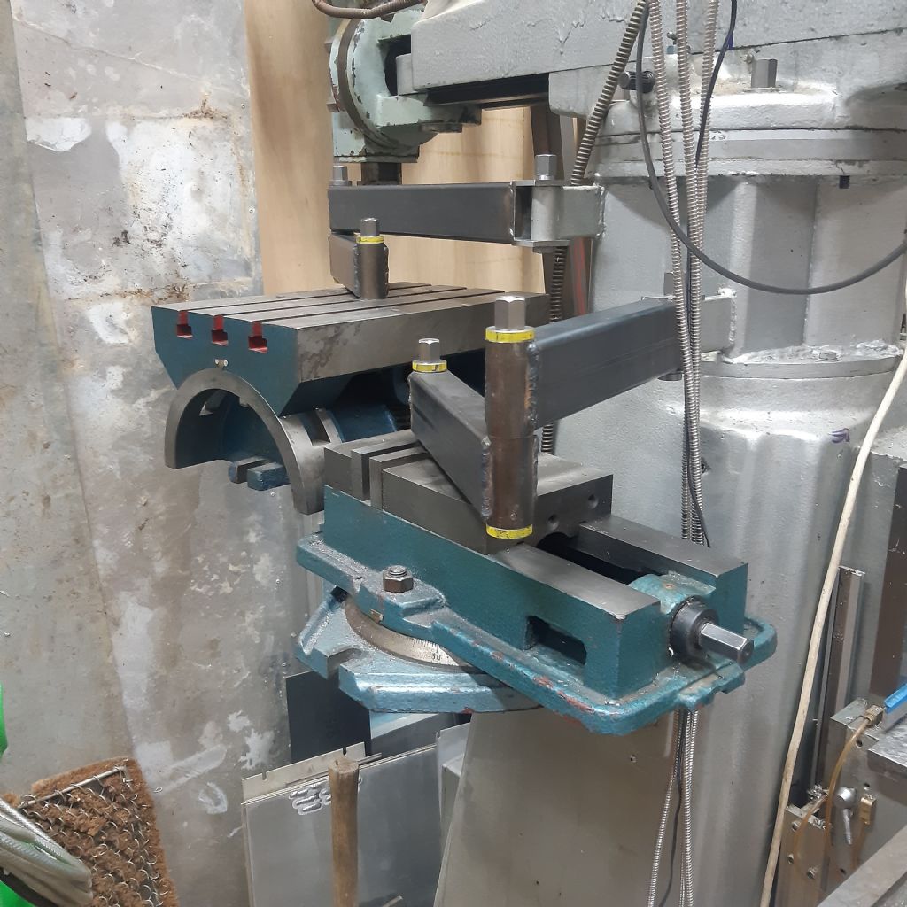

      I've spent the last few weeks welding and machining some brackets to allow me to hang the rotary table and its chuck, the large angle block and the vices on it. This has freed up space on the bench and floor and makes it far easier to mount them on the mill table:- Just loosen the clamps, move them over the table and raise the table under them.
      Second vice and angle block.
      Rotary table.
      Need to re-site the mains plug to alow for a bracket for the first vice.
      Overall view.
      A few tweaks are still needed, but I'm happy so far.

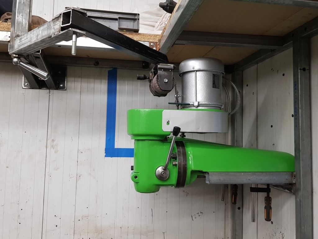

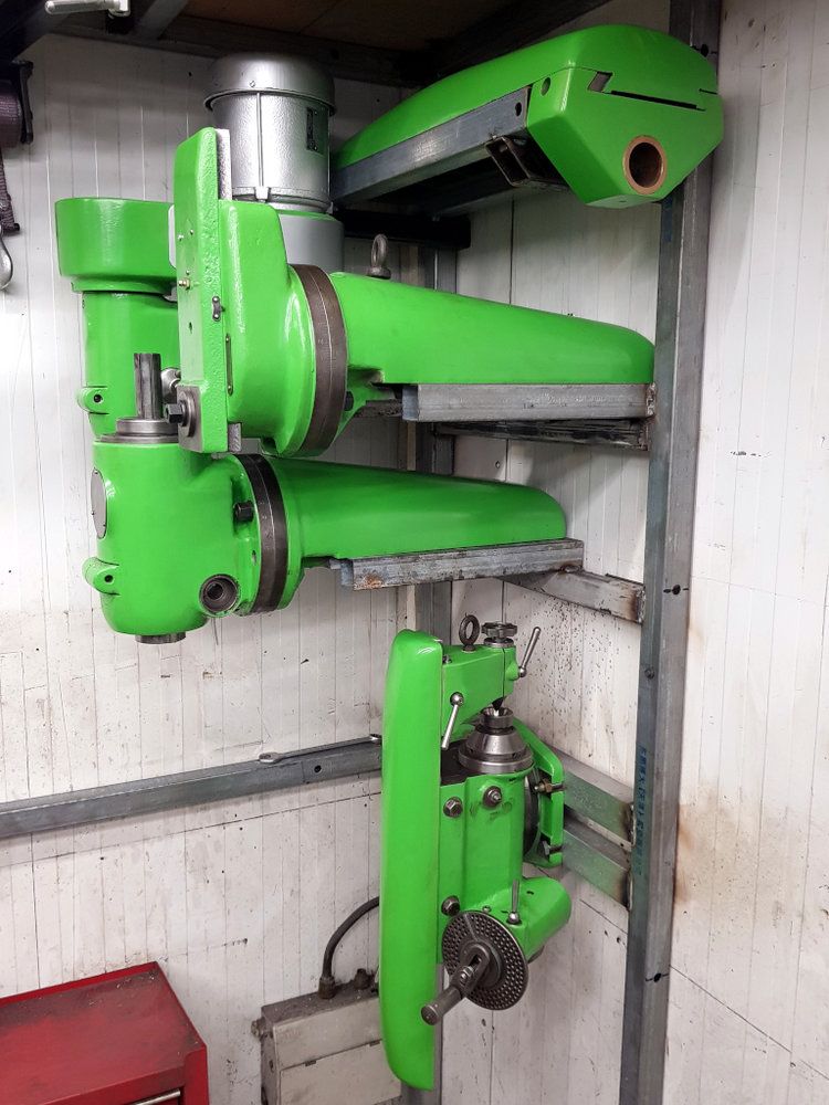

            I have done something similar for the TOS mill I am rebuilding. It has swappable tables and work heads which are all 30-50KG so I have mounted them all on a wall rack and I've made a small swing crane to load them on and off the machine when it's done.

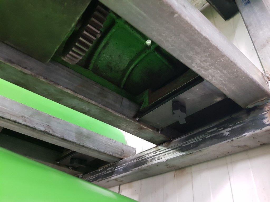

                Pete – the top three just look like they are held up by magic. I guess I am missing some obvious bracket at their outer end.
                Mark – just keep an eye out for long term vibration loosening a supposedly tight grip.

                  Bazyle yes they are all nose-heavy. I have them retained with a thumbscrew from below.

                    Posted by Bazyle on 11/09/2022 16:11:15:
                    If there was a larger diameter section (thick washer) at the bottom of the circular pin holding the RT, it would locate under the chuck jaws and provide some extra confidence.
                    Similarly, a stepped piece that hooks under the vice jaws would stop it falling unless there is large movement of the jaws.

                      Oddly enough. There are. The bits of the pins that go between the vice jaws also have flats machined on them. laugh
                      When the nuts on the top of the pins are nipped up, the grip is very good.
