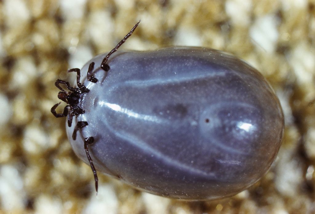

with an extension range between 50mm and 126mm, the bellows can take over from a typical set of extension tubes of say 12mm, 20mm, and 36mm that would only stack to 68mm, or 80mm as with your set Raphael. I have no doubt that both tubes and bellows could be stacked for even greater extension. Others here could perhaps comment upon the limitations, e.g. depth of field, etc.

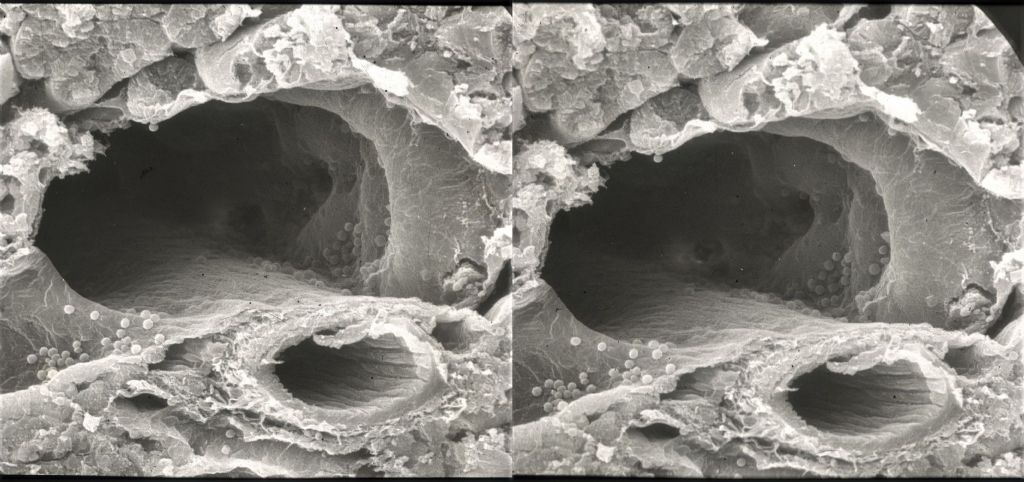

Here are a couple of earlier images taken with my Canon EOS 300D camera, through the Novoflex bellows and a Canon EF 100mm f/2.8 Macro USM.
As with a variety of stuff accumulated over the years, I have to admit that the bellows is seldom in use these days.
Having ventured into stereo pairs, I intend to find a subject which will feature both the bellows and macro lens while providing a bit more 'fun' for us who are cross-eye 'gifted'.
