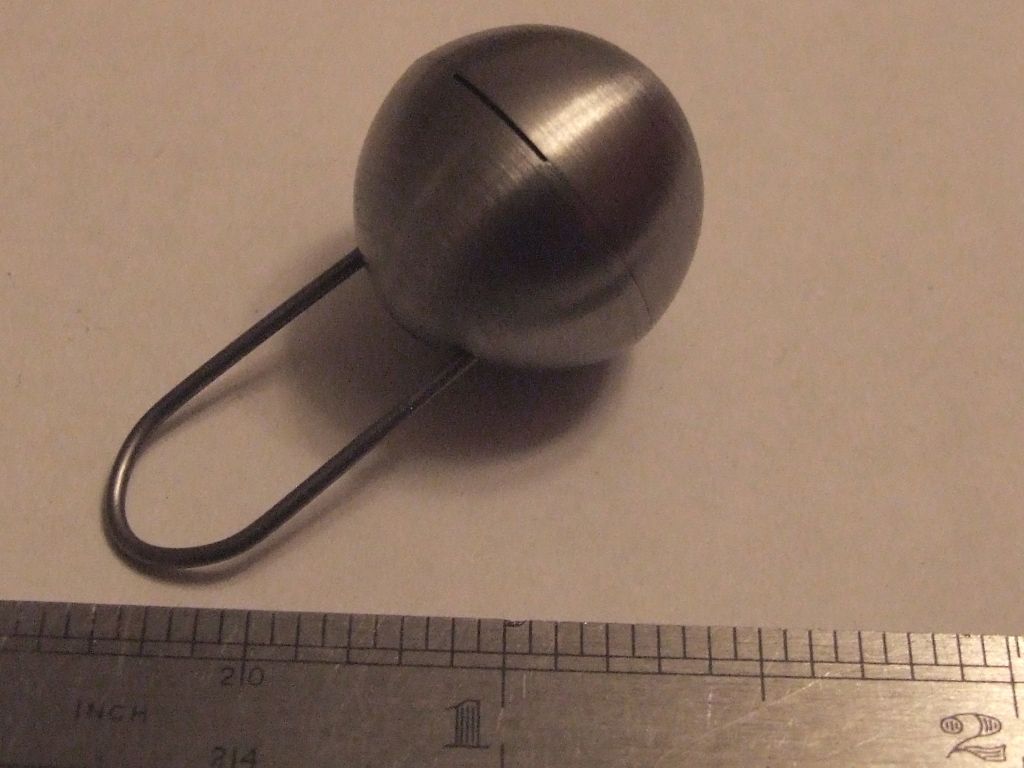

          Anonymous
            The box hedge in the front garden has now had a haircut. Unfortunately the electric cable for the hedge trimmer is now shorter than it was. embarrassed
            I've been beavering away in the workshop this afternoon making a practice governor ball in tungsten. I still haven't sorted the tapping issue, but everything else was straightforward:
            The ball weighs 55gms versus the theoretical weight of 65gms. Obviously there are internal voids for the screw threads and the screws themselves are not tungsten. And my kitchen scales only resolve 5gms. All in all not a bad result.

                Anonymous
                  Hmmm, this is going to be embarrassing. embarrassed
                  Out of idle curiosity this afternoon I drilled a couple more 3.6mm holes, about 50% thread engagement for M4, in my remaining bar and tried tapping with an old set of Dormer HSS straight flute hand taps. Worked just fine! I used all three taps in sequence, and cutting fluid definitely helped. For one hole I used Rocol RTD and the other Ferrofluid, a thin oil intended for tapping tough materials like stainless steel. It's difficult to know which was best, but the oil is less messy. The taps needed noticably more torque than normal materials, but no worse than austenitic stainless steels. So much for the fancy sooper dooper taps. Sometimes you just have to reverse up and try a different path rather than press on regardless with ever more involved, and expensive, 'solutions'.
                  The next question is do I stick with M4 or change to M3; the original design specified 6BA? Ultimately it'll depend on the leaf spring design. But I'm inclined to stick with M4 as during manufacture the thread takes all the cutting torque generated when using the hydraulic copy unit to form the hemispheres.
                  I'm going to treat myself to a beer tonight. beer
                  Andrew

                    You might think about generating your sphere, using a cheap & cheerful carbide tipped hole saw from that well known internet auction site. It should put less load on your holding thread, perhaps?
                    Cheers, Tim
                    #315292
                    Anonymous
                      Thanks, the balls are actually two hemispheres screwed together so that the leaf spring can be held between them. Would that make a difference to the idea of using a hole saw?
                      Andrew
