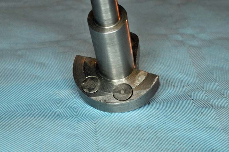

            Great idea, but the half balls fit on each side of a thin leaf spring. It's a very long time since I played with a spark eroder, so I'm not sure how they would cope with a slot 5/16" wide but possibly only a few thou deep.

              Andrew would it be worth turning up a temporary sleeve to slip over the rod while you tap it to resist the materials want to burst. Or even slip your turned end into a collet. Another option would be to dril larger and silver solder in a bronze insert that could then be threaded.
              As for the EDM you could do a "top hat" shaped cut to slice the ball in half and the spring recess in one pass so would not be cutting a few thou off an edge

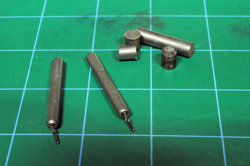

                          I got some Tungsten heavy alloy from the surplus market (either Whiston or Crew) many years ago. I needed to try to improve the balance of this over square crankshaft.
                          The weights are rivetted into countersunk holes.
                          I've been looking for an easy source of this stuff ever since. This is what I've got left, together with some tungsten fishing weights that I bought from ebay.
                          The 1/4" diameter alloy bar has a density of 14.8 which suggests it's about 60% W (assuming the rest is Fe or similar density metal). The weights have a density of c.19 which suggests pretty much pure W, which is disappointing from a machining point of view (but good for ignition points!).
                          Andrew, I'll pop one of the little slugs in the post and you can play with the machinability, it certainly cut and rivetted with no problems, much like mild steel. The 80/20 copper alloy from China looks like it might be a good choice.

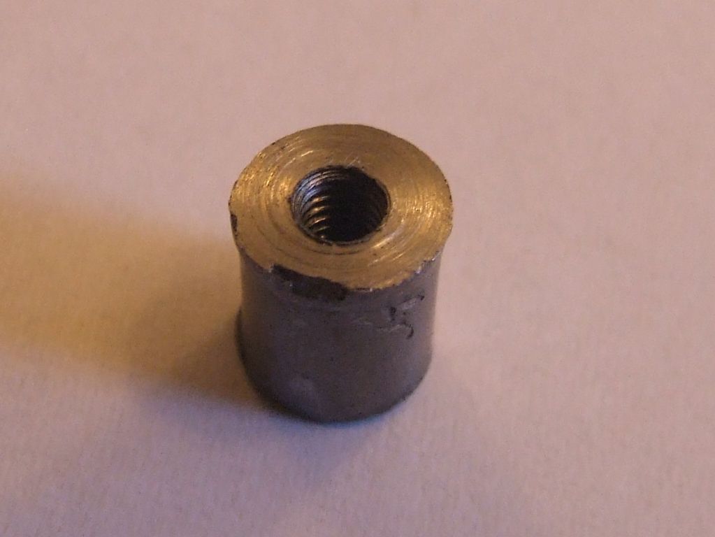

                                I've had a go at machining the sample kindly provided by Rod. I went carefully, and the tapping was a bit bottom clenching, but I managed to drill and tap M3 without breaking anything:
                                So whatever it is, it isn't pure tungsten. The drills and tap were all HSS.

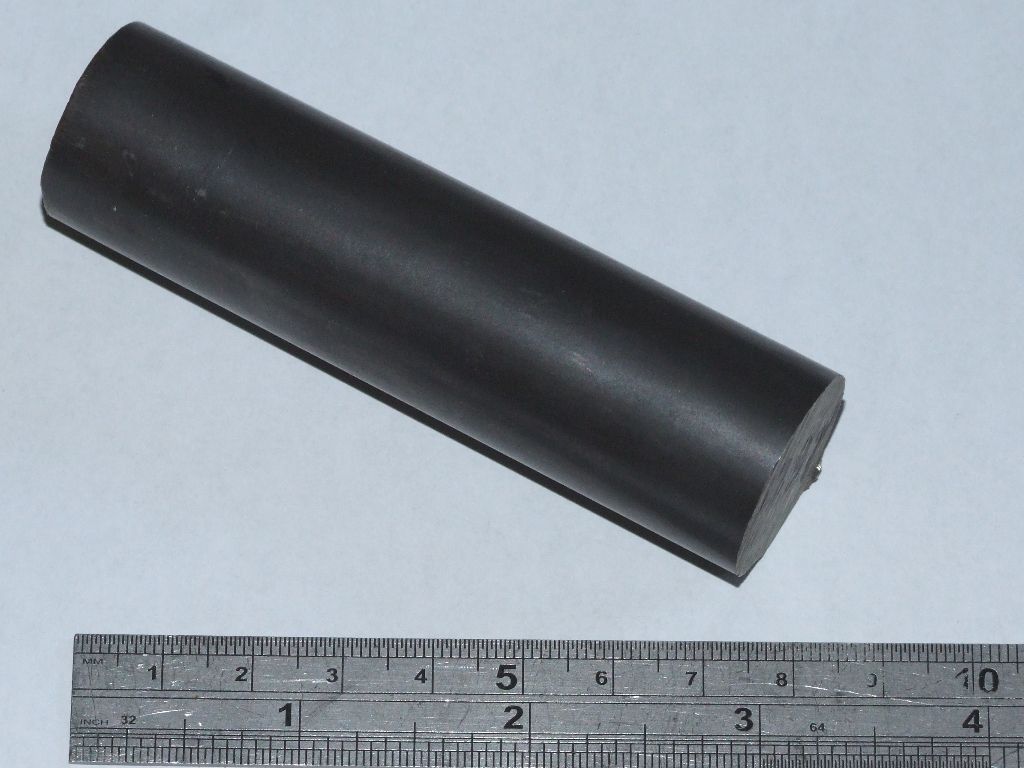

                                            My tungsten alloy bar arrived last Thursday:

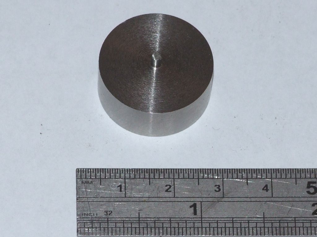

                                            I've had a go at machining it this evening. It machines very well, no issues with facing and turning. The finish looks a little rough, but I was using a 0.2mm radius insert at 0.1mm/rev. So no doubt I could improve on the finish:
                                            I measured the surface roughness at six points around the circumference; the average was 2.09µm Ra. Surprisingly that's comparable to what I achieve on other metals so not bad.
                                            Sadly drilling and tapping proved to be more problematic. I managed to get a M6 tapped hole produced, but it wasn't easy. Once I'd started a hole using a carbide slotdrill (removing the broken HSS drill in the process) HSS drills opened up the hole without a problem. Tapping proved difficult, although my M6 taps are far from sharp. More research is needed and I feel a tooling order coming on.

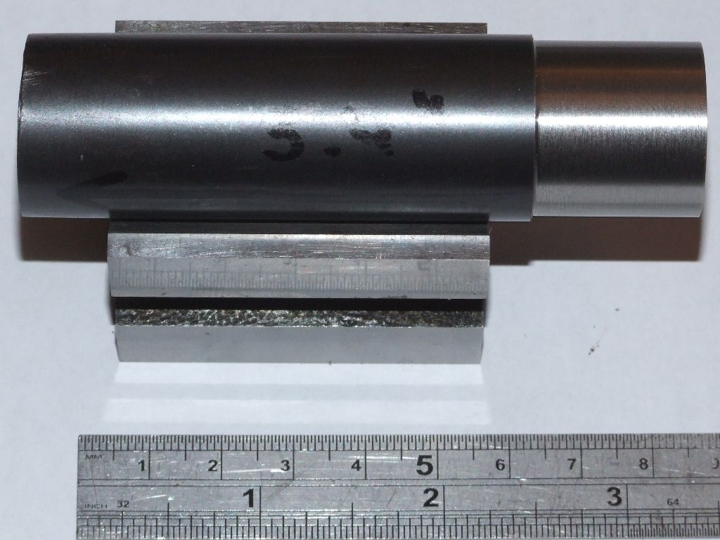

                                                  More progress, forwards and backwards. I've had another go at drilling and tapping tungsten alloy, and drilling small holes. I still don't seem to have the tapping sorted. Even with spiral flute and spiral point ring taps I managed to break one. And that was with a thread engagement of about 30%. Although it was my fault, I think I put a bending load on the tap when trying to back it off. This stuff seems to grip the tap like a boa constrictor. The spiral point tap seemed best, even then it looks like the black finish has worn away after one hole.
                                                  On the plus side I found that slow helix carbide drills cut the stuff like butter, beautiful. Still at £11 for the 3.6mm drill I'd have been might upset if it hadn't worked. I also had a go at drilling 1.2mm holes, as I will need these for the 18swg hoops that stop the balls flying off if the governor springs break. Here's the result, two 1.2mm holes 6mm deep, no problem:
                                                  The drills are 4-facet so I didn't centre first, just straight in at 2500rpm, using WD40 as a lubricant.
