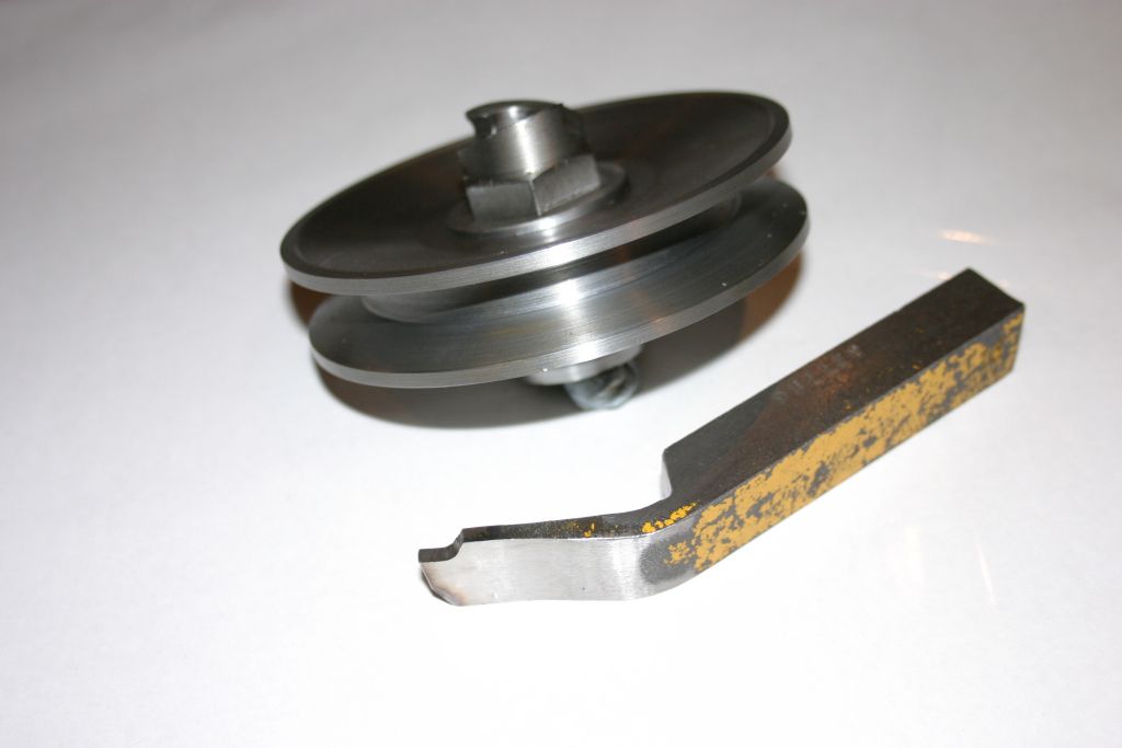

                            #116118
                            Bubble
                              @bubble
                              Hi Ian (Slotdriller)
                              All you need is one of these:
                              Pulley
                              Google "grooving vee pulleys Duplex" to find an old ME article
                              Makes lots of swarf though!
                              Jim

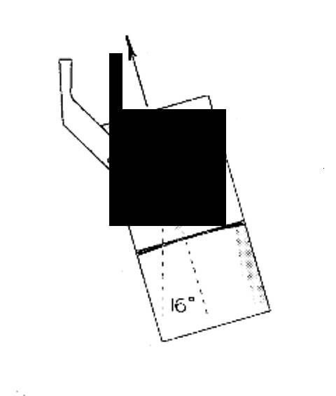

                                      The Duplex article is interesting, but much as I respect 'Duplex', I can't see any significant advantage in using a cranked tool instead of an ordinary parting tool (just rotating the toolpost to a different angle) unless you are turning a very small pulley in a large chuck.
                                      #116143
                                      Bubble
                                        @bubble
                                        Hi Neil
                                        I can only quote Duplex:
                                        "The forged tool has its cutting
                                        portion shaped like a parting tool,
                                        but the angular set enables the tool
                                        to be mounted in a way that avoids
                                        fouling the chuck jaws or shoulders
                                        on the work when machining the
                                        grooves in either a plain or a threestep
                                        pulley."
                                        If you try it you will see how much easier it is, with lots of side clearance for the tool.
                                        Especially on an ML7 where the topslide cannot be fully rotated.
                                        I have never experienced judder with this tool in spite of the overhang.
                                        Jim

                                              Sub Mandrel
                                                @submandrel
                                                Hi Jim
                                                What I mean is angling the top slide, but then turning the toolpost it so the parting tool is straight as normal.
                                                It will then take an angled cut (like a roughing tool) as it moves forward. It will actually have LESS tool to the left of the cut than the duplex tool although I accept that the topslide may have to be slightly closer to the chuck.
