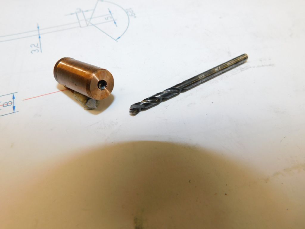

        I got one difficult sample.
        It turns well to a nice finish, will part off and drill with small (up to 5-8 mm drills).
        However drilling with larger drills or slot drills ends up in failure, regardless how sharp they are. Regrinding doesnt help either.
        I predrilled 8mm and tried to open up bore up to 12 mm and this was of most horrible drilling experiences I ever had, even if successful after long struggling.
        Drill just doesnt want to cut and that's it.
        It is not a very hard material either but now I better understand why it is so good for bearings.
        Do you have any ideas why it behaves so or know tricks around it?

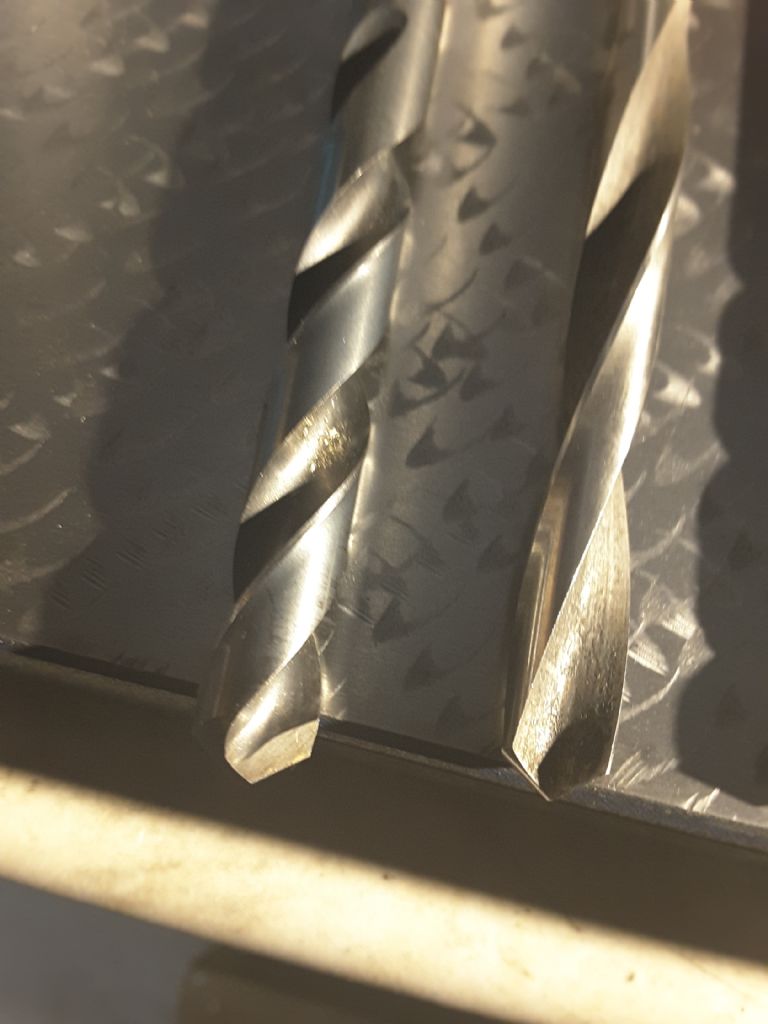

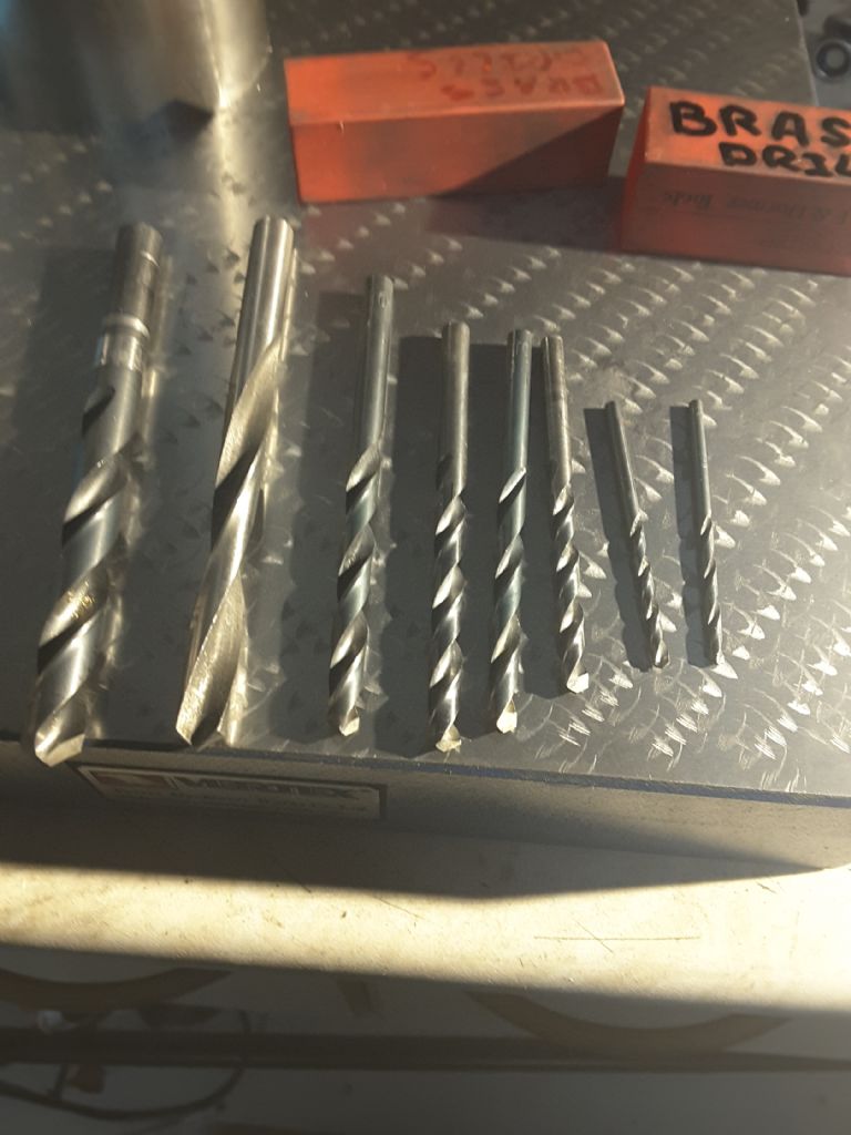

            I modify the drills I use on brass and bronze. I grind the front cutting edge to give a flat cutting face which stops the drill grabbing and use a cutting oil or coolant.brass drills (1).jpg
            David

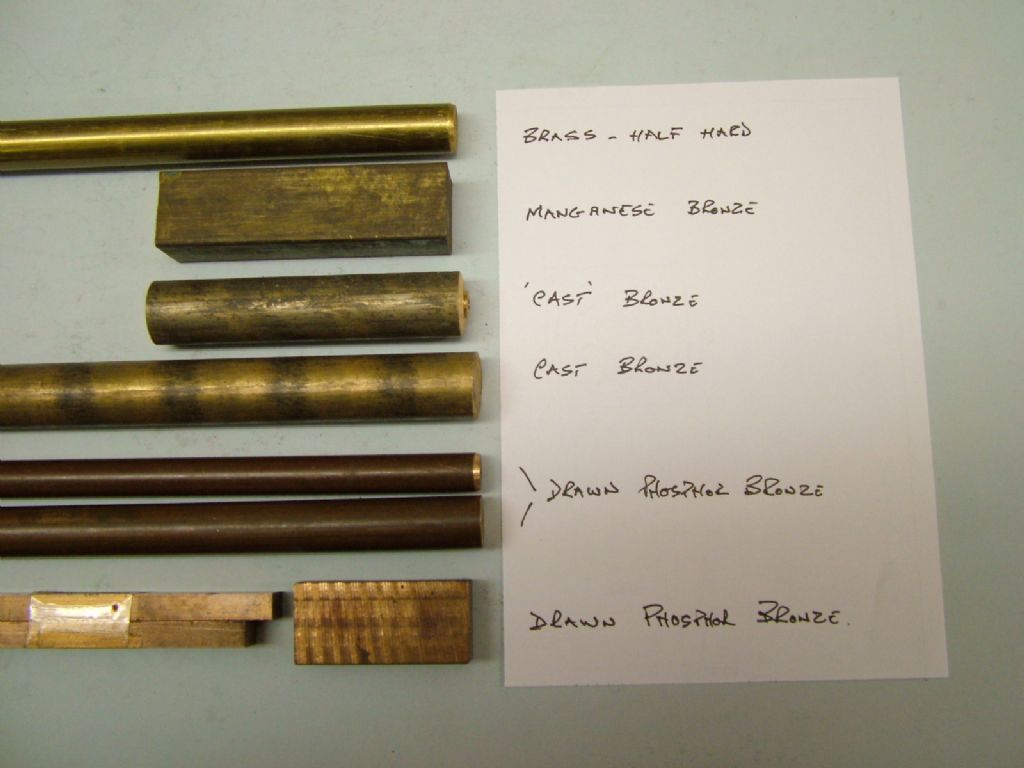

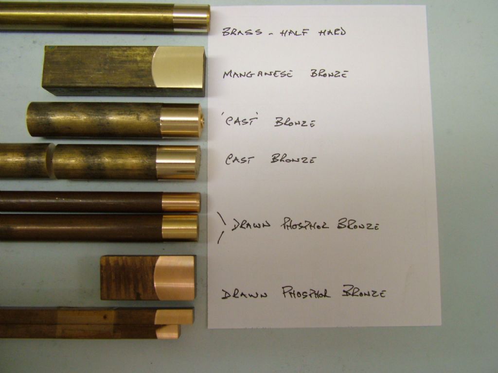

                                    Though theres quite a few pieces of it lying in the drawer, sourced from various shows over the years, it's a material I try to avoid if possible due to the propensity it to seize a drill. It was not that long ago that I had a drill (about 3mm) seize in a piece and snap the drill quicker 'than the eye could see'
                                    Several years ago on a similar theme over bronzes I did this to show the differences in basic bronzes likely to be found in a home workshop.
                                    As already said by someone else there are many different 'brasses' – gunmetal, not shown above probably the most used by ME's
                                    Where possible I prefer to use manganse bronze for bearings in steam engines. The cast bronze is also an excellent bearing material in combination with leaded steel for slower running bearings .
                                    Hope that's of a little further interest – Ramon (Tug)
