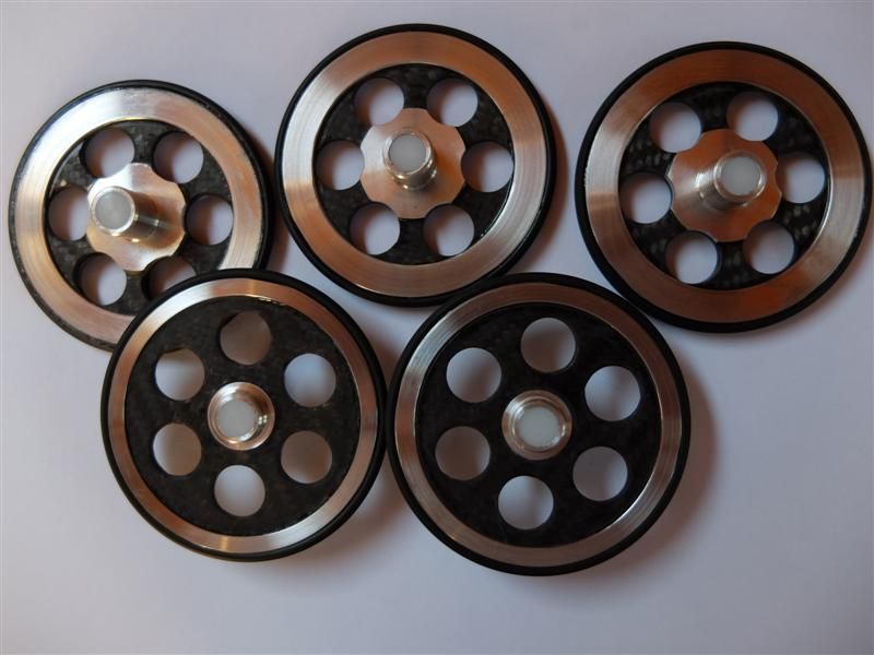

                                          Versaboss
                                            @versaboss
                                            Posted by John Stevenson on 13/10/2013 15:35:09:
                                            Carbon fibre is insanely abrasive even for carbide cutters.
                                            i have had decent success with the rotary rasp type tooth form in carbide but you do have to factor in tooling costs at about x4 or x6 of normal machining.
                                            Hello John,
                                            I hope you are still around…
                                            I am very much interested what form of rotary rasp cutter you used for carbon fibre. I have to do a couple of hundred holes of 12 mm diameter, in 2 mm CF. The holes should be as clean as possible, with no splintering or delaminating. I used before a 12 mm carbide endmill, but had to feed down extremely slooow…
                                            Maybe your usage was for side cutting only with these rasps?
                                            Greetings, Hansrudolf

                                                Ian, I don't think punching is possible. Firstly I have not the equipment, and secondly the holes go through Aluminium also.
                                                That's what I want to make (now follows that terrible picture-inserting-horror):
                                                Not ok; camera symbol did nothing. Again:
                                                Strange, second try seems to be successful. oh yeah…

                                                  Hi Hansrudolf, ……try here…**LINK**
                                                  hope this has done the trick, you will have to cut the holes with a diamond faced tool, no way would you punch it ,if at all it would delaminate…

                                                    Lancelot, thank you very very much for the advice above. I was at first not very sure if that works, but took the plunge and got a 12 mm diamond core drill (from ARC, satisfied customer etc etc.). Quite cheap they are also…
                                                    Yes it works a treat. I put the rings in a jig (top and bottom plate with the 6 holes), so the drill had a bit of guidance and I could cut from both sides. Result; a clean hole, not the slightest delamination or splintering. Happy!!!
                                                    I put this here just in case someone faces the same problem.
