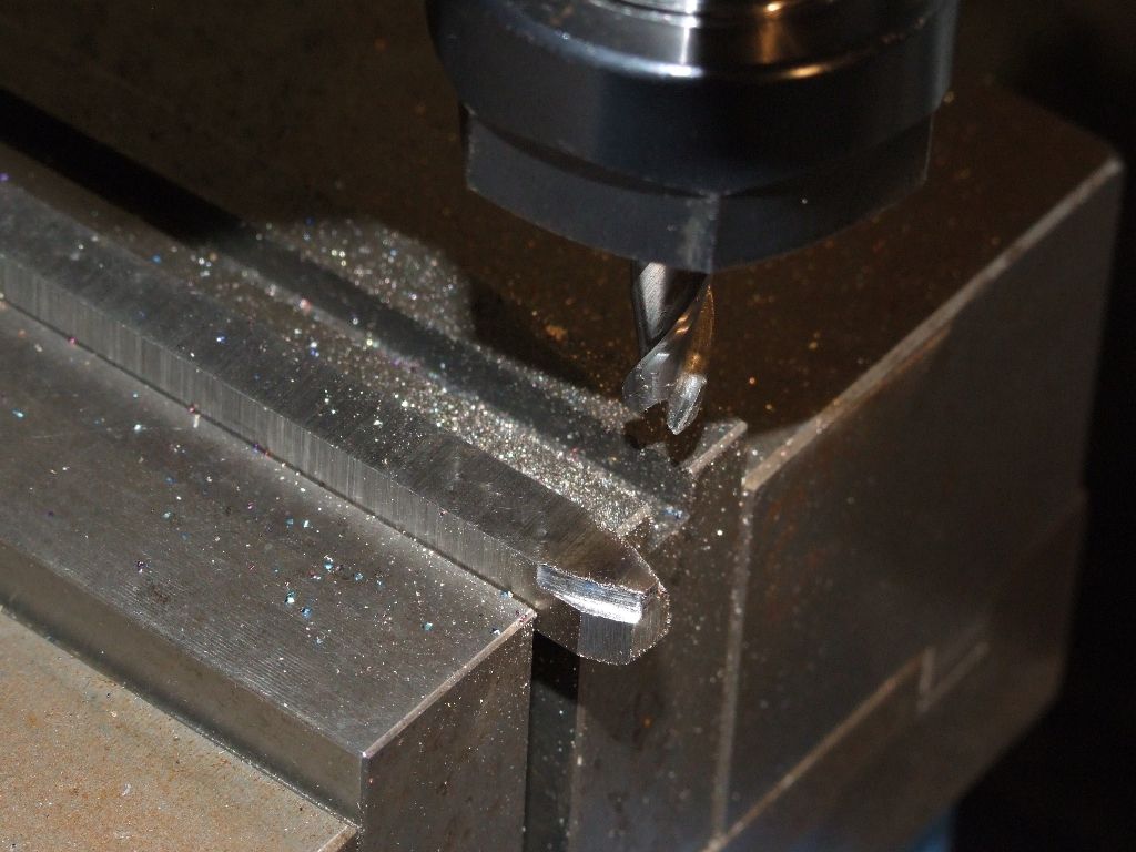

          Anonymous
            It is straightforward to mill hardened HSS with carbide cutters. As shown below; milling an involute form on the end of a HSS toolbit for use in shaping an internal gear:
