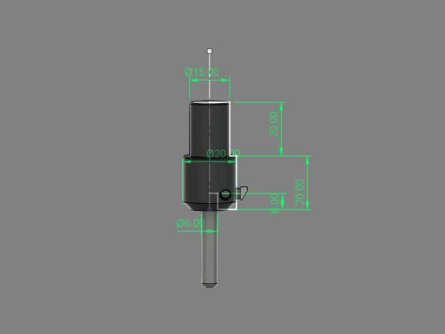

      If I don't make the pilot guide as part of the tool, what would be the best way to attach it?
            Make the guide first to suit a reamer that you have. The hole it goes in and the shank are the only important diameters for size and concentricity.

                Ok but how do I secure the pilot to the cutter?
                Loctite.

                  Pilot = old valve stem ! Fix is as above ! BUT as NDIY has said do the job on a mill, round nose cotter Etc. I feel you are trying to achieve a degree of accuracy that is not needed and in combustion space balancing UNLESS you can macine every space to a hight tolerance to get ballance will in balancing alter that shape. The shape needs to be right ish but it's the chamber volume that needs to be right ! I have a little used B & D valve seet cutter/facer, PM me. Good Luck, Noel.

                    The reason I am doing this on a lathe is (a) to learn how to machine on a lathe and (b) because I don't have a mill.
                    So bore a hole the same dia as an old valve stem and loctite it in place?

                      Yes. Think how much easier that is than reducing a 25mm to 9/32" over a 70mm length. Not only do you save work, time and material but you get a better result.
                      Another thing; why is the tool so big? The tool head only needs to be long enough to hold the cutting tool. I spent a few minutes guesstimating for my head, which use a 23mm diameter valve, and think this
                            will need to be slightly smaller diameter to fit inside the valve seat once I actually get the head apart.
                            Nice drawing, what did you used to draw it?
                            I am considering your idea of using the stem from an old valve, but need to check a few things.
                            The valve throats on and A Series 12G940 head are around 26mm (Exhaust) and 31 – 32mm (Inlet).
                            So with this in mined, the diameter of the tool needs to be small enough to fit into a 26mm valve, but the cutting bit needs to be able to stick out far enough to cut a recess of around 3 – 5mm (Not su re how much) around the top edge of a 32mm valve throat?
                            Let's say we 2mm clearance between the tool and the valve throat sides. The tool needs to have a diameter of 24mm.
                            We want a recess with a 5mm diameter.
                            With a tool head of 24mm, on a valve throat of 32mm, the end of the cutting bit needs to protrude 8mm?
                            Drilling a 7mm hole into the base of the tool head to fix a valve stem into the base of the tool will impede the hole for the tool bit, unless the hole for the tool bit is drilled far enough up the tool head? If it is will this be an issue?

                              that's Fusion360; the toolbit, pilot and tool body are separate components. I've turned on visibility of the revolved sketch for the toolbody so the dimensions are visible. I've stated on other threads that I don't think 2D drawings are required for lots of parts if a 3D model is available, and this is a good example.
                              Those are good questions, which is why that model is a guess. The body needs to fit inside the valve seat, but it can't go too deep because of the valve guide. Juggling the depths of the pilot and bit holder bores is necessary. I need to remove a valve and take some measurements, and combine those with the stock I have on hand.
                              I'm doing this for the original use of Vizard's tool; to get most of a 3 angle valve seat on the cheap. Like Noel, I think you're complicating what you want to achieve. Sheet metal templates and hand grinding of the combustion chambers is the traditional way of doing that job, and I think CNC is the only realistic way to avoid it.

                                  Here's a model of the tool using TinkerCAD, I can print this out and see what it looks like?
                                  The holes for the tool bit are 7.94mm and I put one 6mm hole for a grub screw, but I'll probably need two?
                                  There is a 7mm hole in the base for the pilot (old Valve Stem).

                                                    So I bought the Modifying Cylinder Head book by DV and it compliments his yellow Bible, but there is a lot of info on other heads that is not needed.
                                                    Anyway here is a better image of the valve cutting tool
                                                    mentioned in the book.
                                                    #554342
                                                    William Harvey 1
                                                      @williamharvey1
                                                      I know I won’t be using this tool to cut valve seats so the setting size is not crucial but it would be helpful to be able to work out the setting size formula as it might help me get the best diameter for the tool head and maximum permissible stick out for the cutter?
