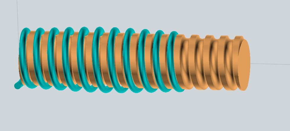

                              Wind some wire around the thread and and grip the wire in a collet. The wire diameter should be slightly greater than the thread depth.
                              Martin.

                                    Something like this:

                                                    Can anyone say why it needs to be more complicated than I have already suggested?
                                                    When I machined some ballscrews a while ago, I think I found a suitable spring and wound it along the thread – a bit like a Helicoil. As the spring sat higher than the peak of the ballscrew I was able to grip the spring in the jaws of a good three-jaw chuck and so machine the screw.
                                                    Martin.
