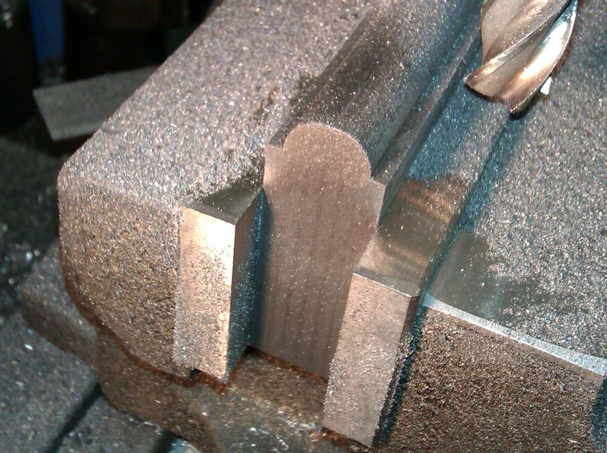

                        #778141
                          If your DRO does indeed have the ARC or radius function then it’s almost a no brainer to use that. This is the type of curve you can cut with that function, just needs a very small amount of final finishing. Would be even smoother if done with an insert rather than this that was done with a standard milling cutter with no effective “tip radius” That is a 1/2″ cutter for an idea of size
                          IMAG0787

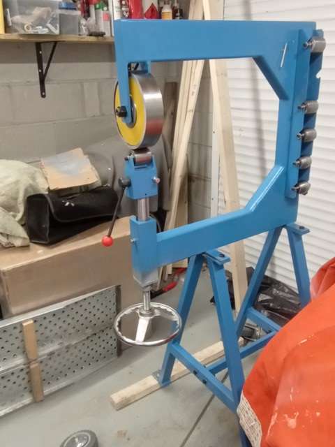

                                                I was hoping that one of you guys would have a simple solution! Most of the above I have done in the past.
                                                My lathe is a Warco GH1327 and is surprisingly sturdy. I can part off 3″ steel with the power feed. I will probably grind a carbide tool to the profile and have a practice on some 3 inch bar. Simple is usually the best approach.
                                                Here is the wheeling machine. I had to make all new spindles for the lower anvils as they were all out of true. The lower adjusting piston was crazy sloppy and the bores of the top and the sliding lower (if you get my meaning) so I made a new piston stepped to fix the problem. The threaded adjuster was very sloppy and bent so I replaced it with a new adjuster and added a ball bearing thrust bearing to the adjuster below the piston. It runs very smoothly now.
                                                There is some flex when you tension it but not terrible. It works quite well although the lower anvils may be a little small.
