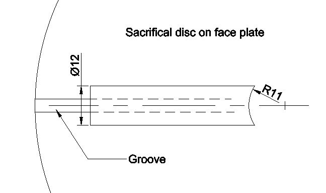

      I have a need to machine a concave shape (with a radius of 11mm) on the end of a 12mm dia brass bar, ie at 90deg to the bar's axis, not IN the end, and am not sure of the best way of doing so.
      If I had a boring head, I imagine it would be relatively easy to rig something on my mill but as I don't, I'm trying to figure out if it's possible on a lathe.
      I've come up with the following idea…
      1) Fasten a sacrificial plate (wood would appear to adequate) to the face plate
      2) Using the crossslide (with the spindle locked), cut a horizontal groove in the sacrificial plate at centre height.
      3) Clamp the bar in the groove (this ensures that the bar is aligned with the centre line of the lathe
      4) Using a boring bar in the toolholder, cut the radius.
      Simples…. as per the diagram (clamps omitted for the sake of clarity)
      The question is whether there is any fundamental problem with this solution and/or am I over-thinking it & the there is a better/simpler way of doing it?
      Brian

        Will this work?

          Don't forget to balance it

            It would work but a simpler way may be to mount your brass bar in the toolpost at ctr height which saves making a holder and then use a simple boring bar in the lathe chuck to cut the radius. Boring bar only needs to be a bit of steel bar drilled through for a cutting bit and cross drilled for a grub screw.

                As the 11mm radius cut is a straight cut thru/across the end of the bar, any 22mm dia cutter could be used. Either plunge cut or come in from the end on the side of the cutter on the mill.
                Or clamp it to a face plate on a lathe and use a standard boring tool. If you do not have a face plate, make a jig to hold your bar in the lathe chuck.

                      Yes, absolutely you can do that. I did something similar when making the fabricated versatile dividing head, carving a radius notch out of one piece of round bar to fit it up to the adjoining round bar. Round bar but the same principle you are imagining: the job rotates off centre around a boring bar that is set to the desired radius you want to cut.
                      Trickiest bit was setting the job and the boring bar at the right position. I used a piece of the required radius held in the tailstock and set the marked up work to match it, then bored to the marked up line.
                      Instead of using a piece of sacrificial wood, i used a piece of sacrificial paper and proceeded with caution. Ended up losing my bottle at the end and left a few thou unmachined and removed it with a file afterwards!

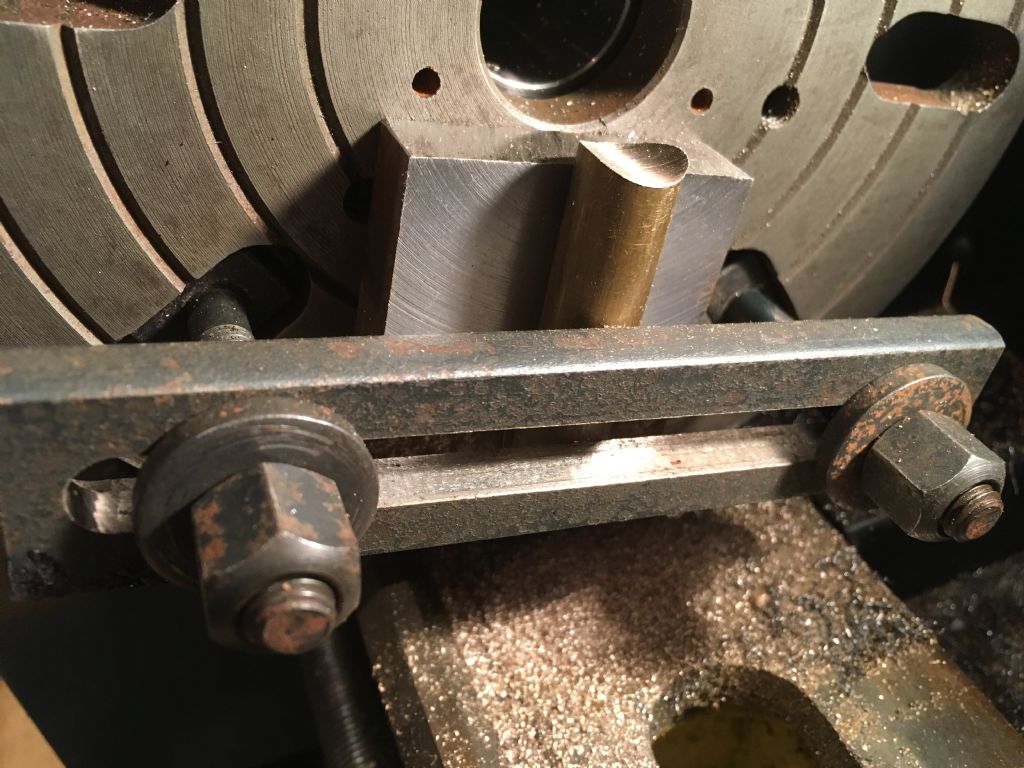

                                      For anyone interested, this is the result of my endeavours. Everything worked out more or less as planned, with the exception that I centralised the face plate under the mill in order to cut the radial groove on the backing piece.
                                      Having said that, I used the same technique to cut a radius on a larger diameter bar but hit a bit of a snag when I found that the clamping bar now hit the top-slide when the faceplate rotated. Easily overcome by swinging the faceplate back & forth whilst nudging the carriage along like a shaper. It took a while!

                                          I have machined similar parts clamped to a faceplate when creating concave surfaces that have to closely fit a cylindrical part. One of the difficulties is accurately knowing what the radius is. Whilst its easy to measure the mating part its much harder to measure a short segment of a concave radius.
                                          I have turned concave radii to sit against parts varying in diameter from about 20mm to 200mm and found the simplest and most accurate way of measuring the workpiece is to clamp a sacrificial bit of scrap on the opposite side of the faceplate, positioned so that at the cutter machines two concave surfaces each rotation. The job then turns into a simple boring type operation as knowing the radius is just a case of measuring the internal 'diameter'

                                                Good idea, Ian – I'll give that a try the next time the need arises.
