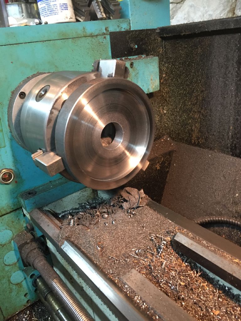

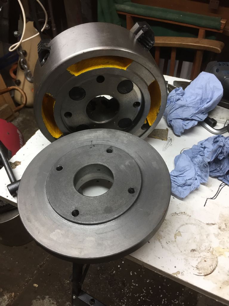

      I would like to have an ER collet chuck for my lathe. The machine has a D1-4 spindle nose and to save money on buying a new backplate I'm making an adaptor to convert the one from the four jaw (which I too rarely use) to fit the new chuck. Four jaw and backplate:
      The register is 125mm diameter and about 4.5mm deep on the backplate – the recess in the chuck is about 6mm deep, so I'm making the adaptor in the same style:
      So to get to to my question – given that the 'rim' on the adapter is only 12.5 mm ( I had a bit of 150mm CI to hand) , is this the way to do it? My gut feeling is 'yes, it'll be fine', but I read somewhere on t'internet that I should make the rim short so the faces internal to the rim mate.
      Not done this before, so any advice/opinions would be welcome.

        #407557
        Pete Rimmer
          @peterimmer30576
          It's only a register so just a few mm would be fine Robin. 12.5mm is more than ample for the job.
          #407560
          Robert Atkinson 2
            @robertatkinson2
            Seeing as the face of the boss on the existing backplate is not machined you have to use the rim of your adaptor as the registration surface.
            Even if both surfaces were machined I'd still make the central recess deeper to give clearance. Less chance of having a bit of swarf or dirt trapped and causing misalignment. The rim is the larger diameter so will be the most accurate register.
            Robert G8RPI.
            #407561
              You could probably have saved some work by machining a double register on the existing back plate simply by reducing half the height of the existing one down to the size you need for the collet chuck.
              #407564
              Nicholas Farr
                @nicholasfarr14254
                Hi, I've always understood that four jaw chucks should seat on the inside and three jaw chucks on the rim. Logic tells me that whatever position the bolts are in, that is where the contact between the backplate and the chuck should be. Bolts should always be used in tension so that the two mating surfaces they are holding have friction between them and that is where the force from one component to the other is transferred, the bolts should never have shear forces applied to them, which if you have even the slightest gap, can lead to a shear force. If you so wish the inner part of the face can be undercut inside the bolt hole circle, leaving a rim like contact face and reducing any chance of rocking over the largest portion of the face on a four jaw backplate.

                #407590
                  I wouldn't assume – I would check what the most accurate face on the chuck is and use that.
                  #407678
                  Robin Graham
                    @robingraham42208
                    Thanks for replies. In retrospect JasonB's suggestion of a double register might have been the way to go. However I am of a nervous disposition and have an irrational fear of modifying 'official' parts – daft really, they're just lumps of metal. I was pleased that the adaptor I made fitted the backplate with a wriggle, a push and a satisfying click when it went home, so maybe my skills have advanced enough to cross the line.
                    Nick – I read the same about 3/4 jaws somewhere and didn't understand it. I still don't. Surely if the bolts are tight enough the frictional forces between the mating surfaces are dominant and the bolts don't see any significant  shear forces?
