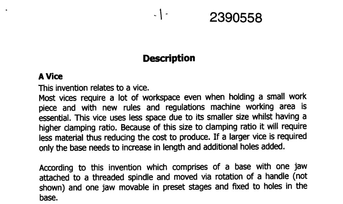

          The patent is readily available on Espacenet, and is well-written and illustrated:
          https://worldwide.espacenet.com/patent/search?q=pn%3DGB2390558A
          Use the little three-dot menu to access the downloadable pdf
          Recommended reading, even if you can’t justify the price.

              A most interesting patent but I confess to not understanding what the actual novelty being patented is.
              Can’t be the re-positionable jaw as I have a very battered vice in my collection which not only exhibits that feature but also has what appears to be better arrangements for lift free adjustment of the moving jaw. I’d be unsurprised to discover that it’s older than I am.

                Good morning, Clive
                I am not a Patent Examiner, so this is largely guesswork … but I am reasonably sure that an extant feature that has not been previously patented can be claimed as an invention by someone with the wit to do so.
                .IMG_0537

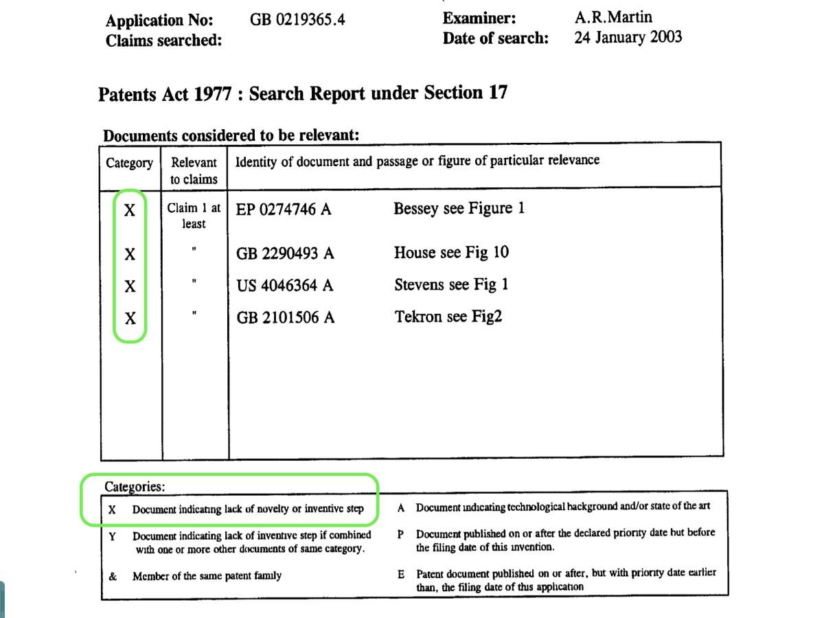

                It is the Patent Examiner’s role to assess the level of ‘novelty’ and particularly to determine whether, or not, the feature has been previously patented.
                ‘Prior Art’ is often referenced, as a “jumping-off point” for a claim, and I think that Douglas Brian House probably managed to do that successfully
                … The Examiner cites four specific instances that he considered.
                [the second of which is an earlier invention by DBH]
                IMG_0538
                … All four can be found on Espacenet

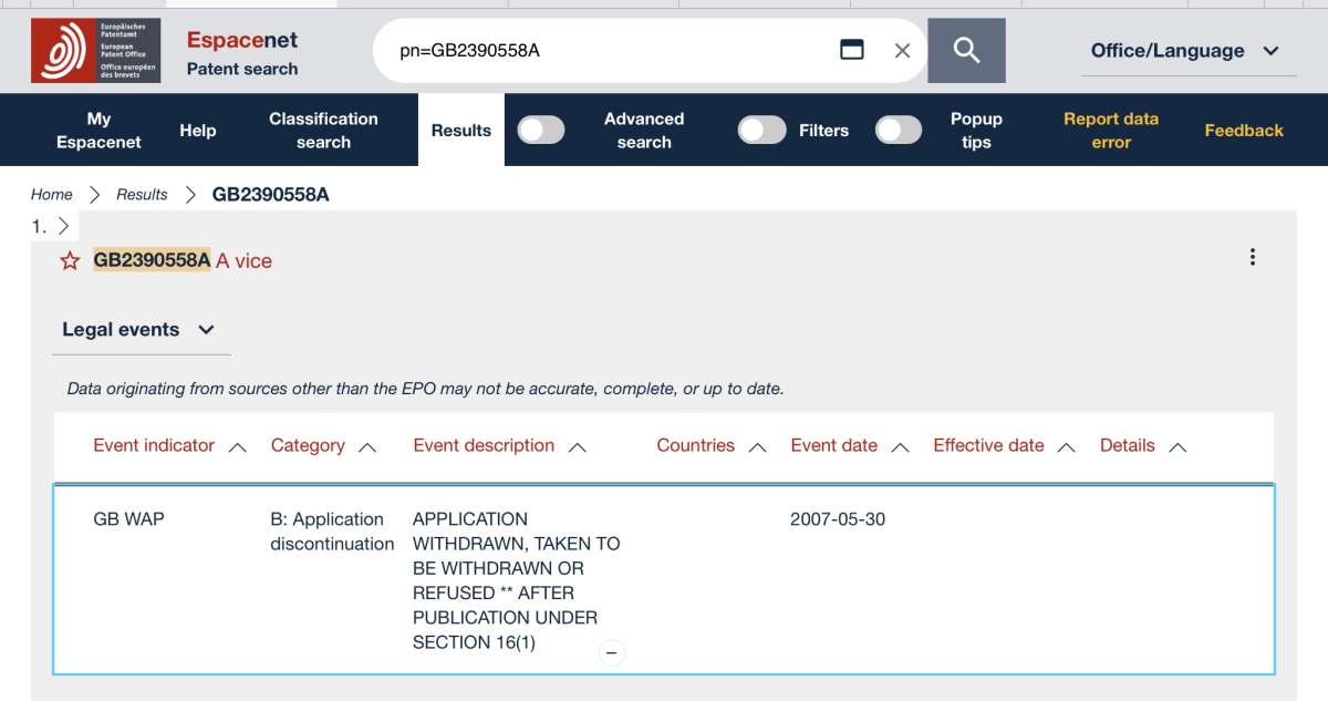

                    Once a feature is in the public domain it cannot be the subject of a later granted and valid patent claim unless in combination with another feature so that the combination is novel and not obvious.  The examiner made 4 citations in the X category which indicates a lack of inventive step.  It looks like the application never made it beyond the initial stage so was allowed to lapse. Looks like the applicant did all the work himself without benefit of an agent, I suspect patent agent would have advised him not to bother filing.  In fact the bibliographic data shows that it lapsed or was withdrawn in 2007.

                        Quite so, John … Well-spotted
