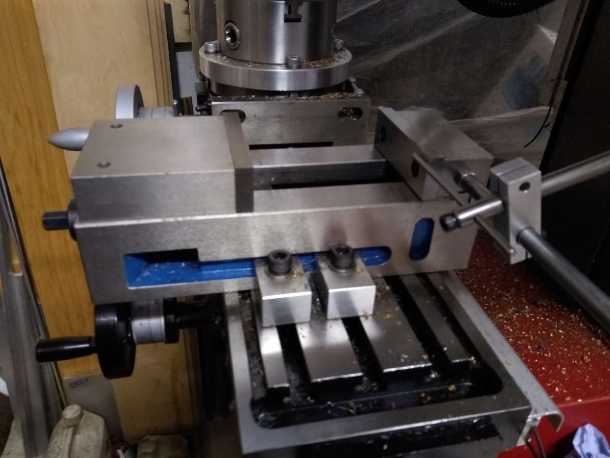

                To answer the actual question, I have a “screwless” vice on my small mill.
                Specfically a precision tool vice type 2 with 70mm wide jaw from Arc Eurotrade. I find it an excellent vice. Holding forces are adequate  and the geometry of the screw (a short caphead) and bar keeps the moving jaw down on the base. I have an allen key with a handle that I use to tighten it. Changing grip over a large range is quck. Loosen the caphead a few turns, tilt the allen key up to disengage the bar and sldes the jaw into the new position.
                A big advantage for my with a small mill (Sx1LP) is the absence of a handle. Nothing to get in the way and if I have to mount the vice with the handle over the bed or fixed obstruction you don’t have to keep flipping a fixed handle over or removing and re-fitting the handle.
                Robert.

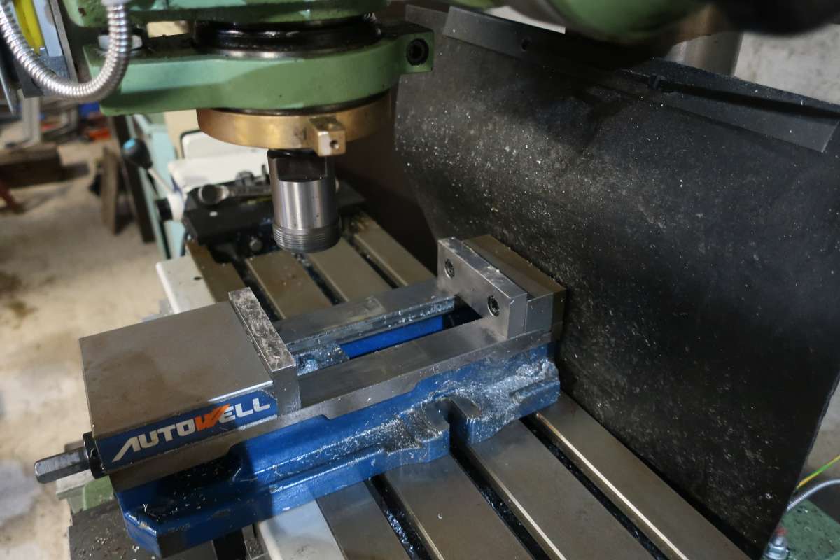

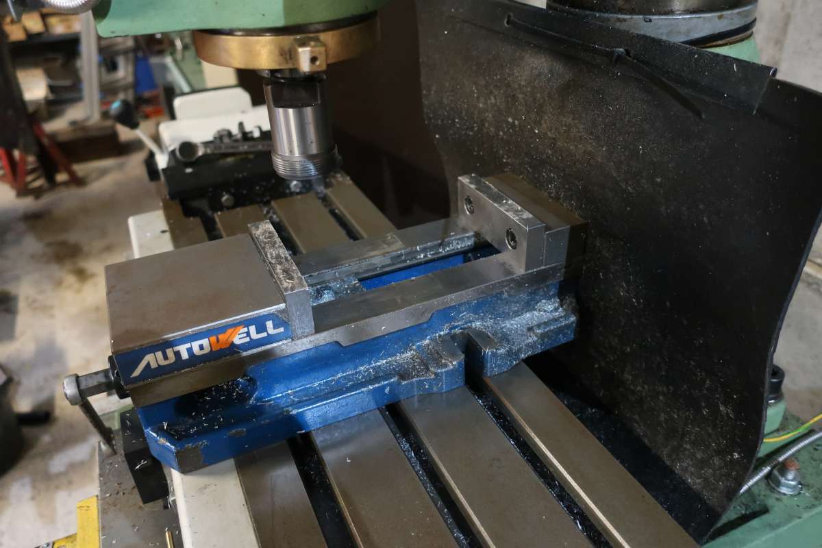

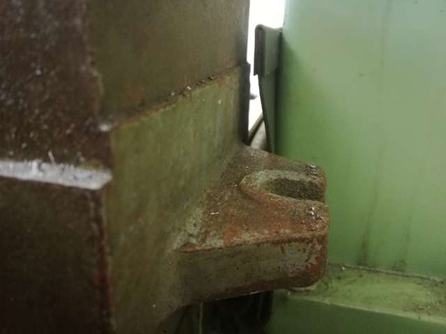

                  I needed to get a wider opening vise than the Bison 100mm ones that we have at the museum and got an ARC versatile 125mm model with the rotary base. The base is only used occasionally, but takes very little time to fit and has saved a lot of bother at times. The rear flange overhung the tables of both mills and I cut it off to get the full Y axis movement. The Bisons also overhung the mill beds and because the mount for holding the vises longitudinally  was at the end another solution was used. The ends of both Bisons was removed and milled square to fit a removable foot in case we needed to hold the vises the other way round.
                  _IGP2542_IGP2549

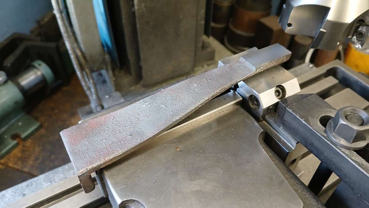

                                You can do similar with most vices if you just use a clamping set on the gutter or bolting lugs. That is what I do if Iwant my vice at an angle or lengthways in preference to using the swivel base.
                                A matched pair of vices is nice buy you can often use unmatched ones or clamp one end to a block or angle plate if needed, handy when one end of the part is a different height to the other
                                20241104_141300

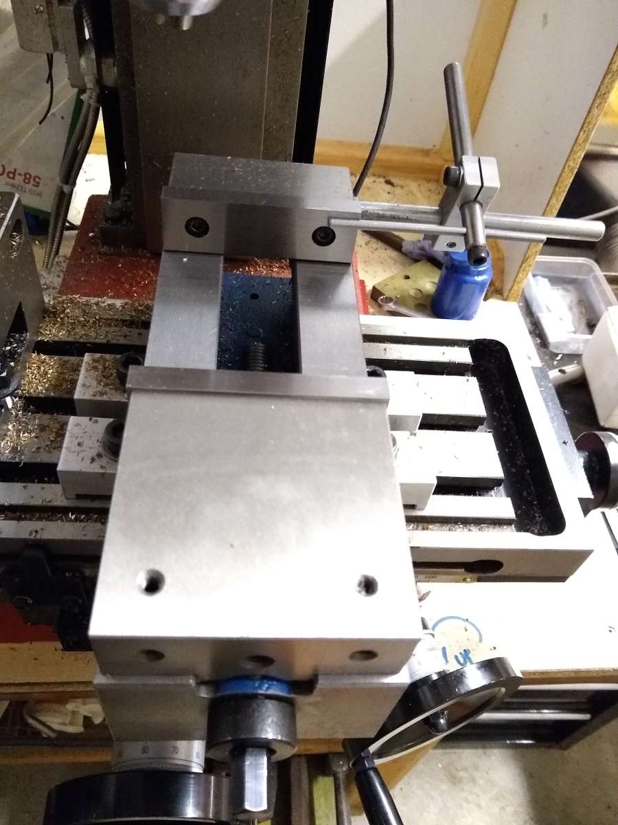

                                      The ArcEuro 100mm SG vice on a Sieg SX3. It is the only 100mm vice I have, so I can’t give a comparison with any other. It had some sharp “flash” from grinding, on the edges when new, but a few minutes with file soon fettled it.
                                      IMG_20250120_101554879IMG_20250120_101506883

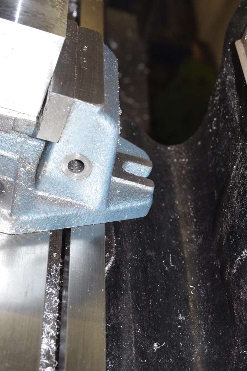

                                        Nicholas Farr
                                          @nicholasfarr14254

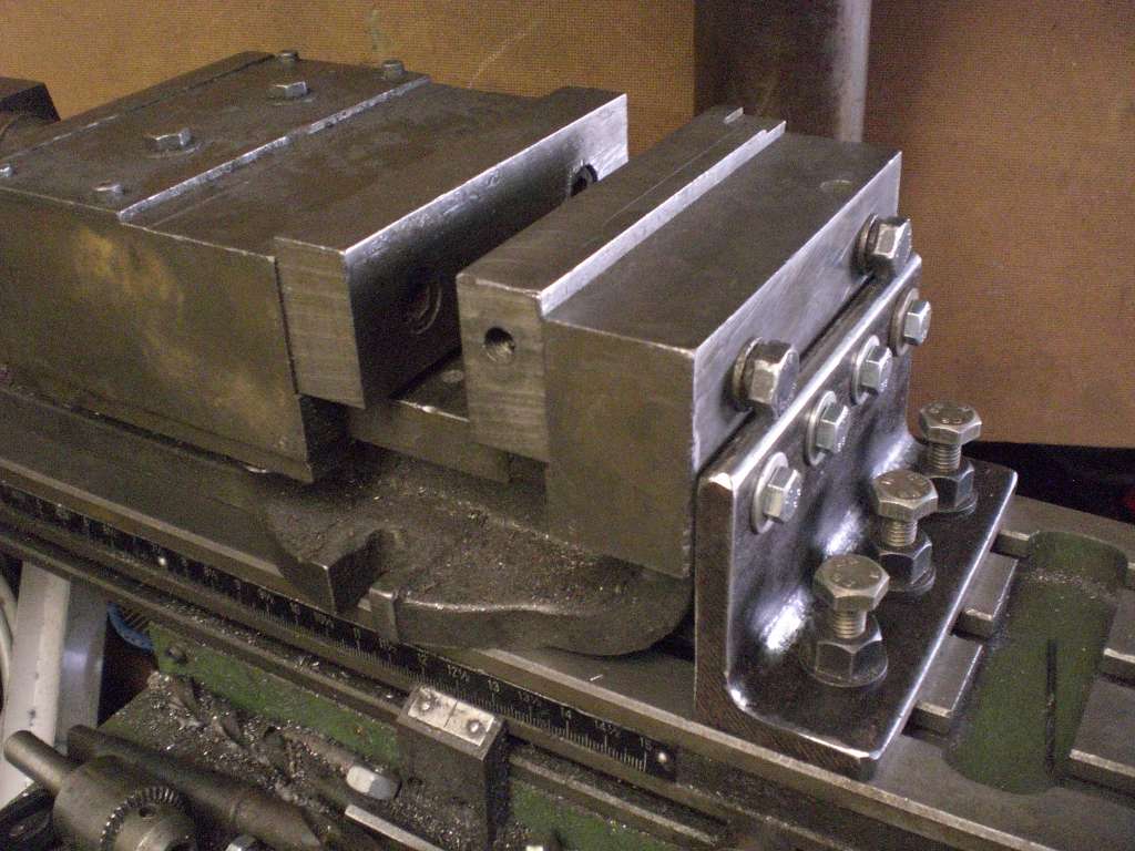

                                          Hi old mart, I have a large 6″ vice that I use on my Warco Major, which has the same issue with a bolting lug that overhangs the table, and I loose about 30mm of Y travel, which hasn’t been a problem so far.
                                          IMG_20250120_133752b
                                          However, I do have another 6″ vice that I had to attach a piece of angle iron to, so I could use it on my Chester Champion milling machine, as it was to big to mount it at a right angle to that table, and there was no bolting lug made at that end, and although the jaws are not as deep and don’t open nearly as much, it will go on my Warco one, and will be about level with the edge of the back of the table, as long as I remove the angle iron.
                                          CIMG2238 (1024x768)
                                          There is another bolting lug at the other end of this vice, so it’s not just the three bolts that can be seen, that’s holding it down. As it happens, I have it stripped down at the moment, for a good clean, as it had got a lot of swarf collected under the moving jaw.
                                          Regards Nick.
