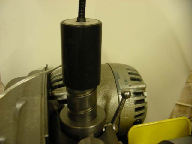

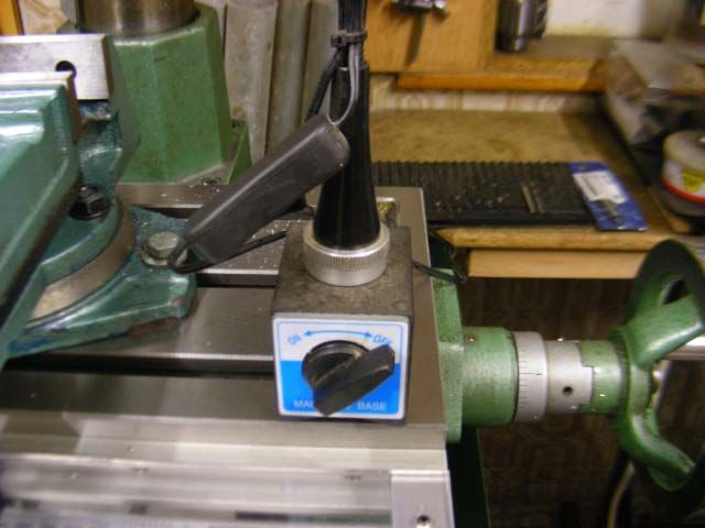

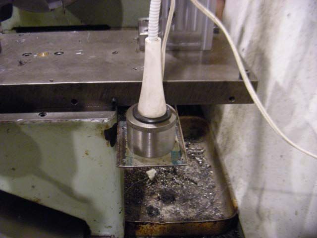

                                    How do you mount the jansjo lamp? The ones I can find are just a lamp with a swan neck that terminates in a usb plug. No apparent method of securing them apart from the plug.
                                    #562289
                                    ega
                                      @ega
                                      The USB type come without a power supply, of course, and I have only used the ones with a round base and included PSU in the workshop; they are readily adapted to machine use:
                                      Edited By ega on 10/09/2021 22:07:21
