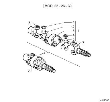

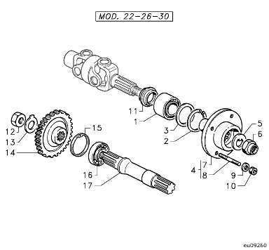

                            #704029
                            colin hamilton
                              @colinhamilton16803
                              eu09340 (1)eu09260 (1)
                              Part 7 is the part i would like to make. Part 11 is a spacer, Part 1 – wheel bearing, Part 3-spacer, Part 4-wheel hub, Part 5 washer and Part 6 is the nut that holds the hub onto the shaft in question
