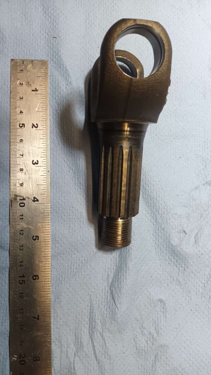

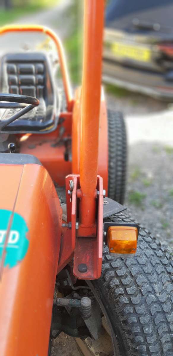

      I gave an old alpine tractor. Its getting very hard and expensive to source parts from Italy. I’ve just spent a small fortune buying this small drive shaft. I was wondering could I machine this from a billet? I have a chipmaster lathe and a bridgeport vertical mill. I’ve never tried milling splines so would appreciate any thoughts/guidance20231230_11034420231230_11034020231230_11041420231230_11042220231230_110409
      #702795
      DC31k
        @dc31k
        That item has been (drop) forged. There is a reason for this – so the grain flow of the metal enhances the strength. It has also been heat-treated on the splines (you can see the oxide discolouration).
        How long did the original part last? How hard was the machine working for that period of time?
        Extrapolate from those two and work how old you will be when the next factory part is likely to fail.
        Milling splines is as easy as milling six flats on a round bar to make a hexagon. Finding the specification of those splines will be less easy. Buying or making the cutter to produce splines to that specification will be even less easy. An inaccurate male spline will also damage (and thus shorten the life of) the female spline into which it seats.

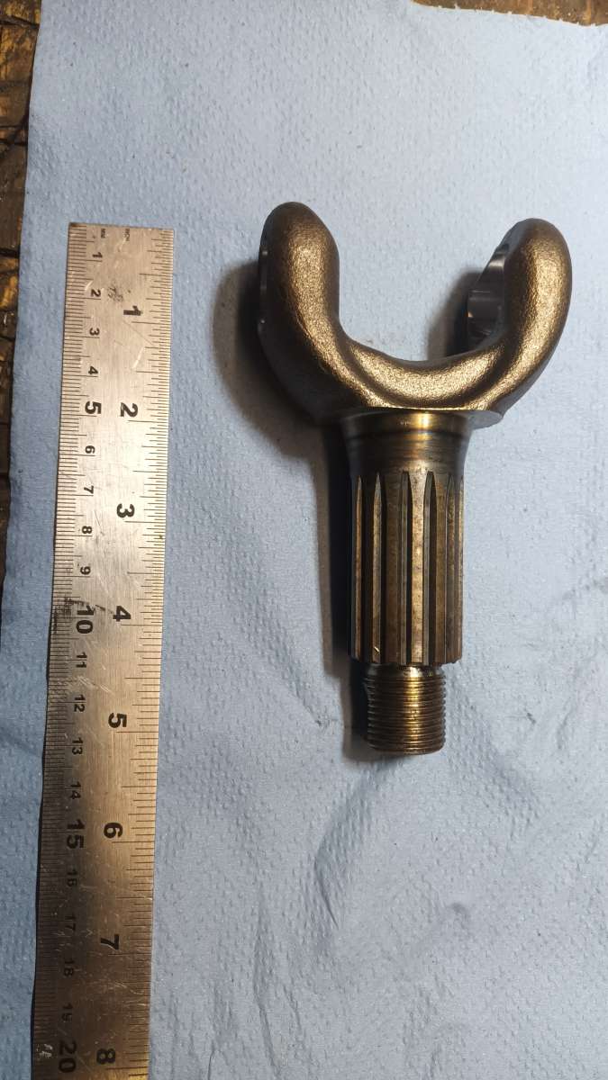

                    colin hamilton
                      @colinhamilton16803
                      The part is the final part of the drive to the front wheel. One end is a universal joint for the steering. A hub, which carries the wheel fits over the splines. A single nut fitted on the thread holds the wheel hub onto this part. The threaded section sheared off at the end of the splined section. I have had two fail in exactly the same place (in 10 years!). I’m no expert but the part looks cast to me as it has that sort of grainy look to it.
                      How would I go about identifying the splines? Are they standards (like threads).
                      20210826_16154420200519_170255

                        With nothing to loose I’d consider drilling it out and tapping the hole then screw in a piece of suitably threaded steel. might need to make it a smaller thread than the exposed end and when you make it avoid that undercut at the end of the thread. Hopefully the induction hardening of the splines is not too deep.
                        Looks like a cast steel to me

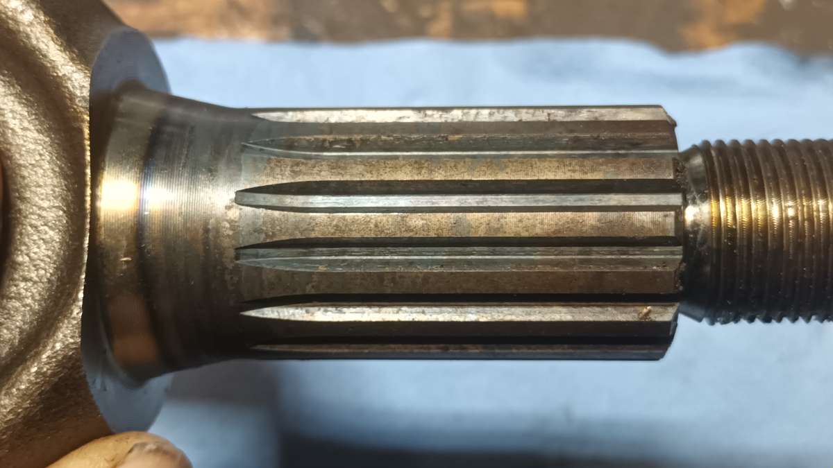

                          The transition between end of spline and end of thread is not good – the relief groove they have made is square edged, which is a stress-riser. That transition should be as smooth and rounded as possible for best performance.
                          If the threaded part has sheared off, instead of remaking the whole thing, why not drill and tap the remainder for a shouldered stud? Loctite it in and if it fails, drill it out and replace it.
                          #703199
                          Ian P
                            @ianp

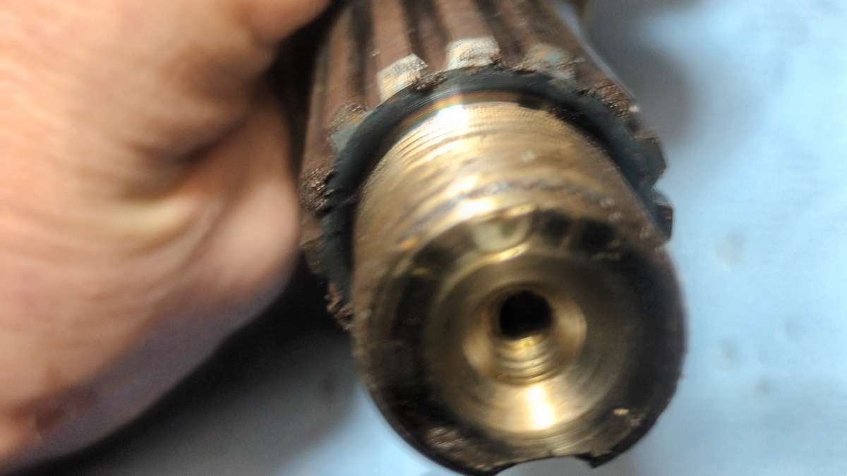

                            If as you say the two failures are a break at the base of the thread then I think you may be able to make a modification and re-use the failed parts.
                            From the first picture it looks like the thread has been rolled but the relief at the base of the thread looks to be deeper than needed (and maybe not a big enough radius). My suggestion would be to through-drill the yoke and splined section and then tap (say M16x1.5 pitch) so you can use a HT bolt instead of a nut.
                            The splined section has been hardened but will not be too hard to drill and tap if you take your time, in any I would aim to make most of the hole clearance and have the threads at the yoke end. You can be a bit generous with the tapping drill size if you get a long thread engagement (say 2xdia).
                            Without know the dimensions of your part I’m only guessing that M16 would be suitable as there is a good source of long bolts. They are used on the rear wheel hub assemblies on several models of VW group cars.

                                    Got to be worth trying drilling and tapping the shaft to screw in a replacement stepped stud for the retaining nut
                                    FWIW a thread size midway / two thirds the size of of the failed thread.
                                    Retain with an anaerobic sealer
                                    Makesure that there is a good radius between the two threads, to avoid stress raisers
                                    (Did you examine the failed surfaces?  A fatigue faiolure will show mas a series of striations across the surface.)
                                    What about the way in which it failed?
                                    If the thread has failed on two occasions, (Presumably at the undercut at the end of the thread?) it sounds as if is being overstressed, either in tension or in bending. Needless to say that the thread shouild not be subjected to bending.  If it is, find out why and remove the reason.
                                    If it takes several years before failure, it sounds as if the loads are slightly above the fatigue limit, so try to remove any factor which can increase the cyclic applied loads.
                                    The thread is there to provide an end load which rertains the hub, and once tightened should only see the tensile load applied by tightening.
                                    Being part of a U J, the loading will be cyclic, most likely to result in failure in fatigue.
                                    Possibly the hub is subjecting the thread to bending loads. Maybe a slight mod (shortening or lengthening with a shim to prevent any end float?) to the hub might cure the problem.
                                    Are the splines loose fitting which will increase loads? If so, assemble hub to shaft with a gap filler (again an anaerobic?) to remove clearances.
                                    HTH

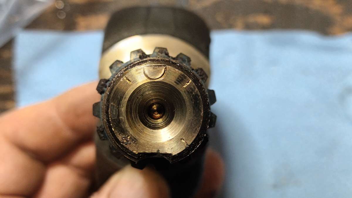

                                              The failure mode needs to be found  Maybe the terminilogy used is not precise?
                                              It may not be shear, the thread is there to retain the UJ on the hub, so will be in tension.
                                              To shear off the thread off implies a force at right angles to the axis of the shaft.
                                              Since the shaft is rotating, it could be fatigue faure in bending.  But what is imposing a lateral force on the thread?
                                              To fail at the undercut of the thread, suggests that the thread is somehow subjected to a bending load,
                                              (Because of friction between the nut, or backing washer and a hub which is a loose fit on the splines?)
                                              The thread would be unlikely to be subject to a cyclic torsional loading, since it will only experience torsion caused by friction between the threads when the nut is tightened, to apply a tensile load.
                                              Maybe the hub subjecting the thread via the washer to a cyclic torsional load, again because of a loose fit between nthe hub and the splines.
                                              None of us yet have enough detail to be able to accurately diagnose the reason for the failures, so can only speculate.
                                              The fact that a second has ocurred suggests that a very detailed examination of the parts needs to be made to determine if it is caused by a design, or a manufacturing fault, or even excess loading in service.

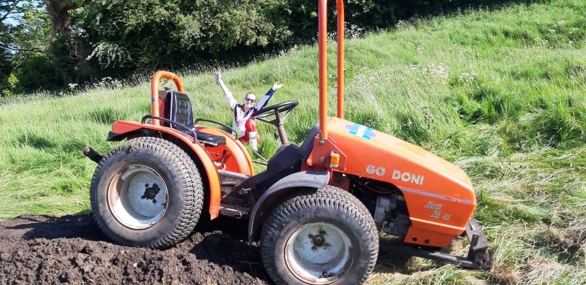

                                                    The nut holds the hub onto the shaft. The tractor is used on very steep land (over 30 degrees). The dealer thinks that the loads on the lower wheel when turning at very steep angles with something heavy like a topper fitted could be causing very high loads. Especially if the wheel lock is set allowing the wheels to turn too far. Unfortunately I had to send the broken part off so they could identify it properly so will not be able to get pictures of the failure. The tractor has no suspension and my land is very rough so I do spend most the time bouncing around so everything takes a bit if a pounding.
                                                    #703524
                                                      It looks like an impressive little machine, which is probably being used at the limits of its ‘design envelope’ … I fear you may just have to accept that the shaft is a consumable !
                                                      Edit: __ https://ctmltd.co.uk/
