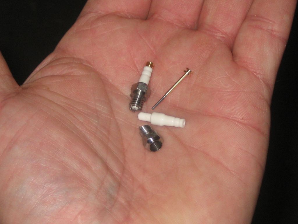

                Hi Andrew,
                I was also looking at using Macor for plug insulators – very expensive stuff! Then I read somewhere that Corian (kitchen worktop material – 1/3 acrylic polymer, 2/3 aluminium trihydrate) was also a good insulator material unless you’re making plugs for a high performance engine – clearly not a problem on a hit-and-miss. I managed to get half a dozen 2″x5″x1/2″ off-cuts from an eBay trader (apparently, it’s a popular handle material with knife makers) for a fiver and set about making some M5 plugs for my 2cc 4-stroke. It’s quite easy to machine with ordinary HSS tools but it does wear the sharp edge off quite quickly so regular stonings are required. Had a few mishaps along the way – too heavy a cut with a worn tool – which would have been very costly in Macor!
                Have (hopefully) attached some photos of the finished article. It’s been run for about an hour now at up to 11,400 rpm and seems to be holding up well.
                Best regards,
                Pete

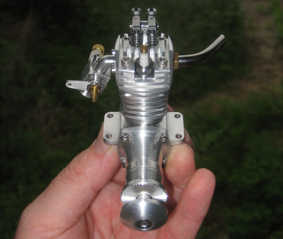

                          Peter Hi. The knurling on the prop drivers looks very neat, So how did you do it ???, knurl or machine with a pointed milling bit, the rest of the engine and spark plugs look excellent, So are Ramons engines. I built a Bolaero 18, of the modelenginenews plans, look OK, although I did a few small mods to it, I will, when I learn how to upload photo’s I show you what it looks like, Iv’e not started it yet, but lots of compression, Why not started it !!!, well first up, hard to get cheap fuel, and after all the rain we had, I had to lop some trees and cut down others, ( Im’e getting too old for this caper).

                                  Hi John, Thanks.
                                  The ‘knurl’ was machined on my Boxford shaper using a small rotary table tilted at a carefully calculated angle and a 90° vee shaped lathe tool. A bit of a faff but I like the result.
                                  Here’s a link to a short wobbly video of the engine running.
                                  Sorry gents for straying off-topic..!
