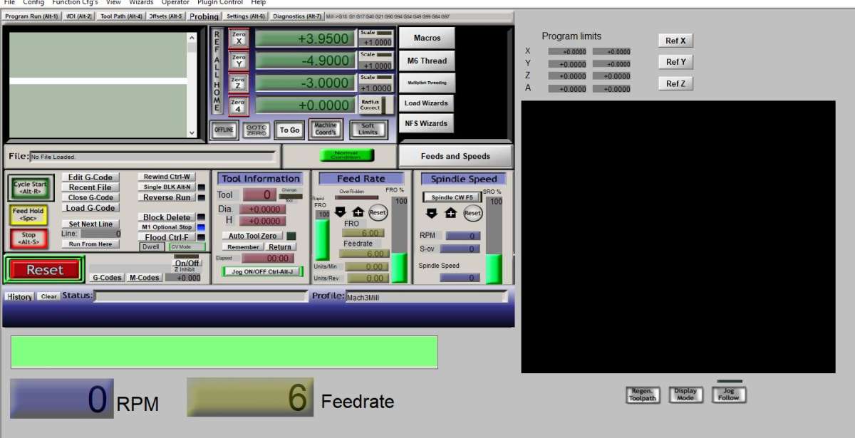

          I took a different path when I started using a large screen, I modified the Mach3 screen to suit my work style and filled the screen with the things I use most so that I stay on one screen for nearly all of the things I do.
          Mach3 large
