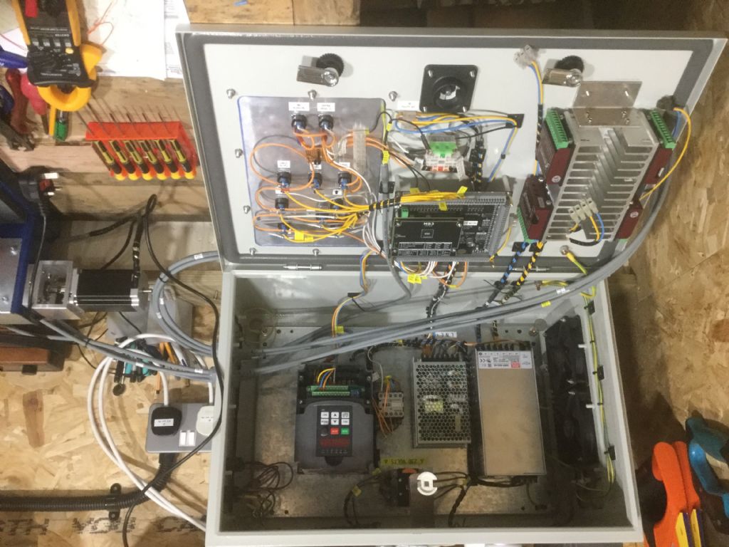

                      The setup so far (upside down for some strange reason only known to ME, as it displays the right way up everywhere else)
                      edit – now the right way up!

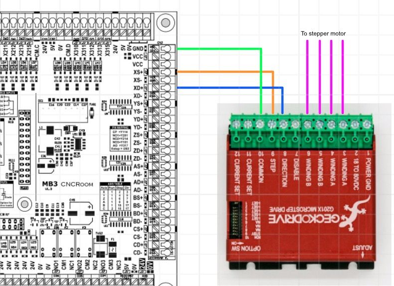

                          Oh how I wish that were so. I'm afraid that for someone new to all this the documentation is more a source of utter confusion and bewilderment than of help. If we take the steppers as an example, the drivers themselves seem quite straightforward to connect – four wires to the steppers themselves, and then a wire for each of Step, Direction and Ground to the breakout board. But the breakout board has a + and – for each Step and each Direction connection – and why is unexplained. At the moment I have connected these as I've shown, but with no confidence that I'm right.

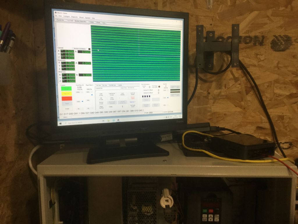

                          I also have a niggling problem with the display, which I've ignored so far. The tool path window is a flickering green stripey mess. I'm hoping it isn't because the video card in the computer is not up to the job, as its new and bought specifically for this project. Or maybe it's because I haven't finished configuring Mach 4 yet??

                            Sorted the tool path display by installing a different video driver. Wiped Mach4 and reinstalled so I could start afresh by tackling one bit at a time. I have sorted out the stepper motors, along with the limit switches. Have also configured the limits switches as home switches, which seems to work, though I think I need one more dedicated home switch so I can make sure the gantry is automatically squared up correctly. The spindle is also working correctly using the analogue output of the ESS, so am now off to Halfords to collect some distilled water and antifreeze for the spindle cooling setup.

                              This is the stepper drive's documentation G201X Stepper drive wiring
                              I think it is clear. The BOB connections are clearly labelled and I think you could use either the XD+ or the XD- and also the XS+ or XS- and it would make very little difference to the operation since Gecko don't say to use one or the other type of input. The ones that have a specific requirement tend to show it in the wiring diagrams which show pull up or pull down resistors. Section 5 of this manual shows what I am talking about Leadshine stepper driver manual

                                Thank you Martin. Yes, the Gecko drive wiring is very straightforward. It’s the terminals on the breakout board that threw me, as there didn’t seem to be any understandable info on why they provide both + and – terminals for each connection. Anyway, I’ve just wired them all up to the + terminals, and they seem to be working fine. Now that I’ve read your explanation above I have managed to make a bit of sense of the MB3 documentation, so I’ll have a closer look tomorrow at what I’ve actually done to double check it is ok (all my notes and scribbles are in the workshop and I’m currently sitting next to a woodburner!)
