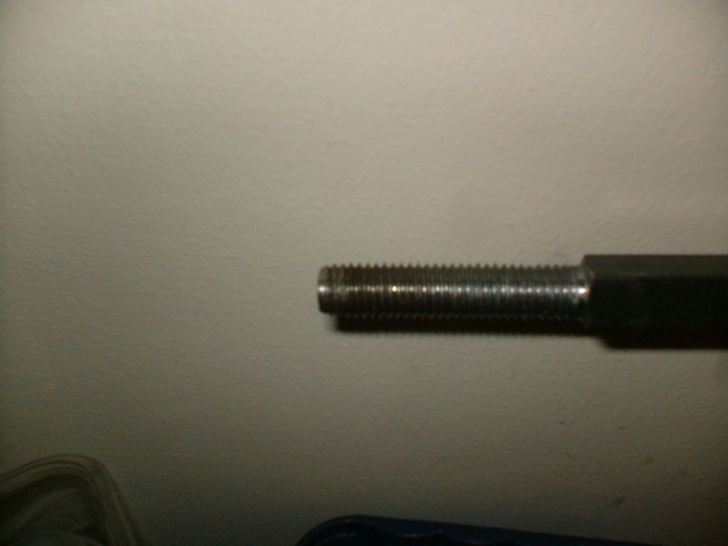

                        Ady1
                          @ady1
                          I cannot thread turn it, as my lathe has an imperial lead screw
                          Just use a 35 on the spindle and a 63 on the leadscrew
                          Your diameter is fine, cut a rough thread on the lathe and finish off with the die
                          Stainless is tough stuff though, a carbide tool may be your best bet and take off as much as you can so the hss die hasn't got too much work to do
                          (I've been trying to upload some piccies but this place is a nightmare tonight)
                          Edited By Ady1 on 28/10/2012 02:37:38

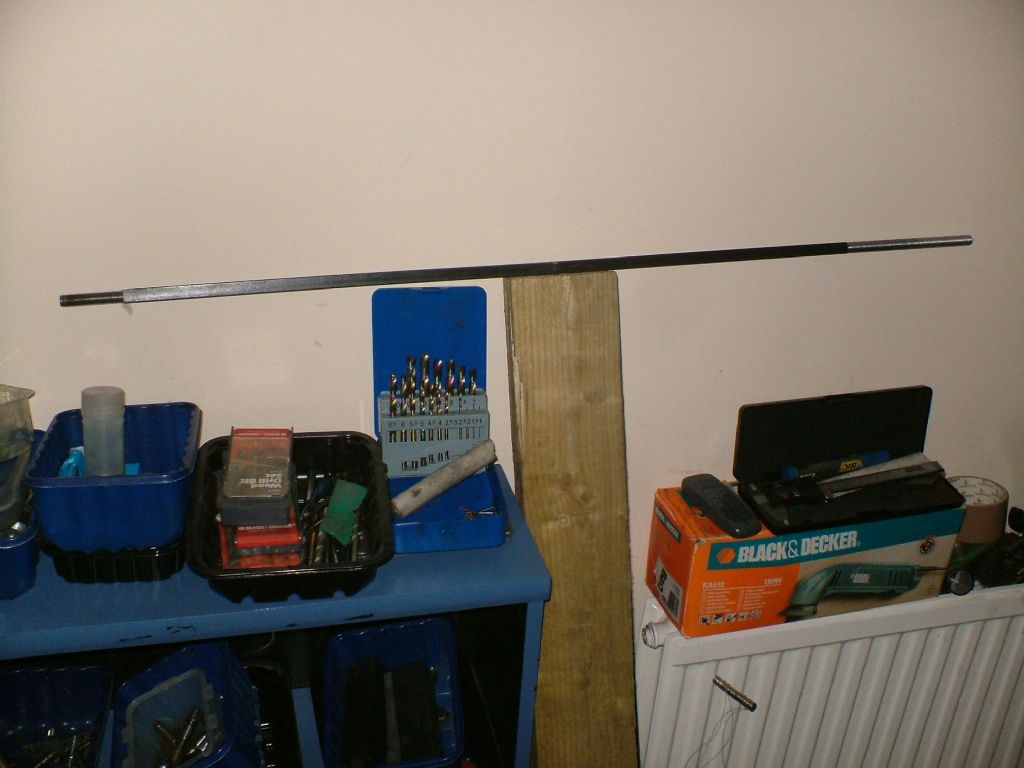

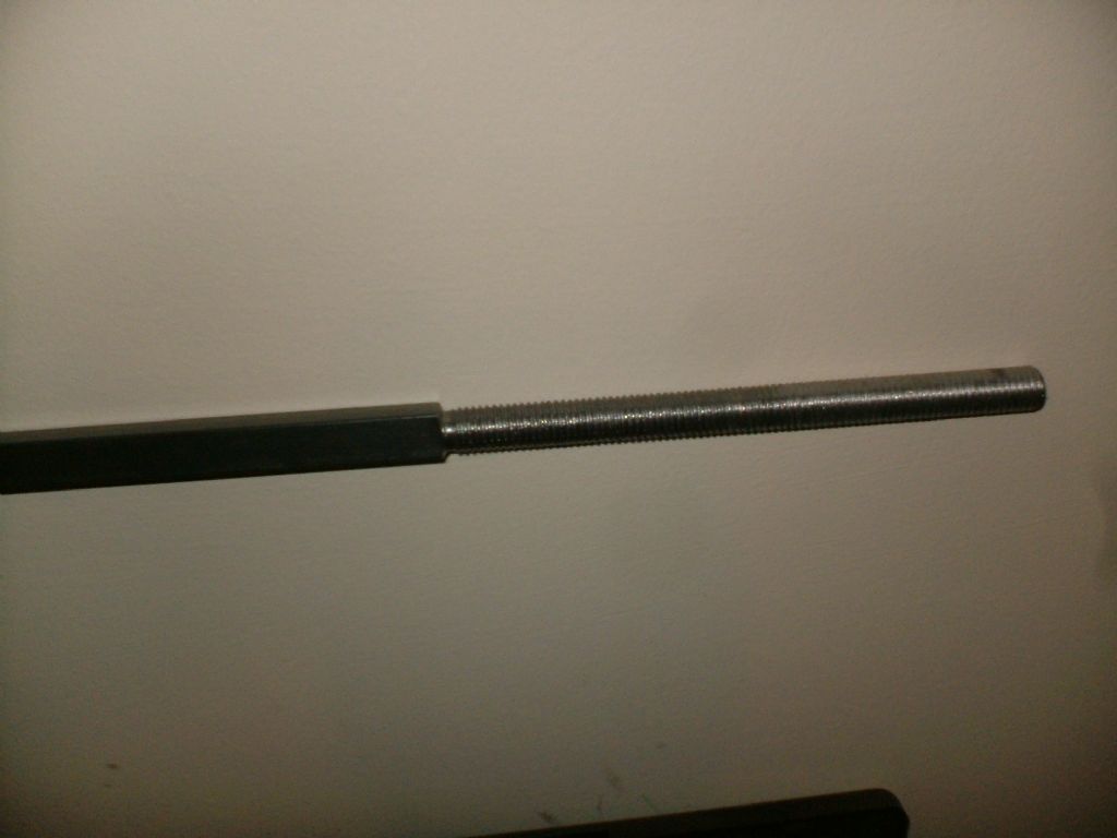

                              #102090
                              Ian S C
                                @iansc
                                You really need a fairly heavy die, say 2" split button die, so you can put some real weight into it, and try and take it down in one cut to get round the problem of work hardening. As others have said mild steel is quite addequate, after all it only just gets nipped up. I'v got one that I made by cutting the heads off two bolts, and welding them together, even with my welding its held together for the last twenty years. The other draw bar, a comercial one is quite hard, and is blued, not a pair of rusty bolts, but its just as good, cost two old bolts, time cutting the heads off, welding, put a washer and nut on the top end, all done. Ian S C
                                #102091
                                Ady1
                                  @ady1
                                  I'm doing the ends of a 39 inch square bar at the minit
                                  Cutting most of it on the lathe leaves the die to only finish the job off
                                  This one is finished
                                  This one needs the die to run up it
                                  It takes a bit of figuring out but saves a bucketload of hassle once you suss it out, concentricity is automatic and most of the material(and hard work) is removed on the lathe
                                  You will have additional issues using stainless which is not a user friendly material
                                  You've kind of pushed yourself too far if you haven't done it before, running before you can walk
                                  If I was you I would just buy a length of 12mm threaded rod for a tenner from B+Q

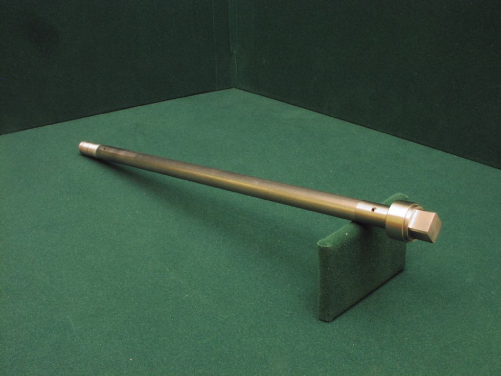

                                    #102136
                                    mark reeve
                                      @markreeve78288
                                      Hi all,
                                      Thanks for the multitude of suggestions. It is amazing what you can learn in a short space of time and this makes being a member so worthwhile.
                                      In the end I opted for Jeff’s and Ian’s suggestion of cutting the head off an M12 bolt, but rather than weld it, I turned a spigot on the end and press fitted this into the original piece of 12mm stainless steel bar that I was struggling to thread. I cross-pinned these parts together.
                                      I had already machined the head cap and press fitted this onto the other end of the bar and cross-pinned it. (The result is shown in the photo)
                                      Thanks also to Ady1 for his comments re using my imperial lathe to cut metric threads. I shall be following up on that suggestion, for future projects.
                                      Appreciating that there are many other and quicker ways of making a drawbar, my main aim was to get some practice on the lathe and mill, whilst at the same time making something useful and reasonably aesthetic. The stainless steel was FOC and machined well with carbide tools, but I will avoid it in future, where threads are concerned.
                                      Kind regards
                                      Mark
                                      Drawbar
                                      #102139
                                      Ian S C
                                        @iansc
                                        Mark, that should do the job. Normally a draw bar has a thread at each end, the bottom one is screwed into the tool, the top onehas two nutsthe bottom one is for tensioning the rod, the top one is pinned (it becomes a bolt head), is used for screwing the bottom thread into the tool. There, clear as mud. Ian S C
                                        #102148
