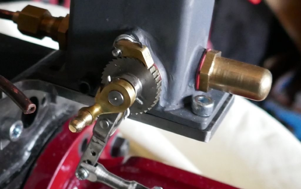

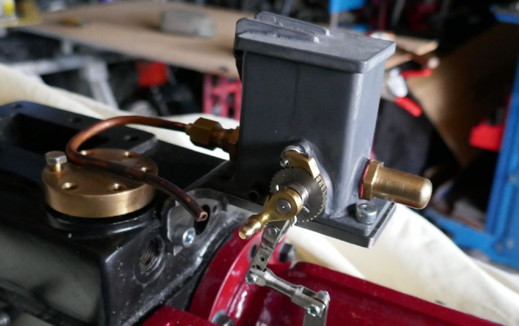

      Hi guys.
      I am attempting to finish my 5" gauge Emma Victoria but on the point of admitting defeat on the mechanical lubricator.
      Made all the bits but finding it challenging to get the accuracy required, tiny pawls, springs, ratchet wheel, very fiddly,
      Got it all assembled but the pawls don't engage with the ratchet wheel properly, suspect I didn't mill the teeth deep enough and/or not got the correct tooth angle.
      So my question is, do you make your own or buy a proprietary one.
      Bill D.

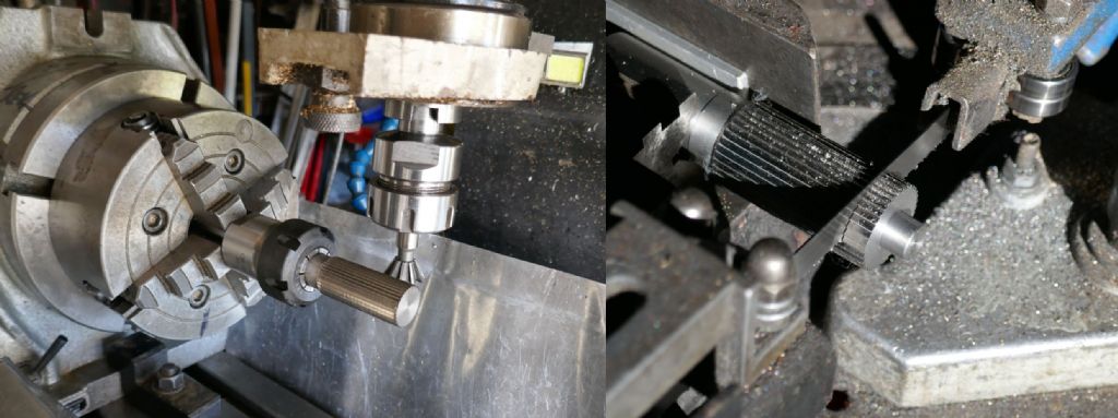

                  The ratchet wheel was machined much longer than required and a slice cut off to length (spares for next project or if it wears out). A dovetail milling cutter used to make the teeth.

                          Looks a nice job Paul, from pics appears to be a bit more substantial than mine which is bordering on swiss watch size components.
                          Thanks for info guys, I will leave it a few days to get my head round whether to remake the bits or buy one.

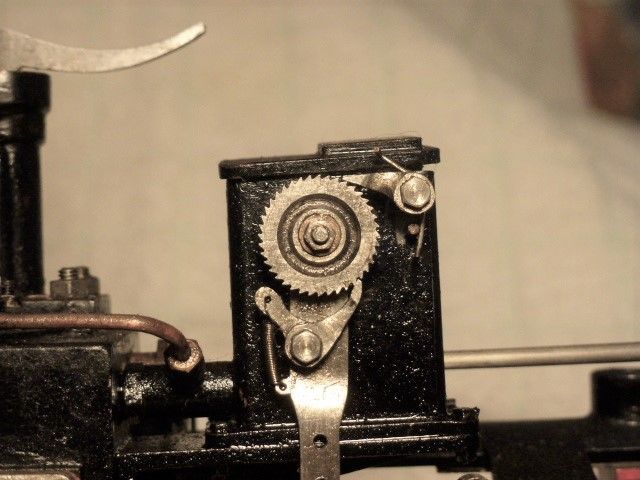

                              I've made my small lubricator ratchet wheels in the lathe. The process requires a means of indexing the chuck using, say, a change-wheel attached to the back-end of the mandrel and a plunger detent.
                              Turn the end of a piece of silver steel to the required diameter. Drill and partially part off. With the silver steel still in the chuck set up a suitably ground HSS tool at centre height in the tool-post and cut the ratchet teeth by traversing the lathe carriage as with a shaper and indexing for each tooth. Works very well giving accurate, well formed teeth for wheels of a range of diameters.
                              Finally part off and file or broach square centre hole then harden.
                              Didn't W. Hughes suggest this method for the Allchin?

                                  Here's a ratchet wheel made as I described above. It's 7/16" dia.allchin lubricator.jpg
