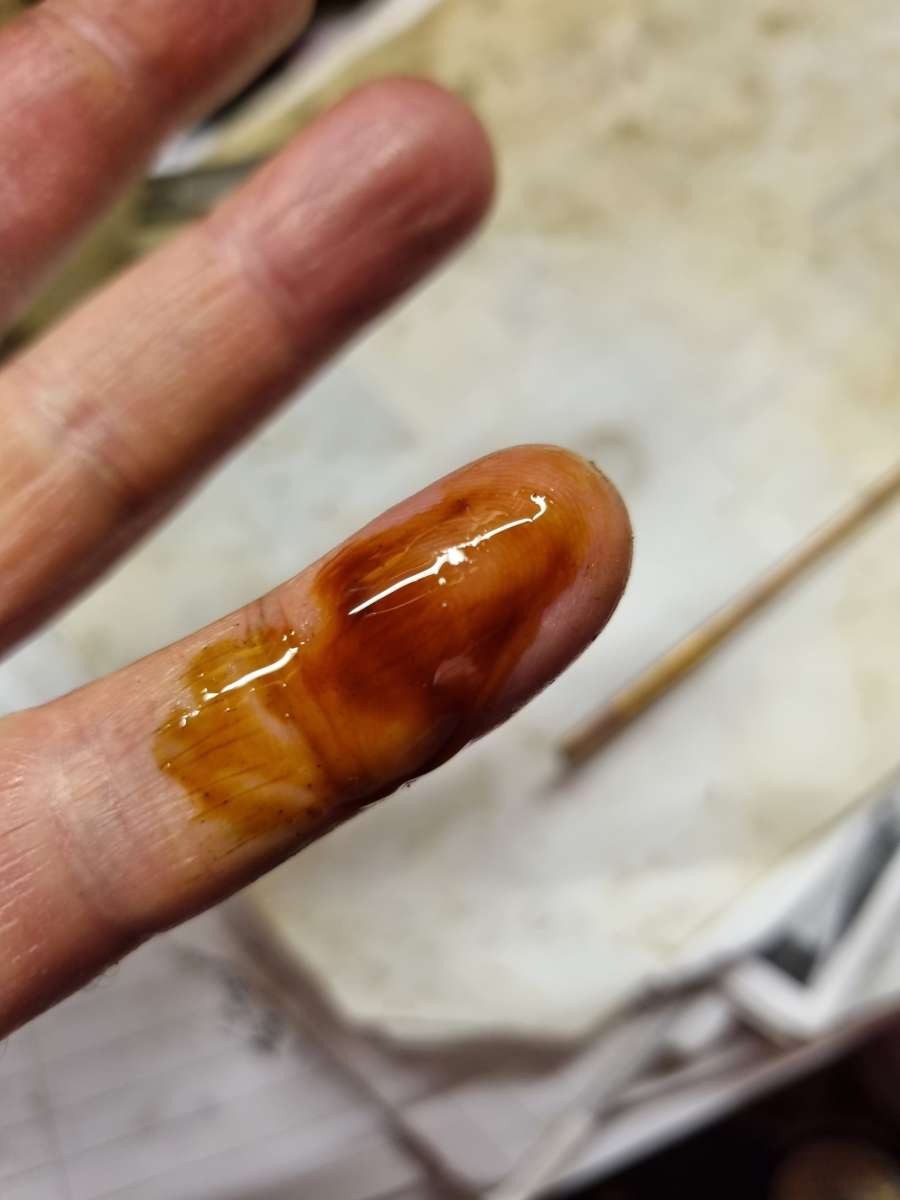

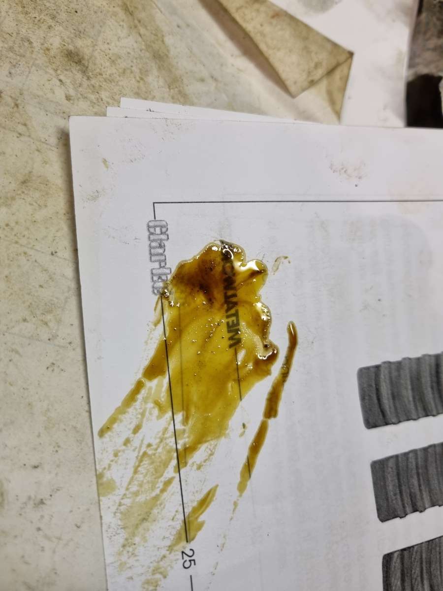

                                #791295
                                Danni Burns
                                  @danniburns84841
                                  Name that Oil?
                                  20250331_175346-min20250331_175543-min
                                  I got this out with a welding rod – access from the filler plug.
                                  I hoped for a distinctive smell (as per Noel above), but it wasn’t a strong or horrible smell. Maybe it smelled a little sour if anything – compared to some I had around (2 stroke, 68 slideway oil), which I thought smelled of nothing.
                                  cheers

                                    @davehalford22513
                                    Gear oil fortified with extra metal
