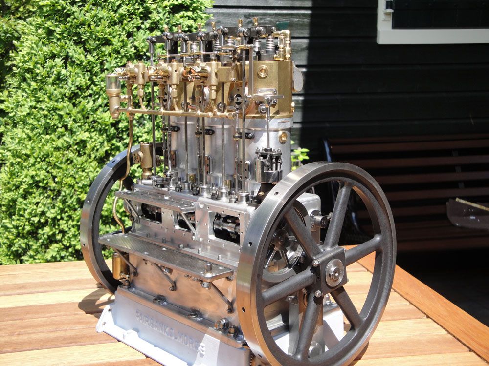

      Hello everyone,
      I am currently building a 3 cylinder Fairbanks- Morse type RE engine which is about ready to test.
      The prototype engine was intended to generate electricity so I am looking for a suitable generator. As the generator  is direct coupled to the engine crankshaft it only makes 500-600 RPM. I tested serveral DC moters but the best only generated 6 Volts and 2.5 Amps.  I also tested a motorcar alternator, which fits the engine perfect, but it starts to generate some power at 2000RPM.  I carefully removed the stator windings and replaced them with more turns of thinner wire. The result was that it self exited at 1000 RPM (still much to high ) give an exellent 12 Volts but hardley enough power to  light a small bulb.
      Is there anybody out there with some expierence?  Is it usefull to test a wheelchair motor or a big steppermotor?
      The ideal generator should give 12-14 Volts AC or DC and about 3 Amps. at 500-600 RPM

                          In the picture of the original engine shown (that being the Mount Wilson Observatory one), the generator overall is about 2/3 the size of the flywheel. At normal running speed the system generates 40kW @ 125v.DC from a 50HP engine, so I’m presuming that Johan has scaled his generator expectations accordingly. So whilst we really do need to know what scale it is, we already know from looking at the pictures and just guessing, that it’s going to require more than your average old car dynamo…
                          I’m also convinced that given Johan’s undoubted skills, he could probably make one now he knows what the issues are – which may well be the best answer.

                                      Been looking at the net for Fairbanks-Morse and found a few similar motors both full size and models.I noticed that some of them had a belt pully,it seemed to be about half the dia of the flywheels which would be about right to run a generator at say 2 or may be 3 times engine speed.
                                      A modern generator can be made to look like a vintage one.
                                      I see that you can get castings for models similar to this one in the USA, did you go this way Johan, or did you build it from scratch, its an interesting engine either way. The only Fairbanks- Morse engine I’v had anything to do with is a 3hp open crank hit and miss, I did’nt realise how big the company was/is ie., it was Americas’ biggest manufacturer until Henry Ford came along, not just engines they started by building scales. Ian S C
