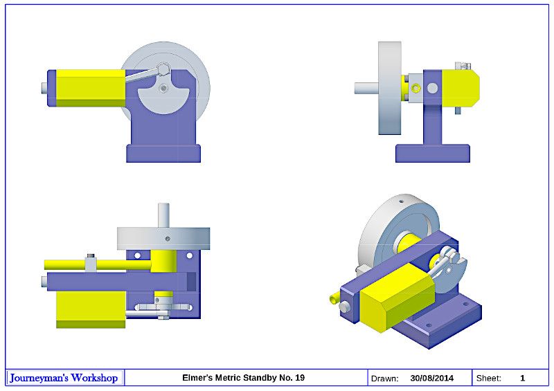

                                      Journeyman
                                        @journeyman
                                        My CAD tool of choice is Alibre, been using it for years. Not very good at it because I don't use it often enough. The Alibre Atom 3D referred to above might be a good choice, fitting between the seriously expensive paid for software and the 'free' software which may or may not remain free. Only drawback with many of these programs is they only work on Windows (how annoying is that) I think FreeCAD is one of the few exceptions.
                                        One of my efforts with Alibre above, this is a drawing page created from the 3D model. I also use the 'stl' output option in Alibre for 3D printing, very useful.
