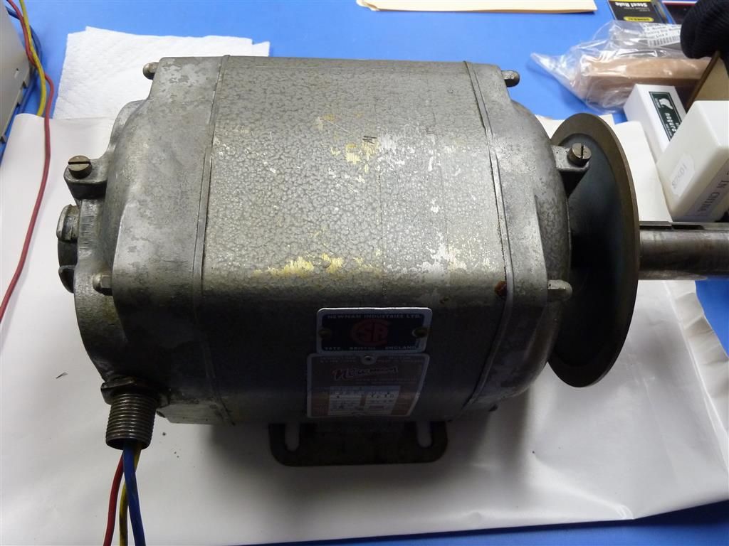

      Hello – I am looking for the electric motor dimensions / specifications for frame size of B234. This is not listed in any of the books that I have. I suspect it's from the early 60s or thereabouts.
      If anyone can help me out it would be much appreciated.

                #174543
                Steven Vine
                  @stevenvine79904
                  Hi Lewis
                  Can you post a photo of the motor, the name plate, and also show the B234 reference?
                  Steve
                  #174581
                  Lewis Cobb
                    @lewiscobb93613
                    Hi – Thanks for the feedback on this.
                    I'll be back with some pictures and nameplate info as soon as I get back to the house. I've got the motor completely disassembled, and hence, cannot easily take measurements – but I do have some pre-tear down pictures as well as one of the nameplate. It's not a big motor – maybe 1HP – 3phase. And if my memory serves me correctly (big if) it was made by a company "Newman" in Bristol,UK.
                    Stay tuned – I will be back hopefully later today.
                    Thanks again,
                    Lewis

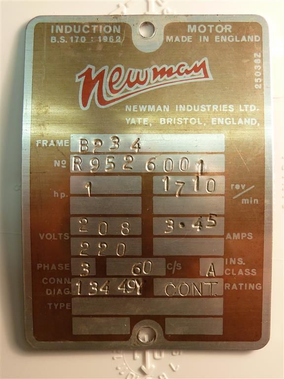

                        Lewis Cobb
                          @lewiscobb93613
                          Well, my attempts to link in a couple of pictures are not working. I will keep trying but in the meantime I will type out what's on the nameplate here –
                          Going from the top of the motor plate downward:
                          INDUCTION MOTOR
                          MADE IN ENGLAND
                          B.S.170 : 1962
                          Newman Industries Ltd.
                          Yate, Bristol, England
                          Frame: B234
                          No.: R952 6001
                          H.P.: 1
                          Rev/Min: 1710
                          Volts: 208 / 220
                          Amps: 3.45
                          Phase: 3
                          C/S: 60
                          Ins. Class: A
                          Conn. Diag.: 134 49Y
                          Rating: Cont.
                          One more thing that's noteworthy here – you will notice that the cycles per second is 60 and not 50. This motor comes off a machine that was built in the UK for the North American market. It did not end up back in the UK – I am in Canada
                          wink
                          Hopefully this information may lead us down a few paths with someone on here.

                          #174601
                          Raymond Anderson
                            @raymondanderson34407
                            Hello Lewis,
                            The only ref to frame B234 I can find all appear to signify a frame size of 56, and most of them appear to be for pump motors for pools ect. So I dont think frame B234 refers to the size, maybe the style but It would appear not to relate to the size.
                            Incidentally all the info seems to be for mercan motors [which ties in with your info, re frequency ]
