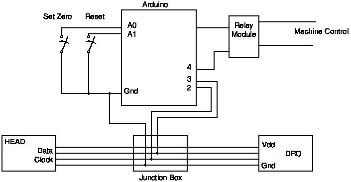

                        Just a few thoughts about what an Arduino solution might look like:
                        The idea is an Arduino taps into the data stream being sent by the sensor head to the DRO, and implements the stop as a separate unit by cutting power to the machine, shown above being done by a relay, but other methods available.
                        I believe all DROs communicate with 4 wires, positive & negative volts, plus data and clock signals, often with a USB plug. The wiring and voltages depend on the DRO, and it varies: might need logic level conversion.
                        The Arduino reads the data. Zero is set by pressing a button which records heads current position. The relay is triggered when the head reaches that point again, or gets close to it. Pressing reset restarts the machine.
                        The controls need more thought!!! At least one other switch is needed to activate and deactivate the stop and it would be sensible to show if the stop is active or not with a LED.
                        Other hard part is decoding the data stream; this is encoded in various ways – binary, BCD, 2s-Complement, quadrature etc. Depends on the make and model of the DRO, so research needed.
                        #542647
                        duncan webster 1
                          @duncanwebster1
                          That's pretty much what I had, I used a pair of decoder chips twixt the JB and the Arduino to read the RS432(?). I think I could have done it in software, but for less computer savvy people like me the hardware solution was easier
