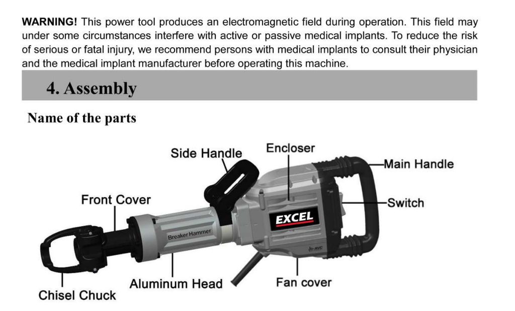

                  Here’s an interesting snippet from Excel’s Handling Instructions:
                  As the very satisfied user of a three-wire pacemaker, I know that attempting to obtain anything other than ‘broad-brush’ advice on such matters is futile.
                  The likelihood of this particular electric motor interfering with my device does seem trivially small, and I have to wonder how its field strength compares with that on an Electric ‘Bus [public transport].

                    The EXCEL model, as shown in the post above, looks like it should do the job.

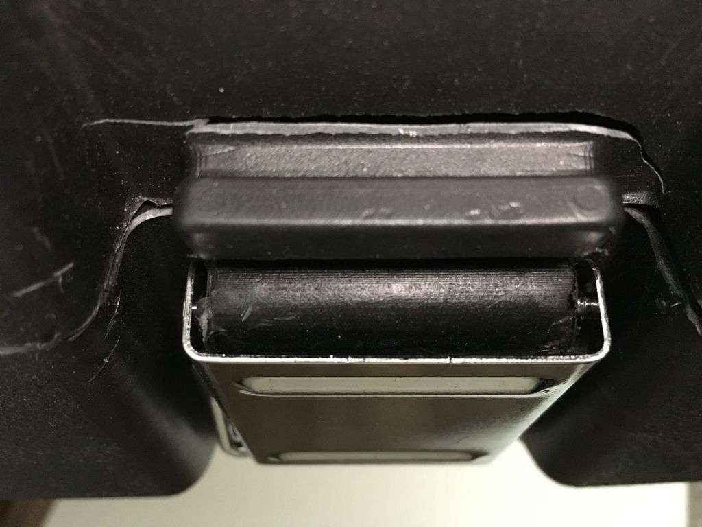

                            On opening the carton, first impressions were excellent; a blow-moulded case, with wheels !
                            Unfortunately, this is obviously not up to the job … one of the catches doesn’t work, because the plastic has split in transport.
                            I have written to the supplier, in the hope that they can send a replacement case.
