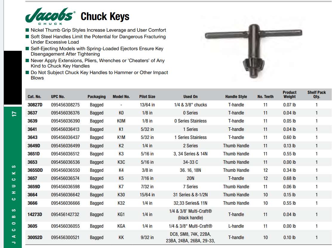

      I’m looking for a Rohm S10 key with 7mm spigot , they are rare as the usual one is 6mm , has anyone got this key that fits nothing hanging about in a drawer ?  I have the one old model of Makita angle drill that uses it .

        Could you find one with a larger pin and turn it down, alternatively is there a Jacobs one which could be modified?
        What chuck is it for?

        #714390

            Both peak4 and Jason’s ideas are valid, providing the teeth mesh correctly.  A tricky one until the spigot has been modified either way.

                    As suggested, turn down the 6 mm spigot to 5 mm and fit a sleeve which can THEN be turned down to 7 mm, (still only 1 mm wall).
                    OR if you can find a key where the gear is suitable, but with a larger spigot, turn than down to 7 mm
