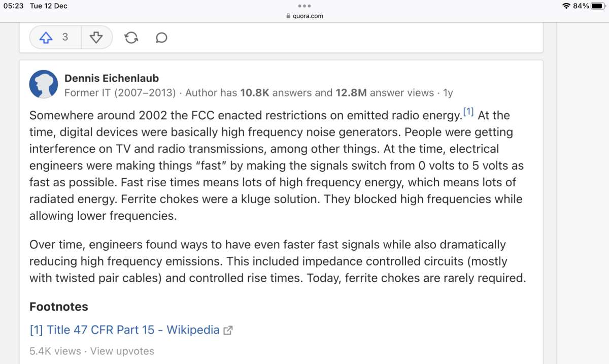

            #698721
              Regarding the monstrously large  clip-on Ferrite:
              I have just found this
              https://www.quora.com/Do-USB-cables-really-need-ferrite-chokes
              … and am somewhat comforted
              IMG_9128

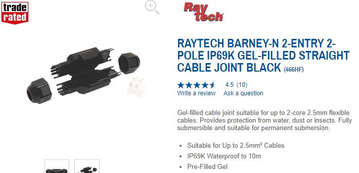

                                              #699908
                                              peak4
                                                @peak4
                                                Whilst I appreciate it’s cheaper, look up Raytech Gel as an alternative to bathroom sealant.
                                                There are other makes and suppliers available; I used it for re-potting my car reversing camera when I made a workshop magnifying display.
                                                It comes as either a two-pack or ready installed in boxes such as this one
