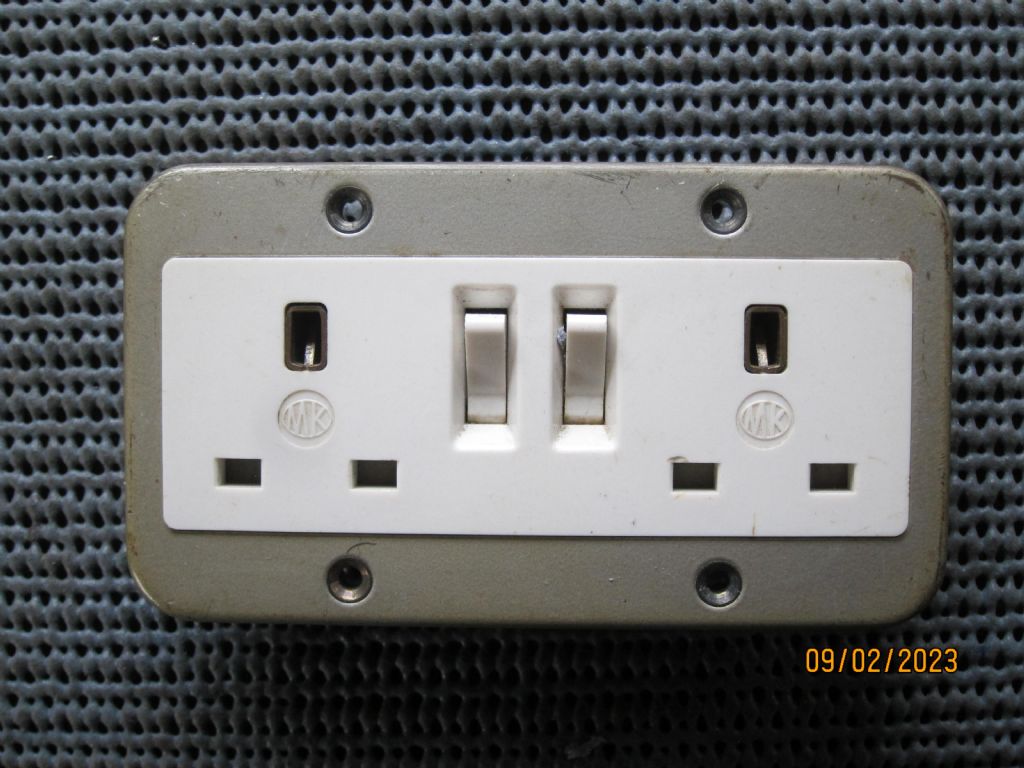

      Anyone know (or may even have one available) a source of a top and bottom 4-Hole metal pattress box to fit the twin 13A MK socket shown in the photo. Most commonly available boxes these days, metal or plastic are for two hole fixings mounted along the sides. Do not like the idea of throwing out a perfectly good item which imo was made to a much higher standard than similar items marketed today.

          Would it mount on a pair of sideways single pattresses? Or maybe one of these, example is Toolstation
          Not sure MK did anyone any favours when they designed that. The layout may be deliberately non-standard to stop light-fingered employees nicking them. There are a few variants:
          Some at work had vertical live and neutral rectangular holes rather than horizontal.
          #632735
          Greensands
            @greensands
            The Toolstation option is a thought but the centre section would need to come out. Would also need to check the hole centres.

                That's a socket from the MK metalclad range and the box to fit is smaller than a metalbox designed for mouning a socket flush in a wall. The correct  box is the same shape as the socket with round coners and is pressed steel.

                  You could make some suitable pillars and mount them in a standard box. You may have to add a frame to ensure there is no gap around the edge.

                    The Toolstation one will not work. Twin single gang is larger than one double gang.
                    Pay good attention to the caution from Engine Builder, but verify the truth of what he says by testing the socket you have on a double backbox to make sure the radiused corners do not underhang.
                    The art deco emporium kit is just a very expensive version of these:
                    https://www.cityplumbing.co.uk/p/back-box-repair-clip-pack-of-5-bbrc1444/p/638067
                    The key search term is 'back box repair clip'. They fit a standard double backbox.

                      Engine Builder is correct. It requires a surface mount box from the MK metalclad range, if they still do them.

                        You could weld 2 singles together to get the right screw spacing, but you will probably still get get gaps at the four corners.

                          Does the white bit remove easily from the metal surround?
                          If so, buy one of these:
                          https://www.cef.co.uk/catalogue/products/114579-2-gang-blank-plate-metal-clad
                          cut a suitable hole in it and for £1.50 you have a double socket socket that will fit a modern backbox.

                            Those sockets went out many years ago as said by others, my choice would be to cut an aperture in the lid of an adaptable box and fit the socket with screws and nuts to the lid, then connect in the usual way.
                            When purchased the socket would have usually been mounted on a metal box to the plate dimensions although there was an option to buy the bare socket for fitting to your own equipment, a metal frame was available that had the 4 fixing points tapped and the frame was fitted behind the cut out aperture.
                            box on eBay 263712560450 may not be long enough but otherwise suitable 141x81x39.5mm (Plastic)
                            Metal eBay 181302507015

                                If you are that bothered about reusing it and a metal worker why not get a current 2 lug one and silver solder on 4 mounting lugs to suit the old layout.
                                Myself I doubt I would bother and just get a new one which with far less plastic on the front offers more resistance to damage that that old design which is the reason why Metclad are used in garages and workshops.

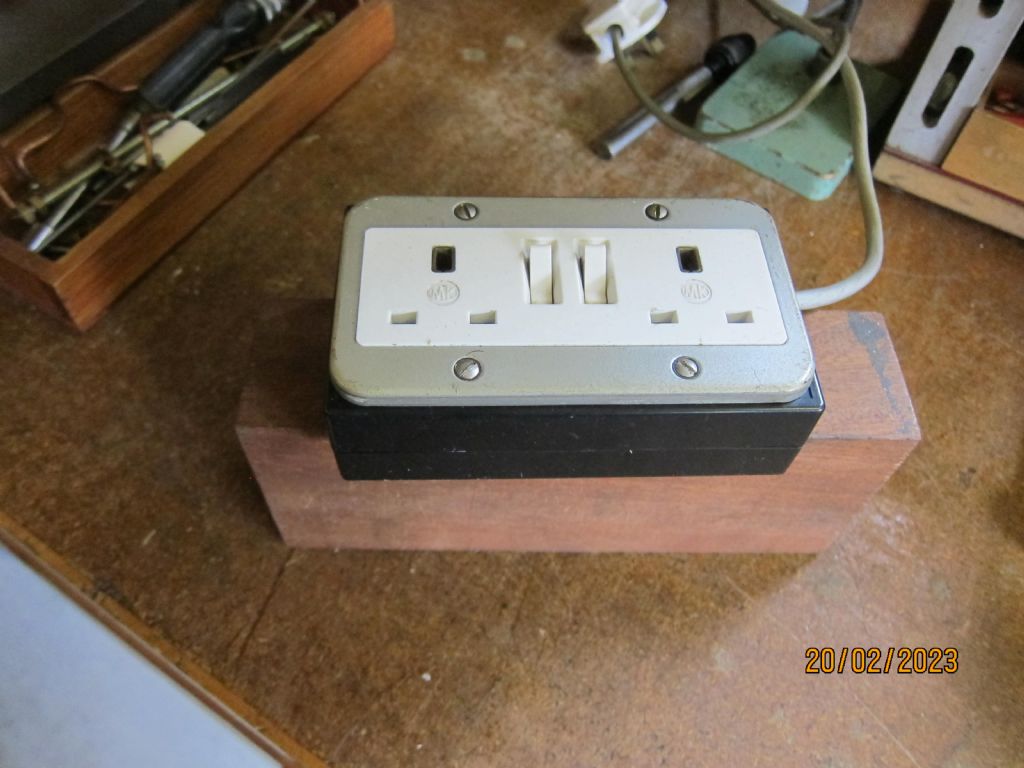

                                          Problem now sorted having bought the plastic box suggrested by Emgee. The modification required a lot of time which I dare say others would have considered as wasted time but have achieved a presentable result which does look far neater on the bench than the previously old domestic model ever looked. Thanks to all those who provided assistance.
