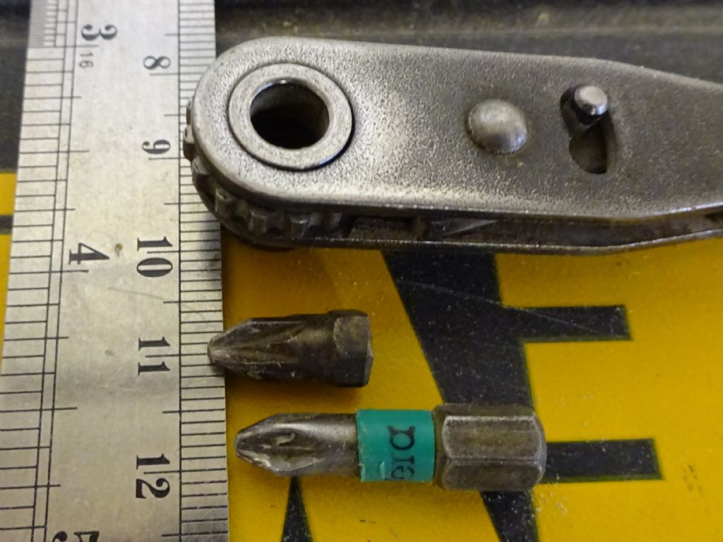

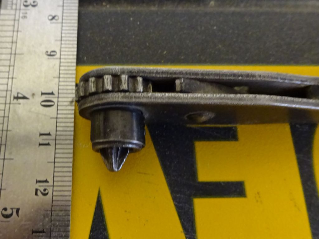

      The second one I linked to avoids this too.
      Its also the same ratchet that I linked to in my first reply once taken out of the plastic holdersmile p with the bonus of being a little thinner than the one with the 1/4" sq drive sticking out the back.
      For really tight spots I also keep a couple of cut down hex bits, don't get used much but have got me out of problems in the past. Looks like the ratchet gets a fair bit of use by the way the black coating has polished off.

                  That pic of mine is 15mm back to tip of insert when cut down, pozi or allen key would make no difference. Still leaves space for a Vaughan mini wonderbar behind to apply pressure to keep the bit in the screw head though you should not need it with a hex screw.

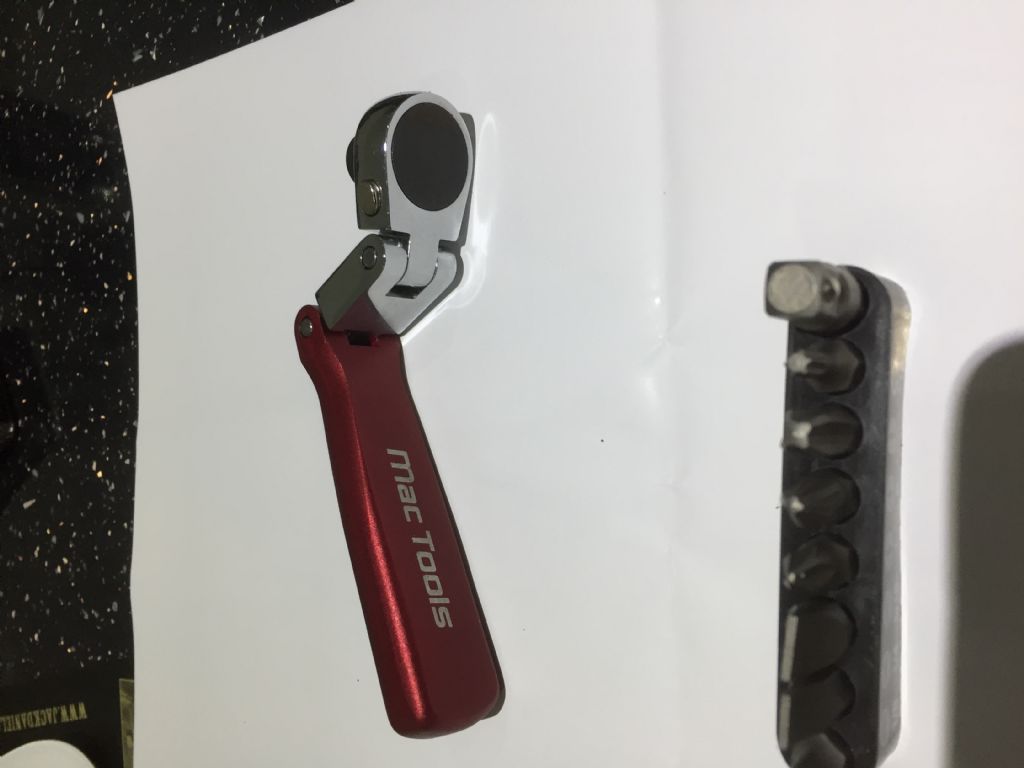

                        img_0162.jpgHi I use this one from Mac Tools quite often, I think it was about £25.00.
                        Bits are held in magnetically.
                        HTH

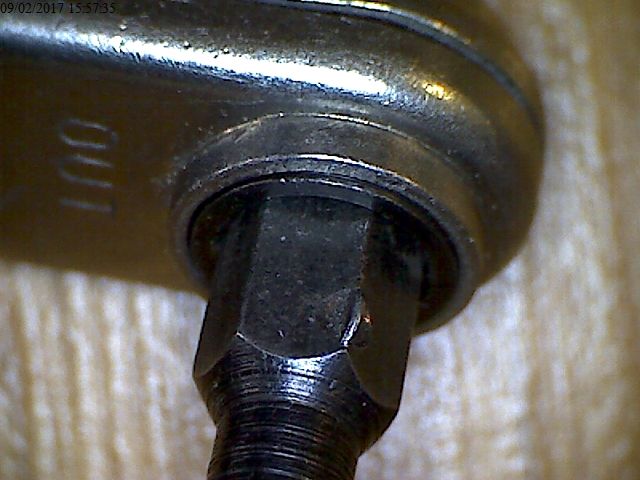

                          Hi John,
                          I have found my ratchet screwdriver. The bits are not quite standard. The hexagon is deformed to prevent it pushing through the hexagonal hole in the ratchet. It is made by the American company "Xcelite" and is model Xl-27
                          Here is a picture of the deformation on the hexagon that retains it.
                          Ratchet
                          You can buy this from Amazon but is rather expensive. (£20.51)
                          Les.

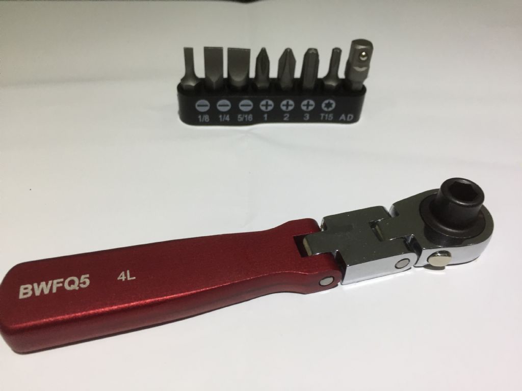

                              I have looked at both models in the past. The Teng one seems very similar to the Stanley one I linked to earlier, even down to the writing on the twisty bit of the ratchet.
                              I guess the Teng one may well be better made, and/or with better quality inserts, but for me personally, I like having 1/4" sockets at both ends, rather than 1/4" + 8mm (as per the Teng variety), as it lets me crack a tight fixing on the motorbike, before using the ratchet end.
                              Each to their own obviously, but maybe I'm a skinflint too at £15, with a few sockets thown in, as well as bits in a case, as opposed to about £30. I'm sure the added sockets aren't as good as Britool/Teng/Halfords Pro etc. I've only used them with this little ratchet and haven't broken them or rounded off any fixings (yet wink&nbsp
