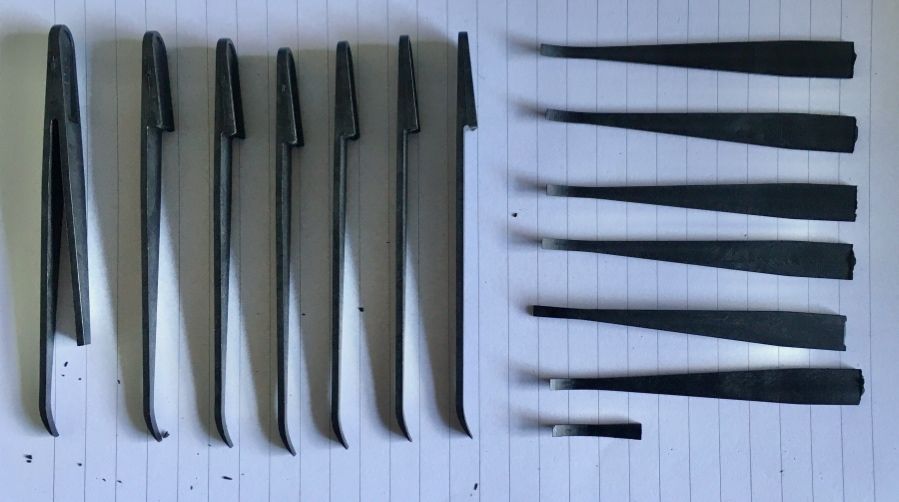

              A few months back, I bought some cheap ‘carbon fibre’ tweezers
              Most of then were broken when they arrived … presumably because the mailer that they were in had gone through the franking machine dont know
              Inspection showed them to be some sort of brittle plastic ‘reinforced’ with chopped-strand rovings of carbon fibre, in lengths too short to be useful.
              … the complete antithesis of a fully ‘engineered’ filament-wound product.
              Edit: __ Temus fugit !! this photo is a year old :
              Edited By Michael Gilligan on 07/11/2022 17:12:31

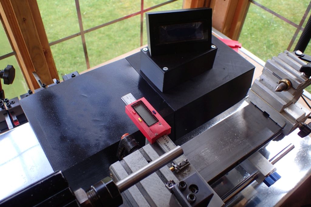

                          You only need the slider and the electronics. I used the bits from a set that the plastic case had broken, and 3D printed a replacement housing.
                          Works well as a cross-slide DRO.
                          PS Get a set that retain the zero when they switch off. The ones that reset to zero when you switch them back on are a pain as a DRO.
