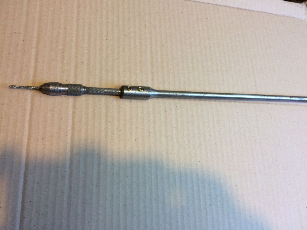

      I had an interesting problem the other day, Needed to drill a 1/16"hole down in a deep pocket. As per usual, I had the small drill mounted in a pin vice, but was still a few inches too short. racking my brain for a quick soloution, I mounted the pin vice into a Wood Bit Extender. Worked perfectly, perhaps a bit wobbly, but it did the job.

          Hi nothing wrong with using a wood bit extender if you have one, very good. If you havn't you can always use a piece of silver steel drill the end for drill size and loctite the drill in the end. You can always do the same for taps to tap down deep holes.

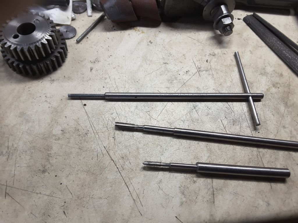

              Here's a couple of long taps I made recently. And an Allen key although the hexagon is tapped in to a slightly smaller than across points on hexagon only.
              4mm tap 5mm tap and 3mm hexagon key.

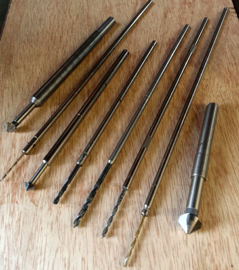

                These are some of the extended drills I have accumulated. Most of the extension material I get from rails and guides in discarded ink jet printers and drills or cutter is retained by whatever is convenient at the time. I've used grub screws, press fit, deformed the tube wall into notch or flat.
                Longest extension I have made was a 1.5m length of 1/2" diameter steel bar drilled to accept a 16mm wood flat-bit which I used to drill vertically downwards through the various noggins in a studded bedroom wall in order to run wiring to a new light switch without having to do any subsequent redecorating.
