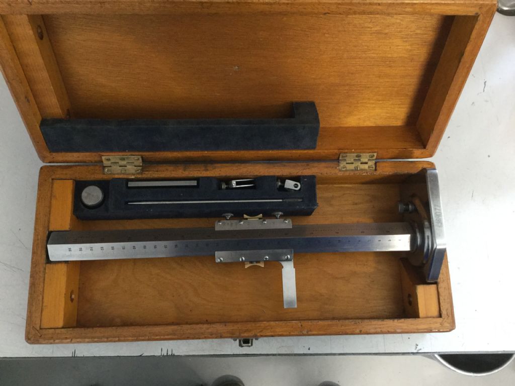

      Rather puzzling.
      I have the same height gauge in its fitted box with all accessories. The box and accessories differ from Bosun’s example. Mine has pretty much the accessories described in Stevegtr’s advert: a scribe, a depth probe, separate clamps for the scribe and probe, and a 1 1/2 inch height standard. All the accessories fit into vertical recesses, rather than cutouts. Does make one wonder if Bosun’s box is original.
      I'm pretty sure the box is original. While the blue elliptical label isn't in particularly good condition, you can definately make out Rabone & Chesterman around the bottom edge of it.

            Mike Crossfield
              @mikecrossfield92481
              Here’s a picture of my Chesterman gauge.
              Chesterman gauge 1

                Good morning,
                Thanks for all the suggestions. Regarding Robert Butler's suggestion of a test slip, I'm not sure I fully understand. Test slips appear to be 1.5" pillar shaped affairs. I do however, seem to be short of a test slip, unless the cranked scriber is supplied in lieu, enabling calibration straight from the reference surface.
                Not sure if it's relevant, but I contacted the seller, and apparently it belonged to a senior Marine Engineer who served in the forces between 1940 & 1950. It also bears what I assume to be an asset number 471-0315/7.

                  I'd favour the magnifier
                  #481048
                  Bo’sun
                    @bosun58570
                    I certainly wouldn't discount the idea of a magnifier (a good idea with my eyesight), but why the open end to the slot?
                    #481051
                    JA
                      @ja
                      I bought a very nice used Mitutoyo height gauge about 10 years ago which has an attached magnifying glass. Even with good eye sight I have to use the glass.
                      I would bet on a magnifying glass.

                        Posted by Bo'sun on 20/06/2020 11:43:40:
                        So the end sticks out to be grabbed, there are no finger holes (can't think of the name for those half round finger access points)
                        #481055
                        Clive Foster
                          @clivefoster55965
                          +1 for the magnifier.
                          Assuming the magnifier is like the one in Ian's picture an open end to slot will allow the stem to protrude a little making it easier to get out.
                          Alternatively its possible that there are some other magnifier mounting parts that hang down into the space below. Given the style of the rest of the box you might expect the part carrier block to be larger with positive support for any hanging parts but such enlargement might not have been possible whilst still leaving room for the sliding lid to open.
                          Clive

                                Thanks again everybody,
                                Looks like the vote goes to a magnifier. All I've got to do now is find one. While an original magnifier would be nice (if that's what goes in the recess of course), I guess I'll just have to keep my eyes open for a suitable one. It would have to be hand held, as there's nowhere to attach it to the slider.
                                Along with a magnifier, I'm on the lookout for a 1.5" calibration block. While I can sort of check zero with the cranked scriber set under the arm (1.0" for the scriber + 0.5" for the arm) against the reference surface, it's not ideal. If you're not very careful, you start jacking the base upwards.
