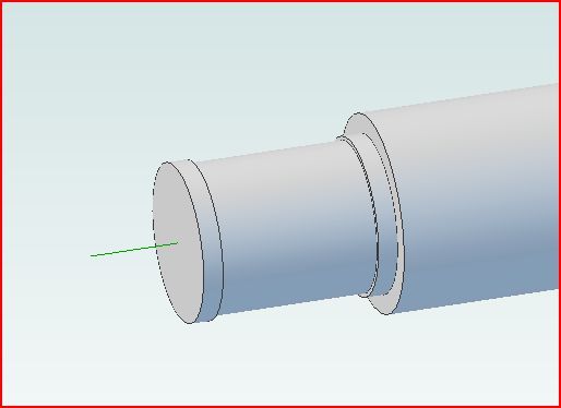

                  what is the cotton reel method?
                  #168203
                    Machine the central section of the axle spigot a thou or two smaller. Apply loctite to the spigot then when you press it into place the two full dia ends locate the wheel but the recess allows a space for the loctite. Also les sfriction so you can rotate wheel to right place
