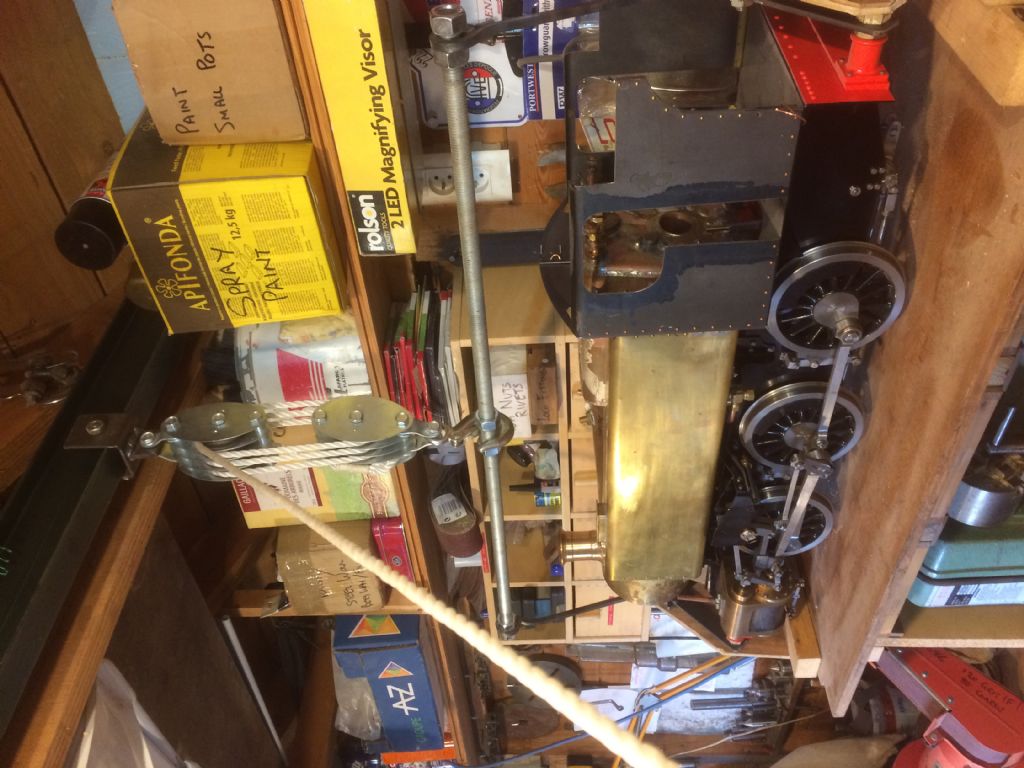

                    I have followed Bazyl's formula. The wooden bars can be positioned to :-
                    1/ clamp the loco down to the rails for transport, or
                    2/ lift the loco off the tracks for running in free air.
                    I have a length of 20mm all thread which bolts between the two ends. This has a couple of nuts either side of the C of G (which changes as to wether the loco is dry or filled with water). A block and tackle is used to lift the loco and frame off the bench and onto the garden trolley.
                    thanks Bazyl
                    Bob
