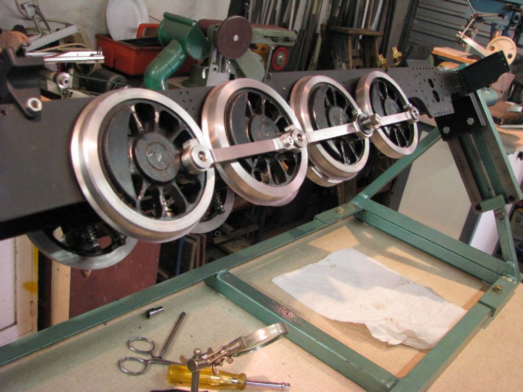

      Can anyone help me with details of  or direct me to artcles, maybe, for the construction of a locomtive stand suitable for a 5″ loco (Simplex) which I am building. I have got to the point now where it is too big and heavy to keep roling over on the workbench.
      If there is no actual article in ME I’m sure with some pictures and some advice from other who have made one then I could get on and make a suitable substantial stand.
      Any help greatly appreciated.

            Woofity
              @woofity
              This may be of help, I’m building a South African Railways Class 1in 1/12th scale and it’s getting to the stage where it’s too heavy to handle comfortably.  I copied the idea from a very experienced and helpful modeler in our club.
              Good luck

                #60592
                Deric
                  @deric
                  Thanks to those who  have responded, so far.
                  KWIL and _Paul_ … might have misinterpreted my needs and I’m hoping you might have another think and perhaps know what I’m looking for.
                  What I would call a ‘construction’ stand, one which I can fix my loco into, something along the lines of that which Woofity shows on the thread. I have seen some that grip the loco by the buffer beam at each end and the loco can rotated to gain access to the underside etc.. some I’ve seen also have raising and lowering screws at each end.
                   As I said before it’s getting too heavy and awkward now to keep rolling it over on the bench.
                  Colin, I did PM you to take you up on your offer, if the offer is still  open Iwould appreciate your input.

                  John Olsen
                    @johnolsen79199
                    Most of the building stands that I have seen have been purpose built, rather than adapted from something ready made, which would mean you will need welding gear. The ones with a worm gear to rotate the loco seem very elegant, so keep your eyes skinned for a good big worm and wheel. They do generally seem to attach onto the buffer beams at each end, which is a good strong point on the loco, however this does mean that once the boiler goes on the loco is not centred on the axis so the torque gets quite high.
                    Still, you think you have problems, try turning over a thirty foot (9.15 metre) steam launch, when the ceiling beams are only about 8 feet above the floor.
