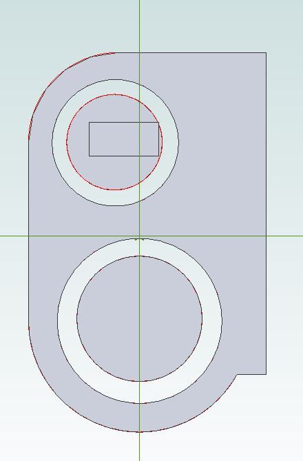

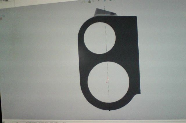

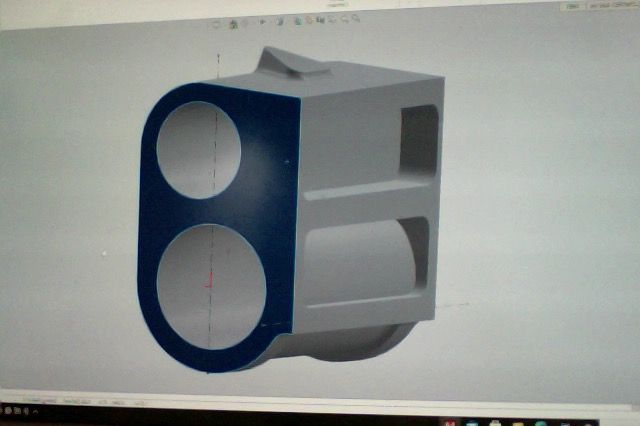

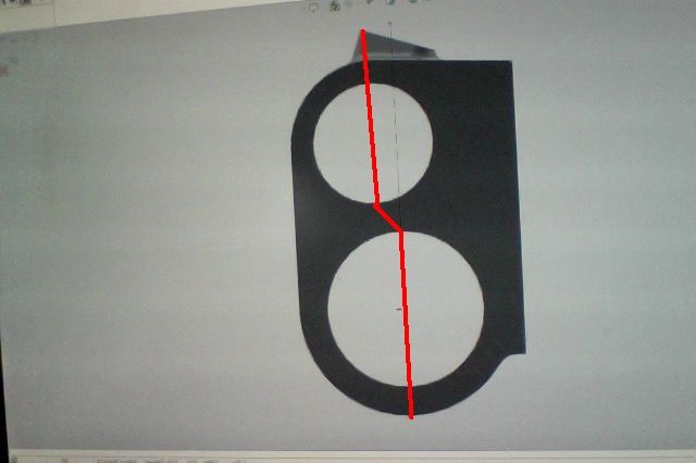

        Having seen so many casting articles in ME lately I have been doing a bit myself and below is a photo of the end of my CAD model for a Black 5. I was going to make a split pattern for sand casting with bosses where the bores are for core prints. Question is as the cylinder and valve bores are not inline I can't split the pattern through either bore so where do I split it to get it out of the sand?  Please ignore the bit at the top as this will also be re shaped to aid removal. Anyone got any ideas?
        Many Thanks.

          Do you need to cast the bores in? Could you leave one or both out of the casting process?

            HI Buffer, you need both cores if you don't want large risers to prevent draw. You can use a staggered split line. When ramming patterns with a non-uniform split line you place a little casting sand on the moulding board, dust then push the pattern into the sand and ram normally. Then with the other side of the pattern you remove the bottom sand and continue as normal (normally it just drops off when you lift the box).
            You going to need casting radii to prevent corner draw on those webs as well as a decent draft to get proper (tight) ramming in those pockets, otherwise you are going to get burn-on.

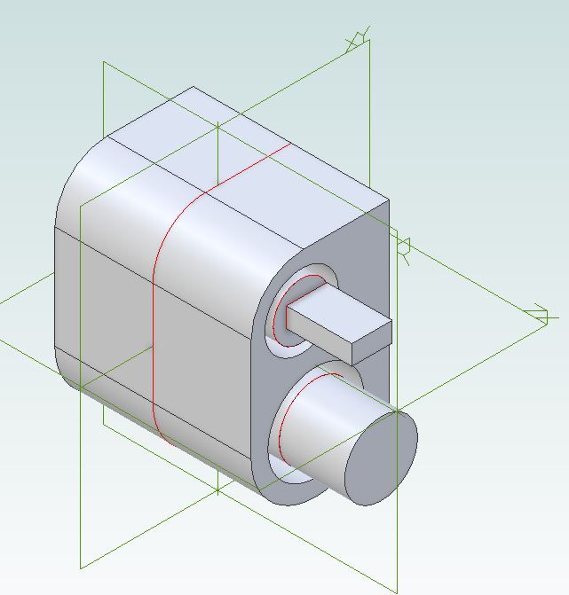

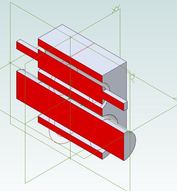

              Put the two coreprints on the same split line but make up a core box which has the core(s) offset from the part that goes into the print. I would do large cylinder with a parallel core and offset the smaller one. Should be cheaper this way if you are paying to have them done.

                  As Luker says pictures help, this is my method. One straight split line through middle of larger cylinder, rectangular print for small cylinder so core goes in the right way round

                    Jason, I sort of get your idea after an awful lot of looking at this wondering but I might not be fully there yet. It's really hard to try and imagine that model being a hole in a box of sand! So the boss on the end of the valve part of the cylinder has a rectangle on it to avoid the undercuts that would be at the 1 and 5 o'clock positions (top drawing where the red circle cuts the green line)?
                    Luker, can you tell me what sort of radius I should put on the corners and what sort of draft angle do you use, that's dead easy to change on the model? Do you increase your patterns for shrinkage? I was thinking of just giving myself an ample machining allowance all over. Where would you put the in and out gates or does it not matter too much? And lastly I was going to dig out your old article (always a good read by the way) on metal composition because the cylinders are available as iron or gunmetal at a whopping £395 for gunmetal. I think you're in South Africa so that's R7800 hence my interest in having a go myself. I have lots of scrap brass and I didn't know if brass cylinders would be any good or if not what's the chance of making a sort of gunmetal from my brass.

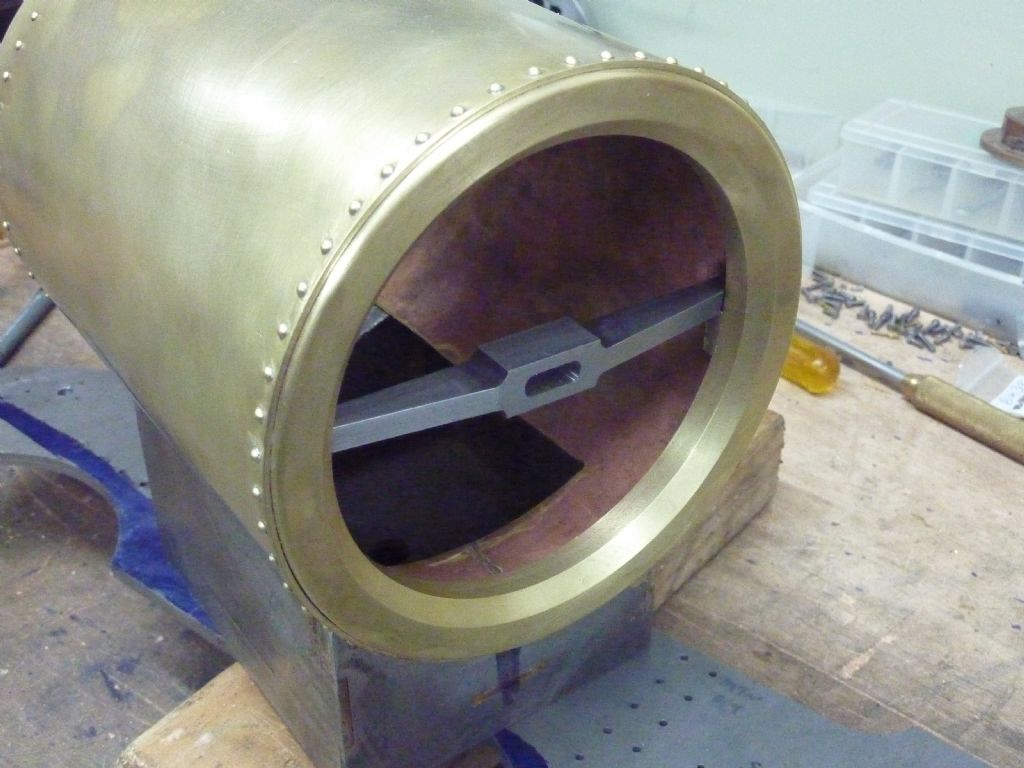

                    Anyway thanks again its all very much appreciated. I cast my smoke box rings recently from brass and they look superb now they're all machined up. I think it's fair to say that all the recent casting articles from Luker and others over the last couple of years are what got me to try this and the silly grin lasted for ages when this lump came out of the sand.

                            You only prop the pattern on the sand when ramming the bottom part of the pattern. This is to keep the draft angles correct relative to the split lines. When you flip the box and fit the top part of the pattern it all works out.
                            I can't comment on casting brass cylinders as I've never done that, but I expect they won't last as long as the bearing alloys or cast iron. I have mixed Gunmetal from brass but the amount of brass used is relatively small to get the required amount of Zink, you still need to add Tin and copper. I have made Alumina bronze, tin bronze, gunmetal and cast iron cylinders and all have worked really well. The cheapest is the cast iron and alumina bronze but you need to add silicone to the alumina bronze to improve machinability. Incidentally all my alloys are mixed from scrap, and when I had a few tested they were surprisingly within spec. As Noel says the shrinkage and radii depend on the material and size of casting. If that's a ¬2kg (5 gauge cylinder more or less) I would use 3mm in that pocket and 1.5-2mm radius everywhere else. 5Deg draft in the pocket will help with removing the pattern without knocking the sides, as Noels says 3Deg everywhere else (from your pic it looks like you're using green sand). As for the risers and ingates I wrote a program to work this out, if you send me the surface area, volume, alloy you intend to use and weight of the end casting I'll plug it into my solver and post a screen grab. If you give me an indication of what alloy you intend using I can give some guidance on dusting and what to add to the facing sand to improve finish.

                            The smokebox ring looks really good! Cylinders will be a breeze!
