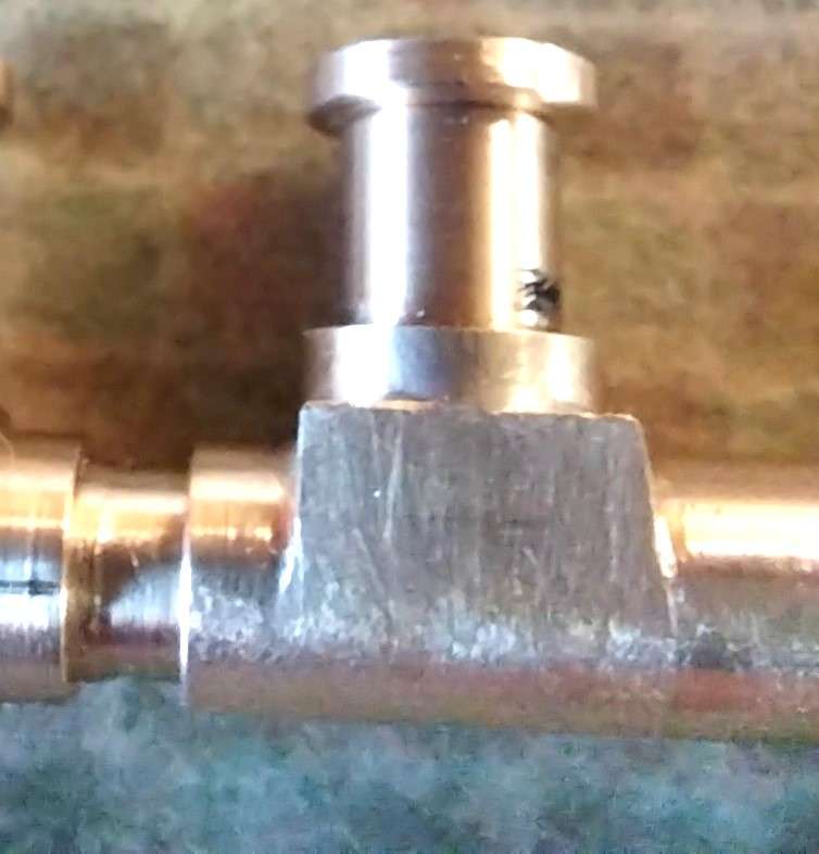

              On Emgee Said:
              Have 601 and 638, which will be best for 6mm diam pin in a 3mm deep blind hole CZ121 brass/brass joint ?
              Emgee
              Emgee’s requirement, simply stated as a deep blind hole, doesn’t give enough information, to differentiate between 601 and 638.  Both are intended for joining cylindrical parts.
              601 is low viscosity, can bridge a small gap, and takes a while to set.  It’s able to flow over surfaces, bridge small imperfections, and gives the operator some fiddle time – glues that grab are a right pain if any adjustments are needed!  This is probably what Emgee needs.
              638 is fast setting and thicker, so harder to apply evenly, very little fiddle time, and it can’t bridge imperfections.  It’s advantages are fast setting, which speeds up jobs that don’t have to be carefully aligned, a bit stronger than 601, and it resists shock loads and vibration.  Best of all it doesn’t mind oil in the joint, and can take more heat.  This combination suggests 638 is better for automotive work than 601.
              For home-workshop use, either will do. Noting Michael’s caveat about allowing room for excess liquid to escape when the pin is inserted, I vote 601, but I’d use 638 if that’s all I had.   Confession time, just securing pins in holes for ordinary purposes, I mainly use Super-glue.  Not as strong or heat resistant as a Loctite or other professional fastener.    When using super-glue the joint has to be proper clean, and the glue fresh.  Once opened, super-glue seems to quickly lose strength. As far as I can tell Pound Shop and expensive Brand-name super-glue should both be used asap.

                        Emgee
                          @emgee
                          On martin haysom Said:
                          read the spec ,do what it says ,work’s every time. must remember to do this myself. used a Loktite recently [ not at home so can’t check which one] spec says sets in 1/2 hour but full strength one week
                          I used the 638, should have said the pins are drilled through 1mm diam so air can escape on assembly. Finished pins shown here with a screw cap fitted.
                          Emgee
