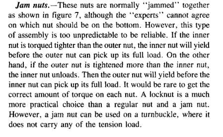

              NASA's Fastener Design Manual makes sense to me. (Thanks to Ches Green.) It says:
              • The 'experts' cannot agree on which nut should be on the bottom.
              • This type of assembly is too unpredictable to be reliable.
              • It's a bad way of locking a fastener and proper locknuts should be used instead.
              I suspect the Original Post explains why jamb nuts never work for me! The instructions require a thin nut to be tightened to a specified torque and then held so it can't turn whilst a thicker top nut is torqued down hard to a different value. Tightening the top nut has to be done precisely so the lower nut's threads transfer the load to their opposite flank, thus working in the opposite sense as the top nut to resist unwinding. Yuk! And it's not just a matter of applying a couple of spanners and hoping because the required torque, whatever it is, must depend on the material!

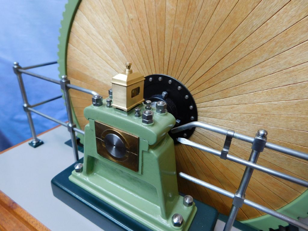

                          The practice of thin nut on top goes back many years,and was used on many of the engines we model or restore,in many designs the top cap just held the bearing halves in place and there was a gap between the bed plate and the bearing cap so the thick nut was NOT fully tightened,if tightened too much the iron casting snapped,and I have seen many of these welded or brazed,the thin nut was then tightened against the thick nut. The question is then why not just use two thick nuts, I can think of one example, the popular Amanco o/c farm engine did have two thick nuts on the main bearing cap studs ,though in this instance the cap nuts could be done up tighter as the bearing caps had shims under the cap ,Amanco were very good,production engineers so the reason for their bearing cap design was possibly ,two full size nuts meant only one part number,no assembly problems as it did not matter which nut went on first and ham fisted owners could pull the nuts up tight, and if pulled down tight why two nuts well it may be that customers expected to see two nuts. On the other hand Blackstone continuous lamp and hot bulb engines built up to the early 1920s only had one nut on each main bearing cap and its not that the lock nut got lost ,the studs were not long enough to take a lock nut. On big ends , again some caps pulled up tight others just pulled the bearing shells together though the pulled up tight caps were more popular,here again it was full nut and half nut plus a split pin,though by the 1920s threads changed from coarse to fine, and single castellated nuts with split pins came into common use,and as Ramon mentions bolts holding engines down just had single nuts,I once owned a 21/2 ton hot bulb portable and the bolts holding the engine bed to the girder chassis were whit and only single nuts despite the rough ride portable engines got when being pulled along rough roads, the only fastener that I found loose on that massive chassis was an iron rivet.I have read lots of discussions over the years on the lock nut position, i have never seen a lock nut under a full nut though I put this down to to never having been involved in industries requiring such fittings, I gather that the applications are highly stressed,and use very high tensile materials, which are far different to a century earlier where the small nut on top was adquate for the application,and materials of the time.so if you are modelling or restoring old machinery engines etc put the thin nut on top.

                                As also said, for me the technical aspects are one thing, the model making aspects are another – BA bolts, nuts, even with the smaller head are not usually of true scale appearance compared to those in these images for instance.

                                  Agreed, but did anyone notice the point I lifted earlier from NASA's modern advice on the subject? It's that locking with two nuts isn't a good idea! Either way round. Difficult to get the torque right and vibration tends to shake the nuts loose. Looks good and is practical enough on a slow running marine or fixed steam engine, but extremely unwise on an IC engine or anything else that vibrates quickly.
                                  For that reason, lots of more positive locking methods were developed over the last 150 years: split pins, wires, nylon inserts, serrated flanges, deforming threads, adhesives, tabs and castle nuts etc. Two jambed nuts are simple and cheap, but are otherwise best avoided.
