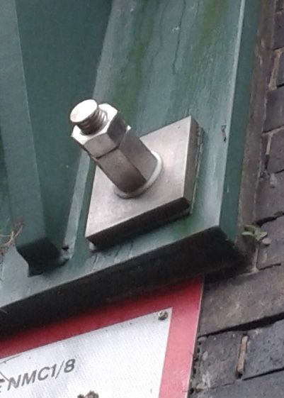

                              Nipping back a couple of years, to the thread that I linked last night … I have an hypothesis:
                              The long nut is being used because it provides a long ‘bearing’ and keeps the load axial
                              … a shorter nut in that position would cant over; introducing stress concentration in areas of the thread, and localised loading at the nut/washer interface.
