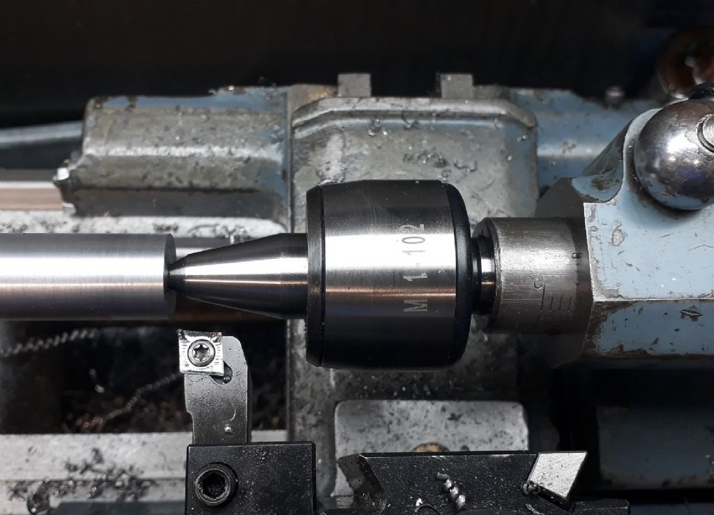

        I'm in the market for a new live centre for my Boxford. I have a big crusty old one that came with the lathe but it has a big body and a short point so it's always in the way of the tool. I have a slim body cheapy but I discovered that that is now all wibbly wobbly and causing chatter so I'm looking for something better. I quite fancy one with the long profiled nose, APT have a couple of contenders on sale at the moment but I'd welcome any recommendations before I spend.

          Tony Pratt 1
            @tonypratt1
            Just had a quick look at APT & the good news is they quote a TIR so their product would have to meet that easily checkable spec, other sites just quote 'precision' with no figures to guide you, also stub point should be more rigid as they are shorter.

            #552895
            not done it yet
              @notdoneityet
              something better
              1) Can it be repaired with possibly far better bearings (thinking here of replacing chinese carp)?
              2) Spend more on a replacement?
              3) Buy one that can be refurbished.

                I notice that APT sell a more expensive range intended for production use, and the red ring looks a lot like Rohm German made. The standard type are plenty good enough for hobby use, the extended nose is a boon when turning smaller diameter work.

                  I really like the look of the Heavy Duty one with the profiled point but will probably go for the standard series with the extended point.

                    In conclusion, I ordered a "Precision Live Centre Morse Taper 2 Extended Point Standard Series" from APT. Arrived next day and quite happy so far. Solved the chatter problem I was having and no runout I can measure. The body is quite chunky, 45mm diameter, but the long point gives good tool access.
