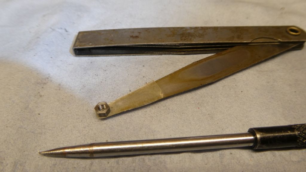

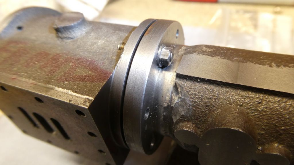

      Having tried for far to long to get this 6BA nut started on its stud I gave up and asked my wife with her smaller fingers to have a go. She persevered for fifteen minutes or so but finally admitted defeat.
      I tried a number of different methods including jamming the nut up a small piece of plastic pipe and using it as a flexible box spanner but the wall of the pipe was to thick and fouled on the raised rectangular sticky out thing on the casting.
      The last thing I tried was to stick a piece of double sided tape to the end of a 40 thou feeler blade and stick the nut on the end. Now I was able to offer up the nut to the start of the stud thread. With the point of a scriber I gave the nut a twiddle or two and bingo, it went on.
      I like it when things finally go right!

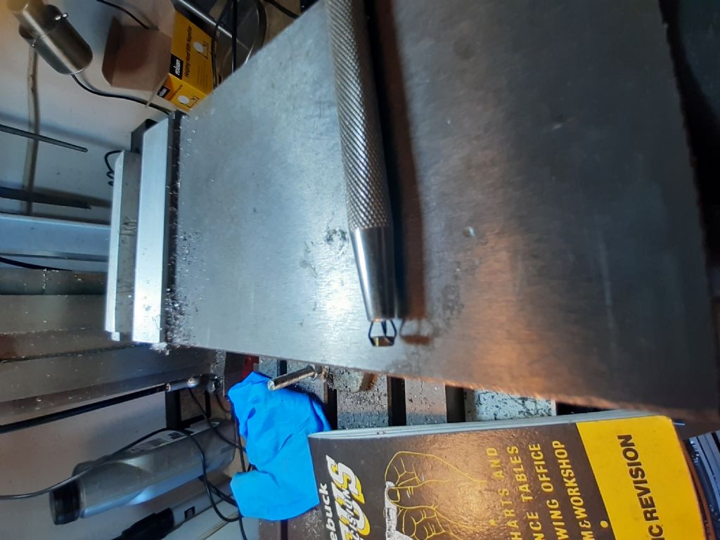

                        I have big arthritic fingers, and when I modified the new 100mm four jaw chuck to fit my 7 X 12 lathe, I turned the first few threads off the mounting bolts to make life easier.

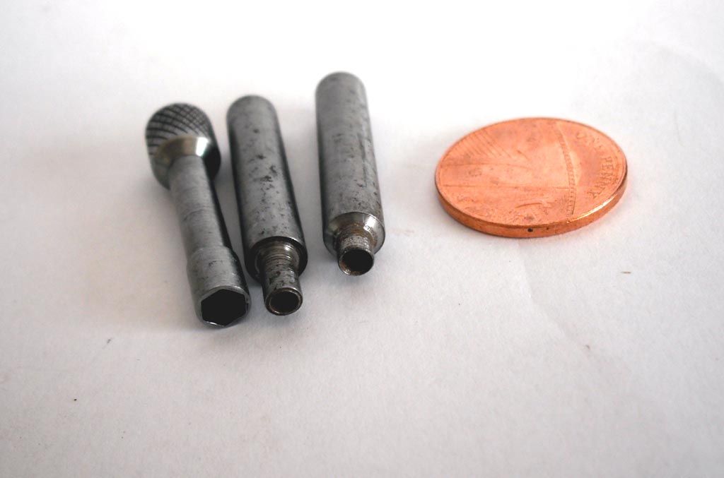

                                        I solved the problem by making some miniature nut runners for 8, 10 and 12 BA sizes. Drill a hole the same size as the AF nut or bolt size and then knock in the end of a suitably sized hex key as a crude broach.

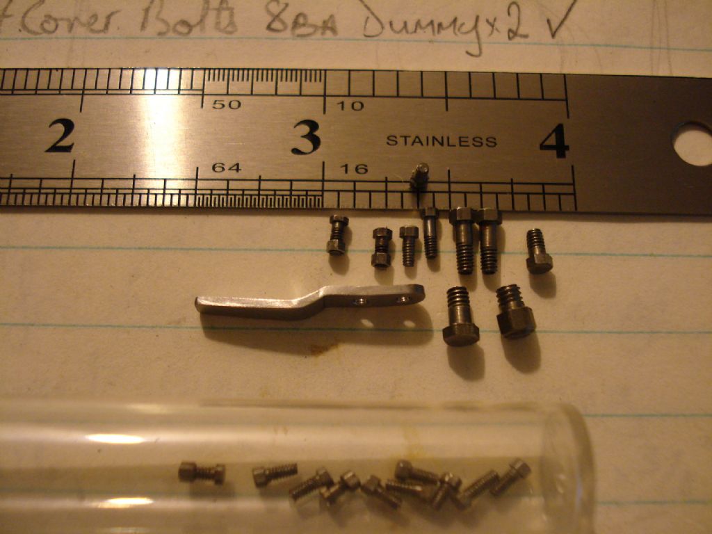

                                                    Hi I use a lot of BA nuts, mostly 5,6, and 8, and even down to 10 & 12. .. (Yes 10 & 12 are a little harder, but OK)
                                                    So what I do, is I lick my finger, and add the washer on, then link my finger again and add the nut on, then roll my my finger over the nut. It usually works OK, then tighten with a tube spanner, but don't use too much pressure when tightening.
                                                    Leslie.
                                                    PS.  Just think of watch makers they go from 12 downwards?   …   BA  is the Thury Thread, and they go right down to No.25
