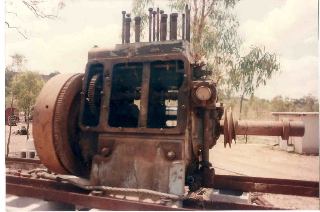

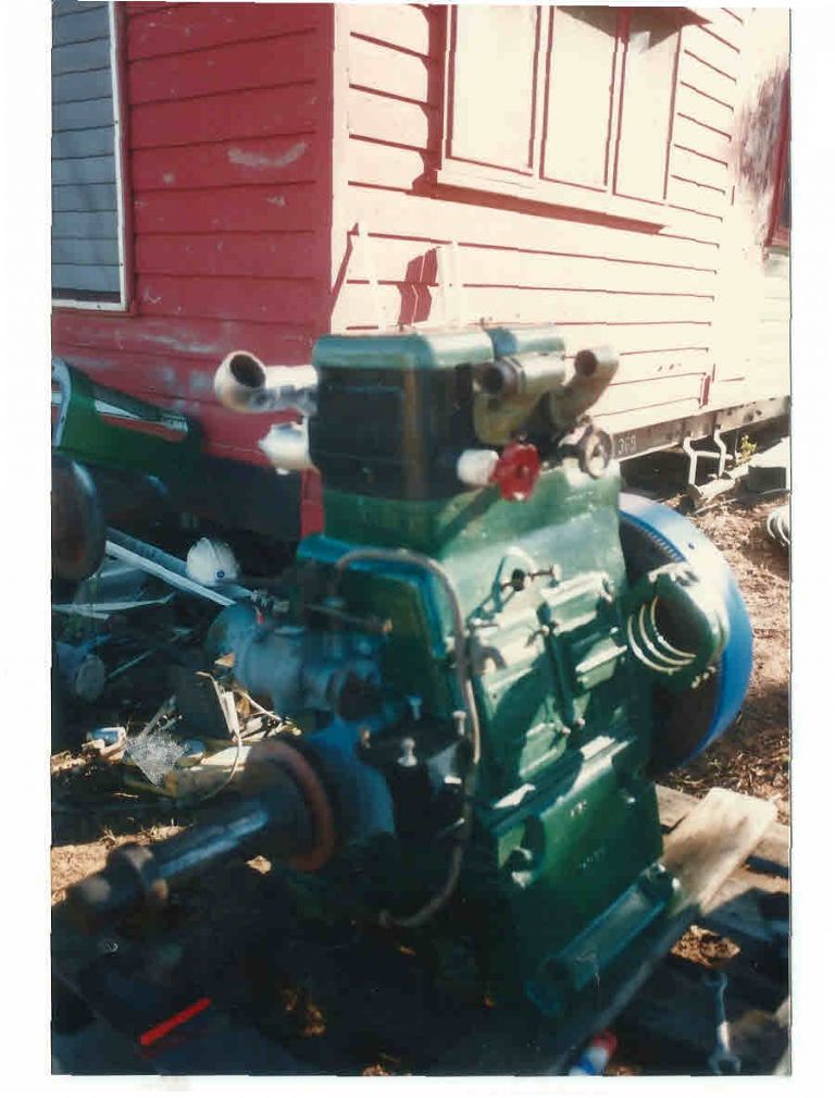

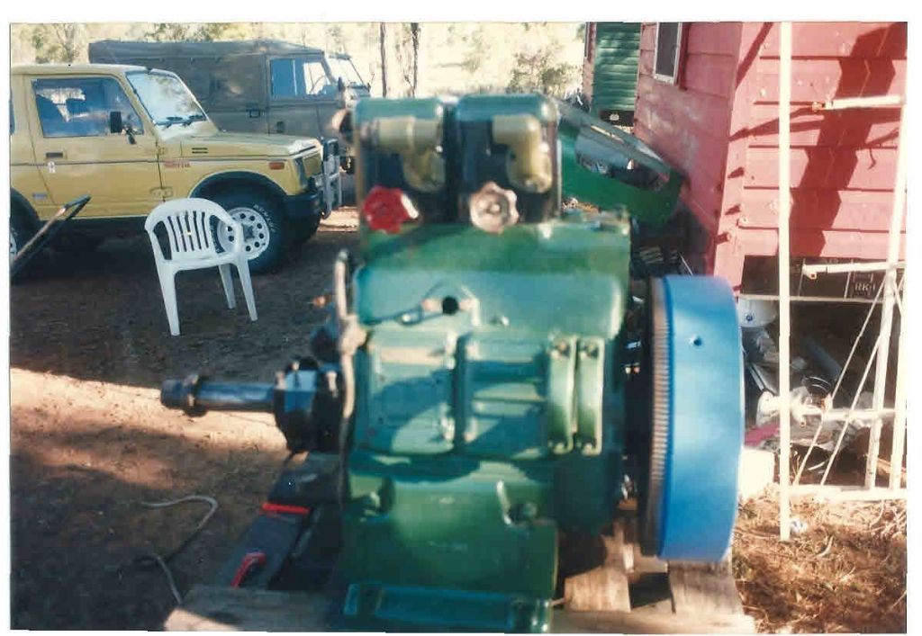

      Larry Coleman 1
        @larrycoleman1
        Lister twinLister twinWell here goes with the pic's
        Lister engine
        Edited By Larry Coleman 1 on 03/01/2015 01:02:37

        Larry Coleman 1
          @larrycoleman1
          The bottom picture is when it was pulled out of the river. The top two pic's were taken after sand blast & paint
          Larry

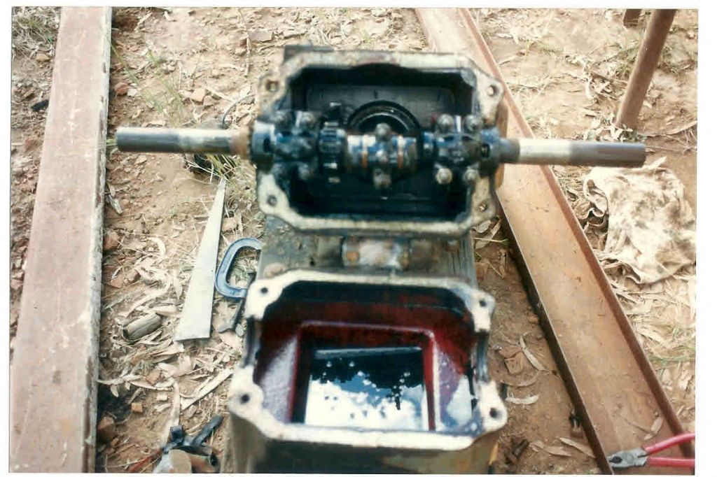

            Larry Coleman 1
              @larrycoleman1
              Bamford showing hinged crankcase

                  Ennech
                    @ennech
                    That certainly looks a great engine Larry, the one you unsunk!

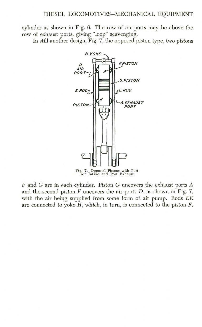

                                      #174611
                                      Larry Coleman 1
                                        @larrycoleman1
                                        Engine with single crank.

                                        John Olsen
                                          @johnolsen79199
                                          Hi Larry, Well, I haven't been to Rockhampton although I did have a good week at Airlie Beach last time I was over that way. I'm actually based in Auckland. My great grandfather did spend some time working at Mount Morgan before the Great War.
                                          I believe the Doxford marine engine used a similar setup to drive two opposing pistons in one cylinder.

                                          Larry Coleman 1
                                            @larrycoleman1
                                            Yes I was wondering where you were, so how is life in NZ from all I have seen on TV it is a beautiful country.
                                            That engine would of had two long con rods. I have never seen one and I think they would be a fitters nightmare.

                                            John Olsen
                                              @johnolsen79199
                                              I wouldn't want to be the one shoveling the coal for that little lot. They built some big plants back in the day. There is a nice detailed model of a Babcock and Wilcox engine at the local transport museum….I think it was a sales model. Not working, probably mostly wood but very detailed.
                                              The engines that use the two conrod idea are usually slow revving ones. The long rods must weigh a bit, which will not help balance. With a two stroke Diesel they should be mostly under tension, but you could not make them too light or they would start whipping about in the middle.
