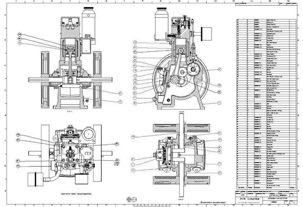

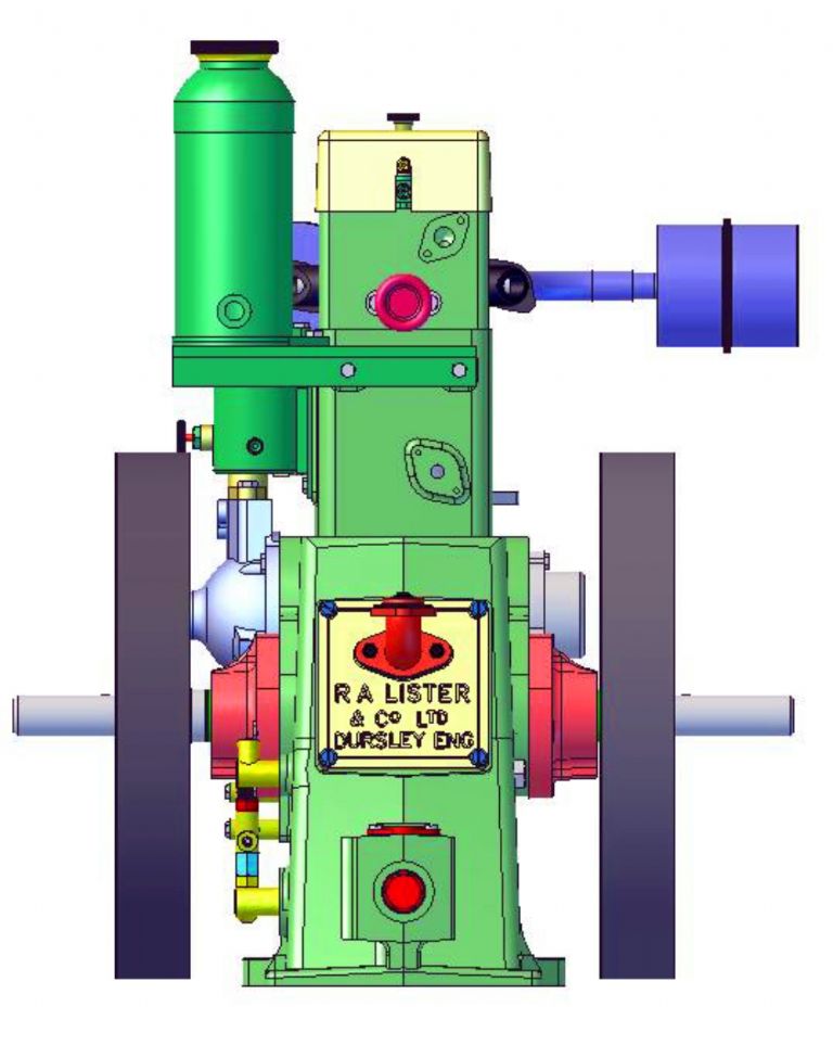

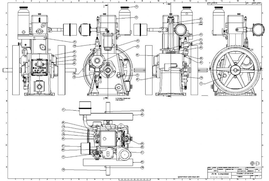

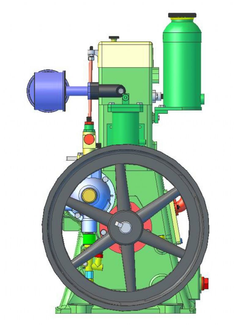

        assembly lister cs 1 (2).jpgFinally got around to completiong the drawingsassembly lister cs  8.jpgassembly lister cs 9.jpg

          I finally completed all the details and parts list.
